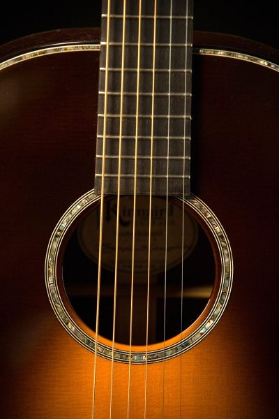

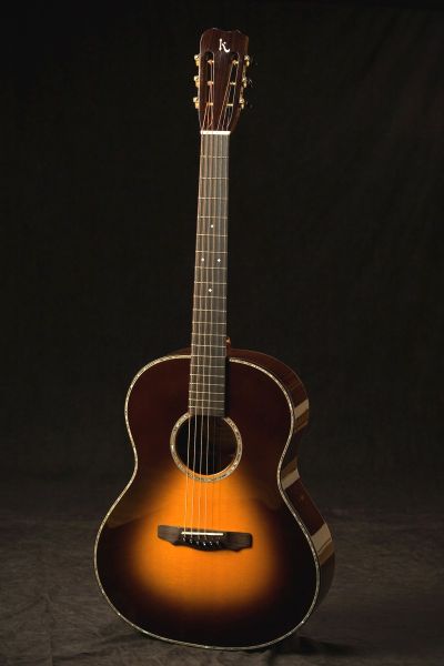

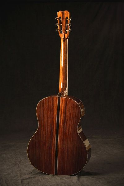

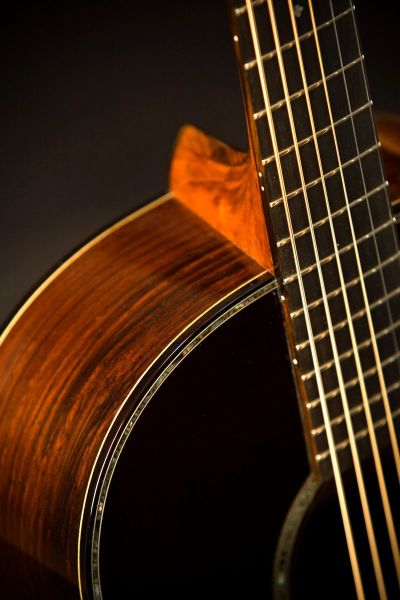

G'day, mates, here's a recent guitar that you might enjoy viewing.
The back/sides are Cocobolo, the top is Engelmann spruce.
Center lam in the mahognay neck is also Cocobolo.
Bindings are dark Brazilian rosewood, bridge is African blackwood.
Green heart ab. for purflings and rosette.
Sunburst was done at Colin's insistence!
Here 'tis:

Aint that pretty! I like haw the abalone is offset against the burst, really pretty!

Yeah, Bob, I'm a Gibson burst kinda guy too.
In fact, I sent the body off to Tony w/ a Gibson poster enclosed, showing the very burst I wanted. He done good!
Martin, it almost broke (burst?) my heart to do this top this way.
It was almost snow white, and really pretty.
But while prepping the top w/ final sanding, this sap pocket comes up outta nowhere, w/ no warning. Really glaring against the light top.
So we decided to hide it in a burst.
However, when it came back from Tony, I thought that I may have to do more of these. There is a richness about it that I find appealing.

I'd not thought about doing a dark burst like that to hide a flaw in a top. It's a terrific fix, and I think makes this instrument look better than with a snow white top. The pearl really comes to life against the dark background.

Beautiful guitar Stephen. Thanks for posting the pics. How do you find the Cocobolo for tone? The sunburst sure looks very classy.

Allen, you're right...a burst makes abalone just pop. And if you ever wondered what the factories do with tops that are less than perfect, well now you know one reason why there are so many bursts out there!

Alan, I've found Cocobolo to rival Brazilian. It's heavier, and oilier, but besides those factors it's just dynamite for tone. This guitar sounds wonderful, and though the top is the main contributor, the Cocobolo is kicking in something magical.

Steve, I showed Fran this thread and she agree. The burst was very nicely handled. She was able to peg why it didn't bother me. "Oh, I like that one. It doesn't have any of that nasty orange in it. It makes the rosette stand out without getting into your face."
