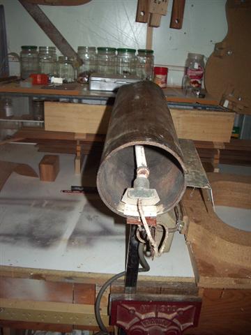

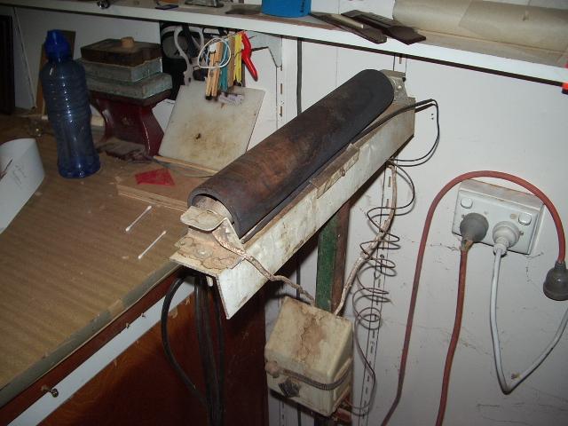

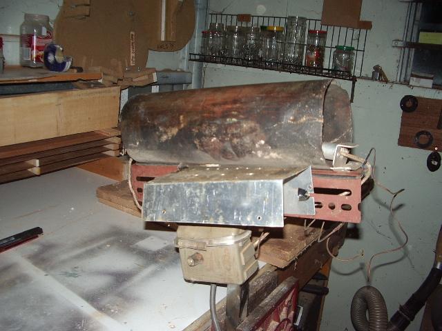

If you can't buy one, heres some pictures of two of mine, easy to make if you get the parts. I've had these for over 30 years and they work fine.
The pipe is whatever I could get, one is brass or bronze pipe ?? about 5mm thick the other is also brass but poss 2.5 mm thick. Both have a 1000watt radiator element in them held with the porcelain heater fittings. They are both wired through a variable oven thermostat control.
Oh, the safety features were removed for clarity....... do you believe that, you have to be carefull with this model.

My grandaughter used these to bend her dulcimer and mandolin sides, when she was 10 and I honestly did not consider them dangerous. When they are on there hot, a good reason not to touch anything other than wood.
