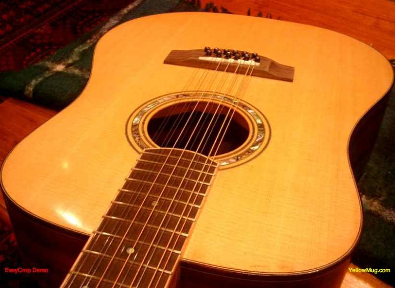

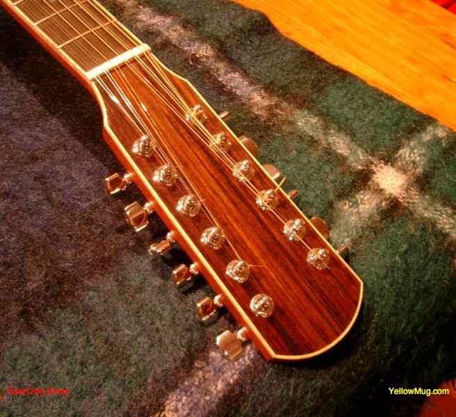

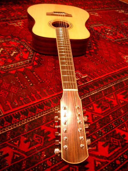

Okay I finally got this sucker finished....saddle got done yesterday and Kims MOP/ebony bridge pins went in and I tuned her up. She sounds nice...loud but balanced..same as the last 6 string I built.
Pics arent the best..the camera's crap.

Post by Dave White » Sun Sep 28, 2008 10:11 pm
Martin,
Nice one - that was an interesting journey but you got there in the end. The guitar looks great and I bet it sounds sweet - sounclips please :D
