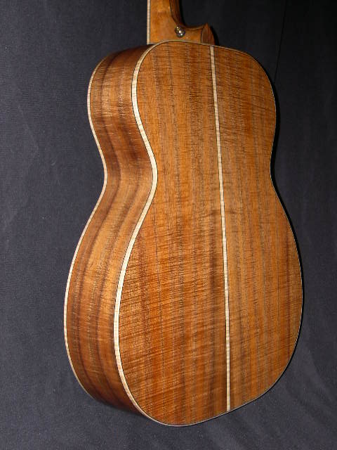

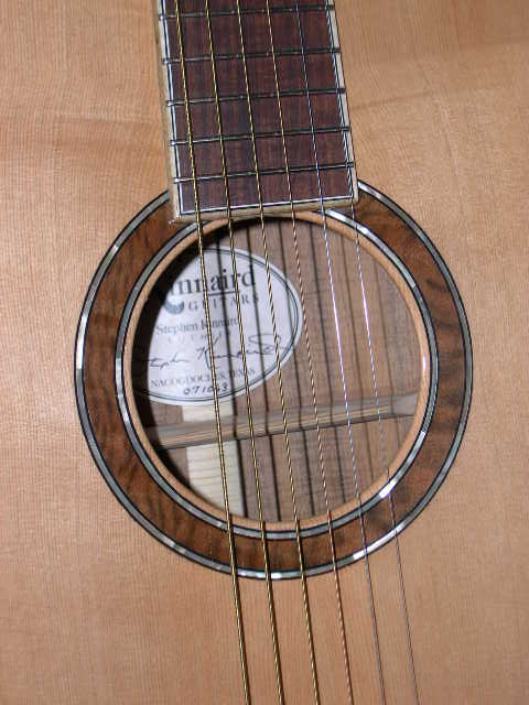

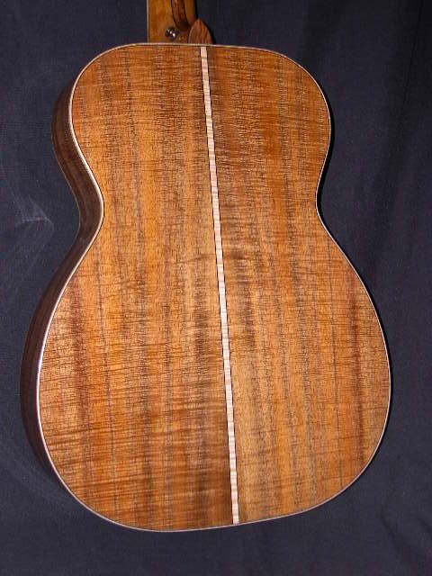

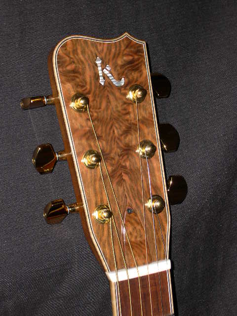

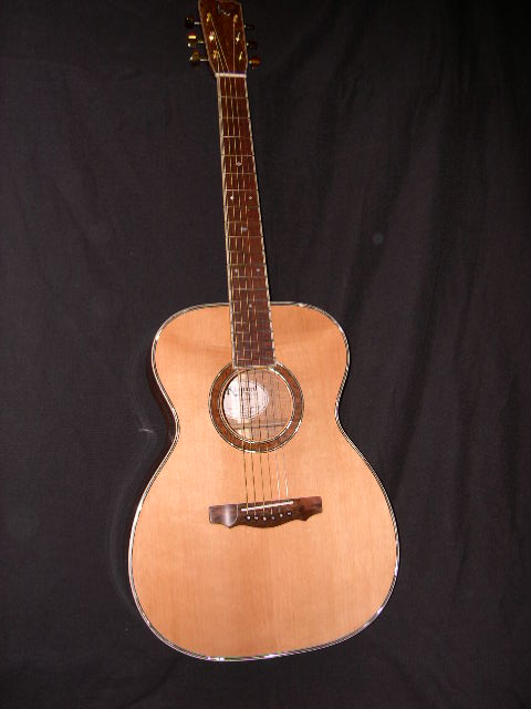

...and:
And the Mulga fretboard-- I love this stuff:
Thanks for watching along, everyone, and many thanks for the encouragement along the way.
Re: KB Pine/Blackwood OOO
What a beauty!
It was not until now on the finished guitar pictures that I have seen the tiger face on the headstock. Actually there are several tiger faces present. No wonder tiger myrtle is called tiger myrtle...

Nice to see that it's opening up nicely Steve.
I've built half a dozen KB topped guitars now and they all seem to do this around the 6 month mark.
Give it another 12 months and you will also notice some nice development of tone.
Happens a bit quicker than an Adi top.
