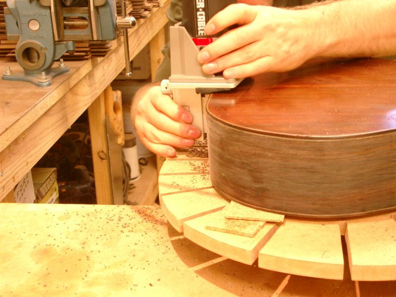

Ive got the Steamac Dremel router base and binding attachment but have never used it. I used the rosette cutting jig once and made a hash job of it...router attachment screws kept working loose halfway through the cut and the rosette jig has too much flex in it for my liking.
One trick with the jigs is to do your cuts as a number of passes and to work fairly fast but smoothly as you work the jig around the guitar. Position yourself so you dont have to stop and reposition yourself halfway through a cut. Also see Stewmac's catalogue for instruction on direction to make intial cuts to minimise tear out.
Cheers Martin

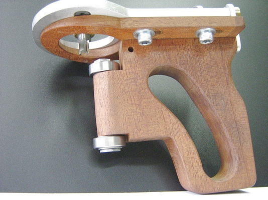

Heres a pic og my Luthier Tools binding channel cutting jig. Im actually using it to cut out some old binding off a classical but the way it works is the same. The lam trimmer is a Porter Cable 301 and the cutter is a double flute straight cutter. Thumb screws on the jig allow adjustment of the depth and width (large knob in pic) of the channel. I always test cut on a piece of scrap before attcking the guitar. The guide show is angled to follow arched top of guitar and there are two bearings that register on side of the guitar. Its important to makie sure that there arent any bumps on the sides for obvious reasons.
Cheers Martin

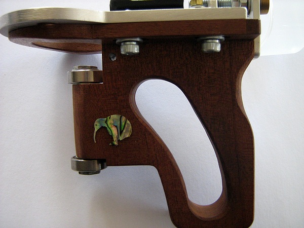

My jig
Kiwi Luthier Paddy Burgin using his jig made using plans in Jim Williams book. Does the same job for less loot. Note white pencil marks on back of guitar noting cut direction...this is to minimise tear out.
Cheers Martin
My jig

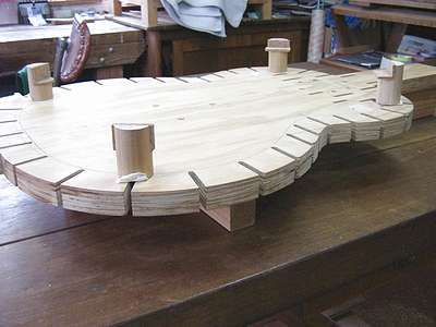

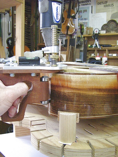

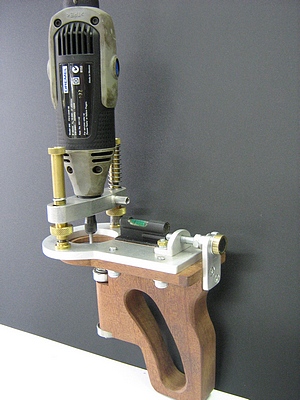

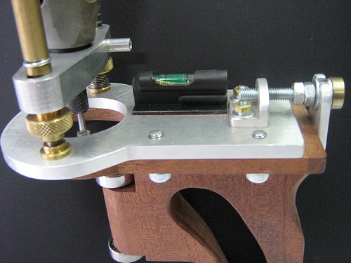

I'll have to beg to differ regarding the Dremmel for binding channels. I made this set up which works flawlessly in two passes. I have no variance in channel depth and width ( And absolutley NO gaps !) I have the Stewmac Dremmel router base to hold the machine , which is screwed on to my device as you can see . The jig allows micro adjustment for depth and width of cut. I swap bits to a spiral downcut for the purfling channell ( Shellac the edge of the soundboard first for a very clean ledge with no burr ) Also cut your ledges in the right order to avoid any tearout. ( see Stewmac's routing direction guide on their site )
You'll note there is a donut type base ( angled at the front ) to register against the top and back plates . The donut's front angle allows for the radius of the soundboard and back plates to not raise the router above your desired depth of cut.
This Solera arrangement holds the guitar body solidly ,yet allows the jig's bearings to register against the side of the guitar

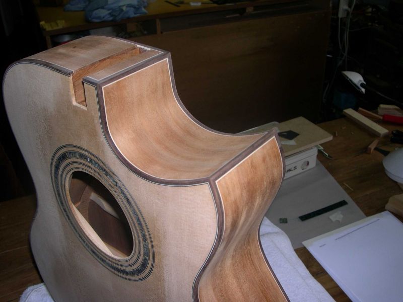

My cutaway and bindings here were done on the pipe , and the binding and purfling ledges done with my Dremmel Jig

Craig....mate, you gotta start selling those jigs. Mine are just so rough and ready that now I'm to ashamed.

Nice jig Craig......but imagine how it would look with a nice Porter Cable lam trimmer sitting in it.

Ive just noticed your neat way of mounting the body in your workboard for the binding channel cutting job. Why the hell didnt I think of that?
Cheers Martin
Cheers Martin

kiwigeo wrote:Nice jig Craig......but imagine how it would look with a nice Porter Cable lam trimmer sitting in it.
Cheers Martin
Martin , I have a Makita Lam trimmer . Using a machine of that size tends to make this type of unit top heavy. I have found more than enough power with my dremmel , but I take it very slowly with a couple of passes. Maybe my dremmel was made on a good day as it has zero run out , and the bearings are still perfect . I won't be changing any time soon as it works so well.

I enjoy making jigs to use ,and am always thrilled when they work so well. Yeah , I know I make an over the top neat job on them to the point of obsessiveness, but I do it for a good reason .They work better,,,,, and kind of set a higher standard for the operation ahead. A better end result me thinks .At least that's how my crazy obsessive mind works. I won't be turning jigs out for sale any time soon Allen as they take me so long to make and I'd sooner be making guitars. I keep thinking I've made all the jigs that I'll be needing , when yet another crops up . We're all in the same boat here Huh guys ? There's always another jig to make !
I'm in the middle of making a well needed Trojy type body clamp at the moment. It will make the job of building guitars just that much easier , and whilst making it , I'm thinking of my next move on the instruments I have under construction. Gives me a bit of time to think ahead and form greater ideas for them.
