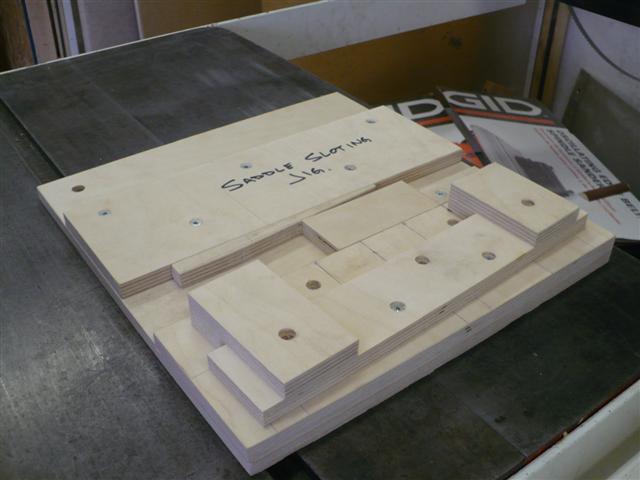

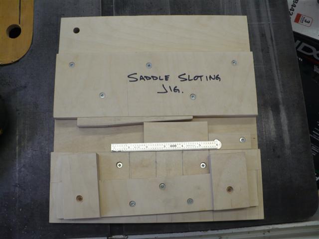

Grant I slot my bridges before gluing it to the body.
Here's a couple pictures of my jig
I use the wedge to secure the bridge in place. I turn my router on, lean one corner into the stoped edges (lower left) lower the router into the bridge till it's sitting on the jig, then I just route the slot.
I don't believe that it's more accurate to route the slot on the bridge after gluing to the body. It's all just about measuring properly. And if you're able to make some locator jigs, it can be faster to attach a fully finished bridge and go right to fine tuning the saddle instead of messing around with an intonator and jig to possibly scuff up a nicly buffed body.
Oh, and all my jigs are glued together with Fish glue which gives them better transfer of energy vs titebond or other PVA or AR glues

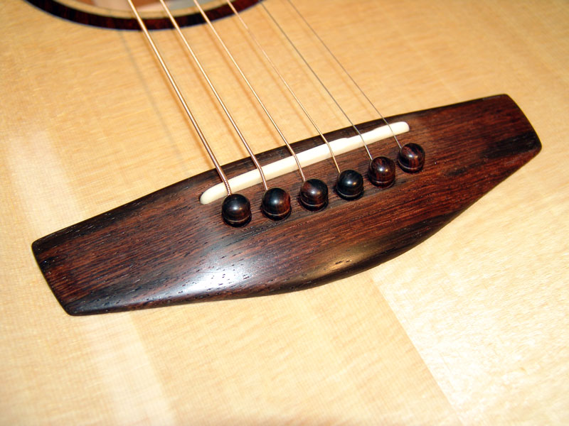

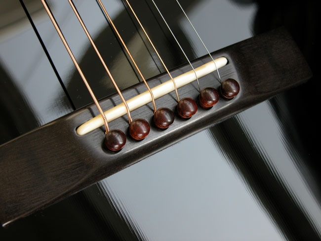

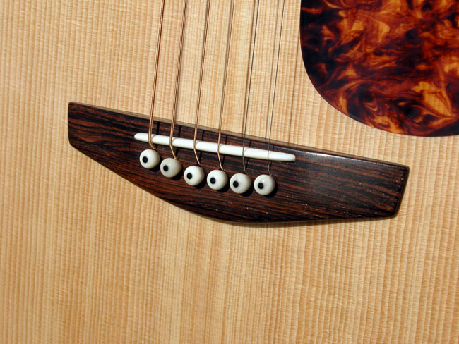

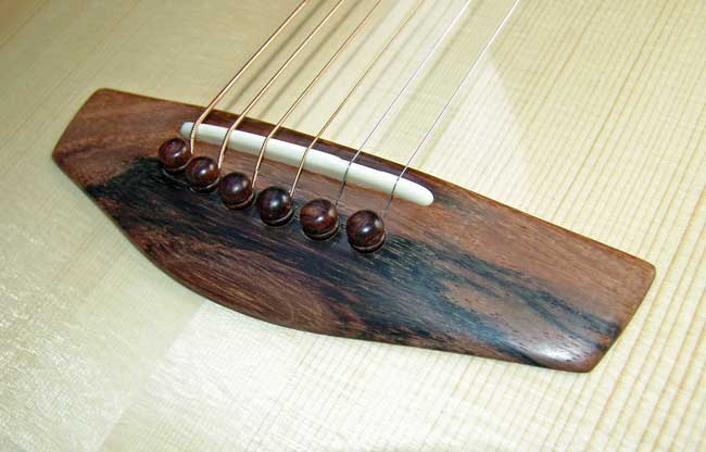

If when you position a pre-slotted saddle by referencing the saddle at the proper position great intonation is completely possible without routing the saddle slot after the bridge is installed. I have never done it any other way.
I agree though that routing the slot after the bridge is installed, and installed in the correct location, is a sure bet provided that the extra risk of this operation does not bite you.
I also prefer a 1/8" wide saddle just in case I need a bit more adjustment.
Here are some examples and if you look close you can see that where my intonation needed to be was well within the range of saddle crowning adjustment available to me. All these bridges where glued on with pre-routed saddles slots. BTW only one of these bridges was a CNC copy of an original design - can you guess which one?
Lovely looking bridges Hesh...I can't pick the CNC one.
