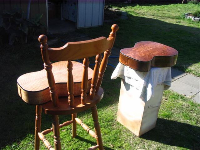

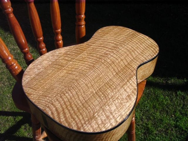

That guitars gonna look terrific when the finish is applied, it looks great now. I'm amazed at the timbers you guys find and use, I thought that tone wood was limited to the popular few. I've been given a few odd peices over the years I'm goning to have to dig it out and have another look.
Good stuff Bob.
Good stuff Bob.

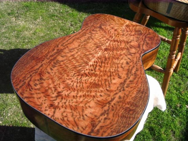

Bob, that Tiger is gorgeous! WHO do you have to know to get wood that nice???
Also, I see that now I'm a Kea. Dare I ask what that is?

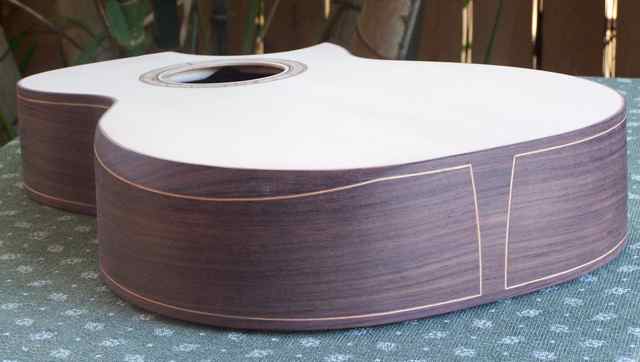

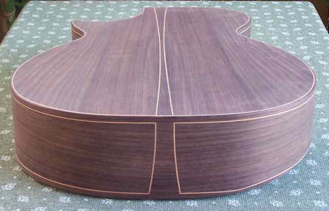

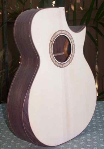

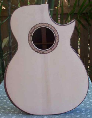

I managed to get the OM bound and sanded out and the first pore filling session done after I took a few pikkies. So here they are.
I went for Hesh's stealth bindings. just to try something else that was new on this one. Well, to tell the truth, it was the only wood that I had kicking around that I was going to be able to get a piece large enough for the armrest from what was in stock.
The first cutaway that I did was a real pain. This one turned out to be far more easy to do. It's still a heap more work to do a Florentine cutaway, but I love the look of them.
The arm rest was actually fairly easy to do, once I got my head around how I was going to tackle it. Yes, it's a heap of work to do as well, but again, I really love the look.

Steve - I travel to Tasmania a couple of times a year to visit various sawmillers on the North West and West Coasts to source timber.Stephen Kinnaird wrote:Hey A.P., thanks M8. (At least I hope I'm the Stephen to whom you are referring!) Actually, I thought it was the back inlay that continued onto the butt... but that's splitting purfling lines, isn't it?
Bob, that Tiger is gorgeous! WHO do you have to know to get wood that nice???![]()
I can tell you it's the luck of the draw on what's available. On the last trip I spent only a third of the budget I had allocated simply because the quality wasn't there.
I buy most of it green and season it myself and Myrtle is quite a cantankerous wood so the yield is not great from it.
In fact I've got half a dozen sets that were cut from a billet that already had a crack in it and I've got the fingers crossed it isn't going to spread into the useable area of the back.
Myrtle of that quality is not the norm and when I bought that billet the sawmiller remarked that it was about as good as it gets.
Still theres all sorts of different patterns in the Tiger and some people will prefer different things.
I have seen some Tiger stumpwood with unbelievable figure and curl in it. Not big enough for guitars and probably too unstable but insane looking wood
A Kea is a New Zealand bird.

Allen, I really, no really like what you've done there.
I was thinking of a tail wedge like yours, and you're going to push me
over the edge to do one like it. Nice work!
Dennis, fine looking stuff there bud. I'm looking forward to seeing the soundhole scraped clean. Should be fantastic.
resourceful to go get your own... I may have to come down sometime.)
Gee, thanks guys. Kind of humbling to have such high praise from 2 really fine builders.
Steve, the curved end graft has turned into a bit of a feature on my guitars I suppose. This is my 9th guitar, and I think I've only built one without that style of end graft.
I really do like Bob's latest though. I might give one of those a go some time soon.

Masochist.Allen wrote:Gee, thanks guys. Kind of humbling to have such high praise from 2 really fine builders.
I got the idea from Howard Klepper who has done one with a mitred rectangle that does not connect with the bindings. It also looks great but there's only 4 mitres to do - not 12.

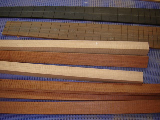

Here are some of the sticks I cut up for the laminated neck. The light wood is curly Marri and the the other is curly Jarrah. The neck will be Marri, Jarrah Marri. The fretboards are are for my RG seven string and a my thunderbird bass.
The last thing i did today was cut and glue up the scarf joints on two necks, One for my seven string electrtic and one for my bass. There are various other project scattered around my workshop.

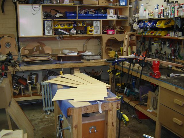

Thanks Steve,
It sure is chaos but it is also organised. I have 7 guitars at various stages jammed into my little corner. You can probably count them all in the photo.
The organised bit comes because I have worked out places for all my tools and I always put them back in the same spot. And I read in a woodworking book a thing called the rule of 10. That is, you must put away 10 things everytime you come into the shop. Works for me but it has to be more like 20 things.
I will start a new thread for the bitsa guitar. Thanks for the interest.

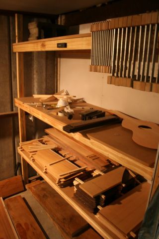

Thought I'd share the (nearly) end result of my recent work...
Shelving has always been a problem for me, as there's only so much you can use the $20 steel shelves from Bunnings/Mitre 10 for, especially with oversized tonewood. One main priority for my new humidity controlled workshop was nice BIG shelves. 3 600x1800mm (2'x6') shelves takes care of that problem. My current small stash only takes up about 1/4 of one shelf so with storage space taken care of, the WAS has no excuse. I'm also thinking of putting a gobar deck on the second shelf to free up bench space.

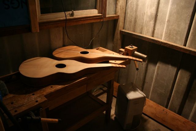

Small bench in place until I get around to buying or building a larger one.
Quite pleased that everything's working nicely. With the dehumidifier on and the door closed it's hovering nicely on about 48% compared with 72% outside, so I'm looking forward to a lot more building time.
