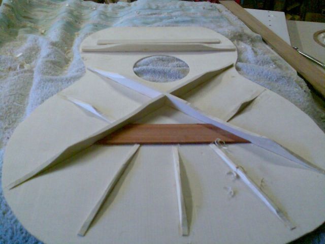

I got some pictures off my phone of the bracing Allen.
Stolen unashamedley from Kim Hickey, in fact he suggested it.
The braces ended up much, much smaller than you see in the photo.

How did you decide on how to voice the top? Just keep shaving spruce until you were afraid to take any more off?
Post by Bob Connor » Mon Jul 07, 2008 5:15 pm
Just flex and tap.
Listening for sustain in the tap tone over the lower bout.
