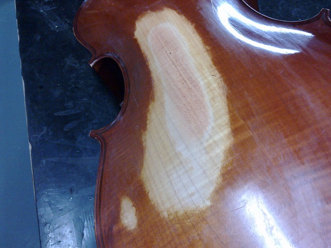

Well, the customer finally gave me the go ahead yesterday.
So I removed the crap finish and look no sealer used, it also looks like they used a filler on the crack, the stain has soaked all the way through. Man I hate fixing stuff ups...
Told the customer I cant fix the crack any better unless I chisel the damage out and splice a new piece in, hopefully they will reply monday and I can get it out of the shop on tuesday

Wow,,,, tight grain on that back too Steve :o :o :o

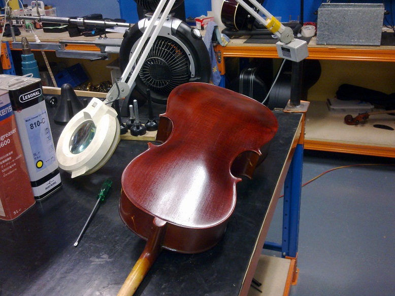

Going...... going....... gone
Just a little bit darker to cover the blend

Post by Kim » Mon Jul 11, 2011 9:31 pm
The match came up very well considering Steve, well done. 8)
Re: How bad can a refinish touch up be
Post by simso » Mon Jul 11, 2011 9:49 pm
Its okay....
I matched the colour with the sides, the back was a bit lighter, I personally would have liked to have sealed sanded / seal scrape / seal sand and then put the finish on, then wet sand and apply another coat, but the customer was not willing to pay for this. So it was more of a case sel once only sand and lacquer and put it out the door

Post by charangohabsburg » Mon Jul 11, 2011 9:57 pm
Well done Steve! The most important thing is to make the customer happy which I am sure he is now. 8)
Post by rocket » Mon Jul 11, 2011 10:05 pm
That's a job well done Steve, congrats'

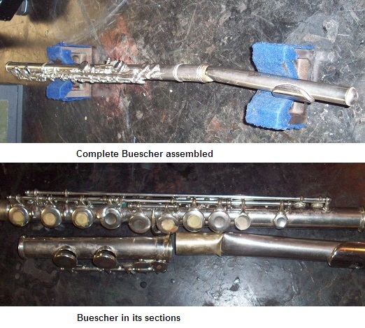

We always seem to get the bad stuff in
Another bent flute

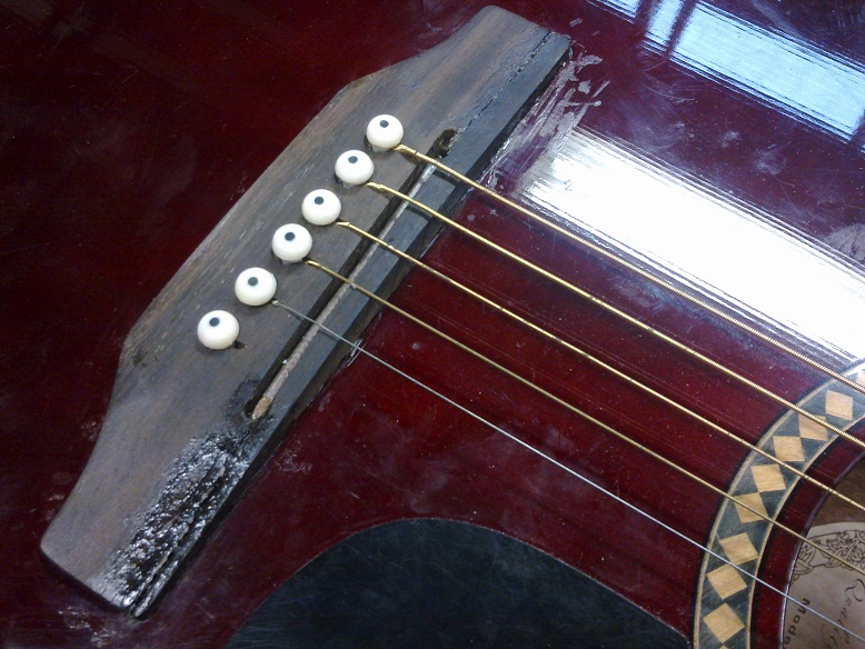

A lovely home repaired bridge

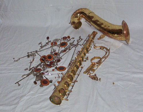

And a sax, that a kids dad decided he could repair, they gave this to us in a cardboard box and said can you put it back together and make it work...Geee thanks for trying, and this is just an average day

We always seem to get the bad PuffnStuff ....Another bent flute
:lol:

Well... :roll: What's wrong with this? I thought that's how saxophones do look like, don't they? Nothing to assemble there. Just glue it as is onto a white particleboard, and presto! Another piece of art to hang on the wall!
Seriously, that sax looks really good because this is just too hilarious. I think I even had to laugh if I would be the one asked to put it together :lol: . However, the flute would make me angry. There are things in this world I just don't understand. :?

simso wrote:We always seem to get the bad stuff in
Another bent flute
What happens at band camp stays at band camp.

Steve ,, the thing about the sax job is that although your customer will probably go away very happy with your work and the sax will go on to play many a sweet tune, with what you've been given to work with the instrument can only be improved, hey?

Very good point, they cant get any worse,
