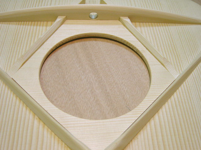

I ask because my most recent project has forced me to really think about this and since doing so I certainly do see a very valid use for CF in the upper transverse brace, probably even more valid there IMO than in the neck.
To explain so everyone will hopefully understand my point, I offer the following.
We all know that with the passage of time it is common for a steel string bridge to roll as a direct result of the compressive force that you mentioned above.
In order for this 'roll' to take place, the soundboard behind the bridge must also rise or 'bellie' upward as a result of 'tensile' force and with rotation, that area in front of the bridge, between it and the soundhole, must concave or bellie downward as a result of compressive force with the whole process resulting in the formation of a cross sectional horizontal "S" shape being formed when viewing the bridge and top from the side across the top's surface.
As this rotation takes place, the action, or distance between the stings and the fretboard begins to rises and so too does the relevance of Dennis's analogy with the long bow. The wood at the back of the bridge can only offer so much movement before it resist the tensile force of the strings. At this point, the glue joint at the bridge will either let go, or the compressional force now applying increased 'leverage' at the neck joint will force the neck to rise and continue to magnify the problem.
With each rise, more force is given over to pulling the headstock 'up' to meet the bridge and less is available to pulling the neck 'in' toward the neck block as one would expect in a newly set up guitar. This results in more and more pressure being placed upon the neck block and upper transverse brace as these components become a fulcrum point with the neck the lever.
The more the guitar folds with this rotation around the neck block, the more quickly it will continue to fold as the soundboard either side of the fretboard extension eventually break free and allow the neck block to rotate back into the guitar body completing the failure with the collapse of the upper transverse brace.
Like most of us, I look at the guitar as a complete unit. The initial failure back at the bridge can be addressed somewhat IMO by correctly bracing to counteract the torque to limit the 'rolling' of the bridge in the first instance. In my right brained way this includes a doubling up of the top thickness around the soundhole by laying in a plate of apposing grain spruce to be bordered by the "A" frame soundhole braces the front intersection of the "X" brace and the rear edge of the UTB and with my current thinking, this area now becomes a prime candidate for 45 deg CF instead of the spruce or may be in conjunction with it.
(I will now be moving to truss rod access at the headstock so please ignore the big hole in the transverse.)
Anyhow, I also think stiffening up the sides as per Rick Turner CF reinforced linings will help prevent the neck block rotation issue as would flying buttress CF tubes running from the neck block back to the waist as installed by the brilliant Dave White, and to complete the system and insert the point of my long winded post, so too would a super strength upper transverse brace that had been laid up with CF.
I feel that if you get things right here, your covered structurally and this frees you up to brace much lighter at the lower bout where it counts. My2c. However, as with all things I remain open and am enjoying the education this topic has provided.
Cheers all.

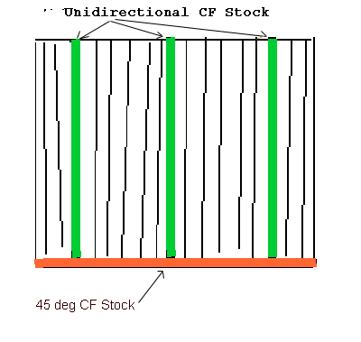

Kim,
The 45deg stuff would be good for bridgeplates to resist splitting across the grain and distribulte load in both directions.
In terms of your diagram,for the UTB I would skip the vertical laminations and cap the brace with unidirectional CF not 45 degree.
I like the gentle curve of the UTB shown in your photo and if you carry that curve all the way to the linings and cap it with CF all the way (not scalloping the ends) you will have a very strong brace indeed.
I would not be worried about the hole in the centre of the brace, you have plenty of "meat" below it.
IMHO the main factor in avoiding dipping at the soundhole is capping the x brace intersection properly rather than with a bit of muslin like CF Martin.(as well as adequate brace height and avoiding cutting away too much in shaping)
IMHO you have already taken the main step to avoiding neck block rotation by using the A brace to the neck block. Adding flying buttresses etc is only doubling up on this and attempting to transfer load to the sides(from where it has to then be transferred back to the top and across to the bridge)
I am not convinced that it is necessary or desirable to try to transfer loads out of the top, but you do need to distribute them to the areas beside the soundhole and the A bracing does that
I remain unconvinced about the benefits of CF capped linings, I look at it this way- the top is an extremely effective brace for the sides (and vice versa)

2.) Brace reinforcement. The only guitar I've built so far has suspended bracing from neck block to tail block, and there is really only one brace on the soundboard holding the arch/radius of the top. I have a single lateral brace running across the guitar right beneath the saddle. The concept is that this brace is a fulcrum, allowing the bridge to rock longitudinally. Based on the success of that guitar, I'm continuing to experiment along that pathway.
The idea with using CF laminated into this "pivot brace", is to create a thin brace that will hold the radius machined into it, permanently. Whereas most guitars have several radiused braces assisting in the task of maintaining the top's radius, if my one brace relaxes a bit after a few years, I could lose most of the top's arch. I suspect that you'd recommend a capped brace (capped with CF) or some variant of I-beam construction, but I am hoping to simplify the process and just laminate a thin sheet of CF between spruce for this brace. Is that simple, laminated concept going to achieve the goal (of remaining as it's machined arch) or do I have to look at capping the brace to achieve it?
It seems that many bridgeplates fail by cracking along the line of the bridgepin holes. the crosslaminations of the 45deg cf would resist this, and have equal resistance to bending in both directions.
I don't do this myself but only suggested that David's method appeared to have merit.
Once again I am sure your advice has great merit but I have no understanding of 'why' you have suggested this.jeffhigh wrote: In terms of your diagram,for the UTB I would skip the vertical laminations and cap the brace with unidirectional CF not 45 degree.
A material like CF had its greatest strength in the direction of the fibres.
where you are using it in tension(as in the cap of a beam) you want the fibres in line to resist this tension.
The vertical laminations are an inefficient use of the CF because when it is acting as a beam(as you are wanting it to resist inwards force) only the extreme fibres at the bottom are in tension and with the narrow width this is not very effective.

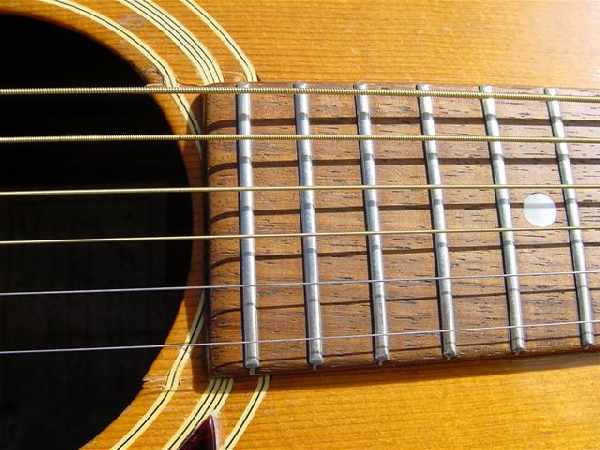

Here is one I done, the distortion of the rosette clearly shows how much the top around the fretboard extension has moved after cracking, the X and capping on this particular guitar was just fine.
Granted, but my experience fixing those that have failed has clearly demonstrated to me that the top to side relationship is not an effective enough brace to be relied upon to avoid rotation over the long term for many steel string acoustic guitars. This is why I would like to know more about which CF product should be use in what application. But more importantly, I would like to understand 'why' one is more effective than the other so it adds another quiver to the quill as I continue to work my way through the craft.jeffhigh wrote: I remain unconvinced about the benefits of CF capped linings, I look at it this way- the top is an extremely effective brace for the sides (and vice versa)
Kim, I have far less experience at repair than you, but in analysing a failure it is important to see why failure has occurred.
Long term movement is one thing, catastrophic failure is another,
In the photo you have shown, I would be 99% sure that it has failed due to overheating and glue failure of the joint between the utb and the top.
One thing I will be doing in the future is to laminate CF sheet stock between the top and the soundhole patch. If it can work back at the bridge plate, I reckon it will be equally effective around the soundhole which is and area I consider to be the weakest link in the traditionally 'X' braced top. Add some CF and overlay with a veneer of cheesewood and you have a neat purfling on the inside edge of the soundhole, chique.![]()
I agree the soundhole is the major problem. Transferring forces out around it and then back to the bridge is unfortunately necessary.
