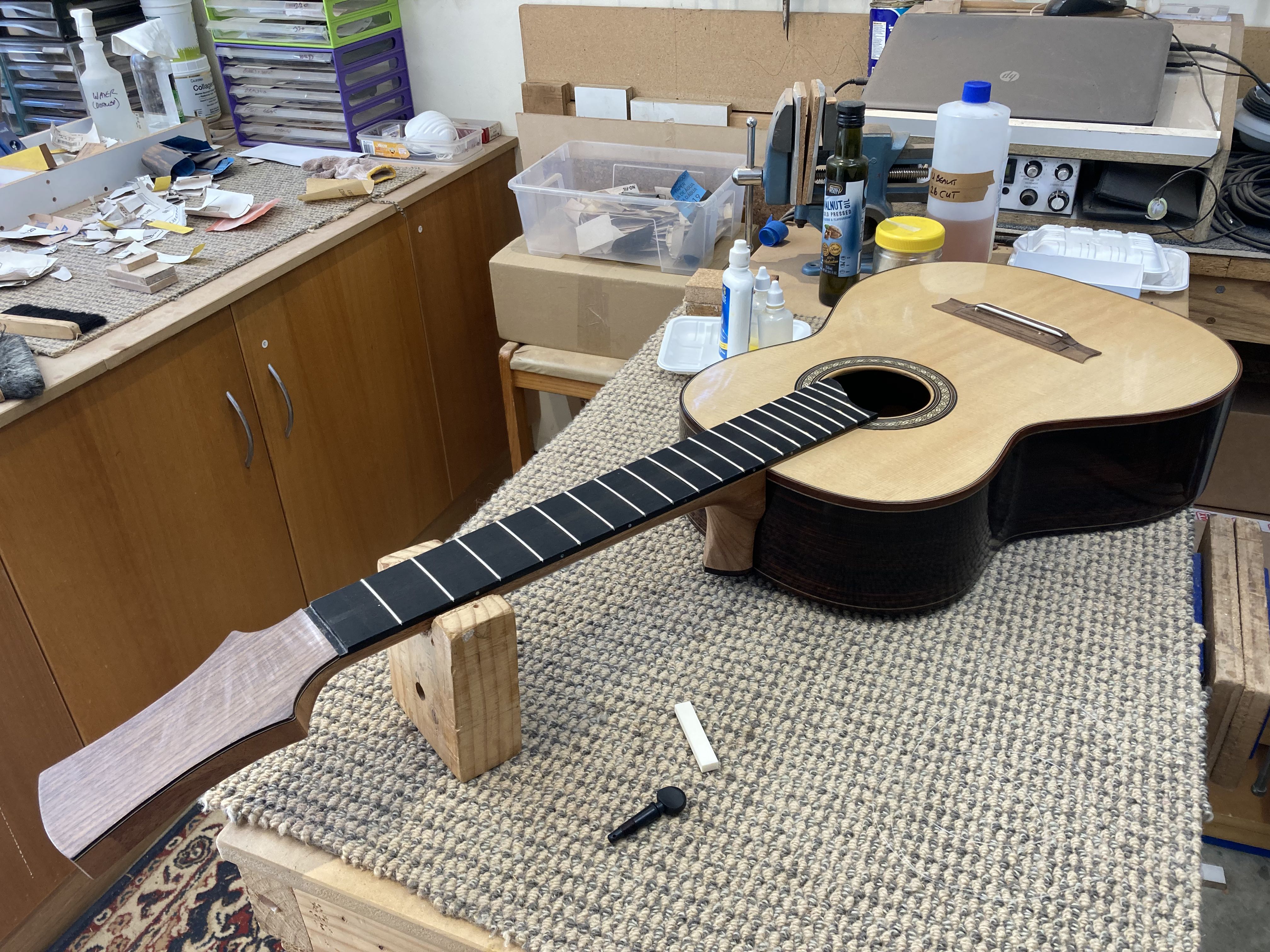

Post by kiwigeo » Fri Apr 15, 2022 6:44 pm
Domestic chores of late have kept me away from the workshop. During the odd hours Ive managed to assign to my building Ive managed to get the french polishing finished on the the neo classical. Once the hard shellac has fully cured the bridge will go on and planetary pegs will get installed. The headstock looks a bit rough....a few pores still showing so have had to do a bit more pore filling on same.

That's going to look nice Martin.
Indian Rosewood? BOBO? Falcate?
Who did you buy your pegs from? I love the idea but they are so expensive.
Cheers Dave

Post by kiwigeo » Sat Apr 16, 2022 10:05 am
Specs:
Back and sides: Indian Rosewood
Top: Lutz spruce
Neck: Queensland Maple
Bracing: falcate
Neck/body join: Bolt on bolt down.
Tuning pegs: Perfection Pegs https://perfectionpegs.twofold.com.au/
Dave M wrote:
Sat Apr 16, 2022 1:23 am
Cheers Dave

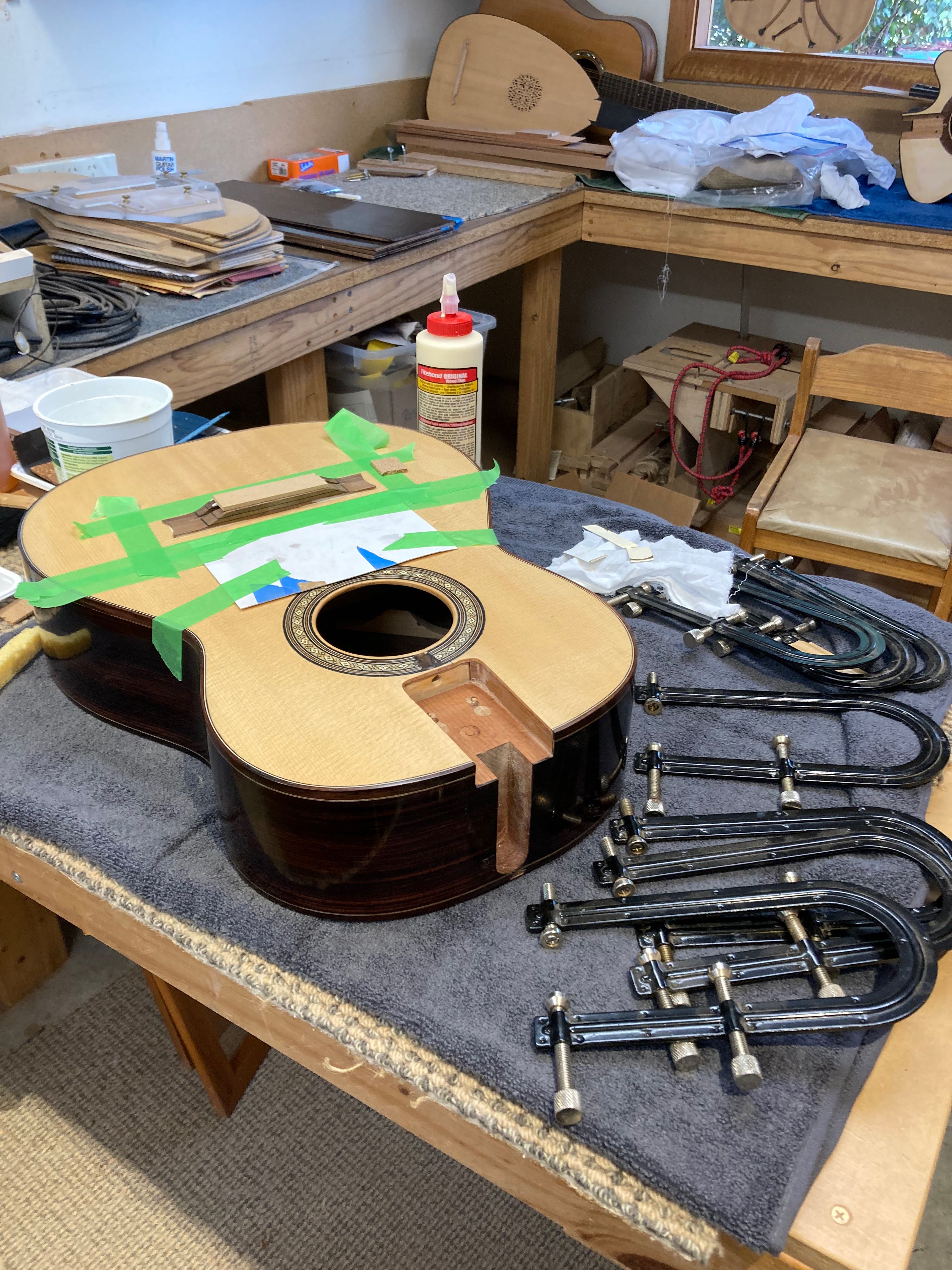

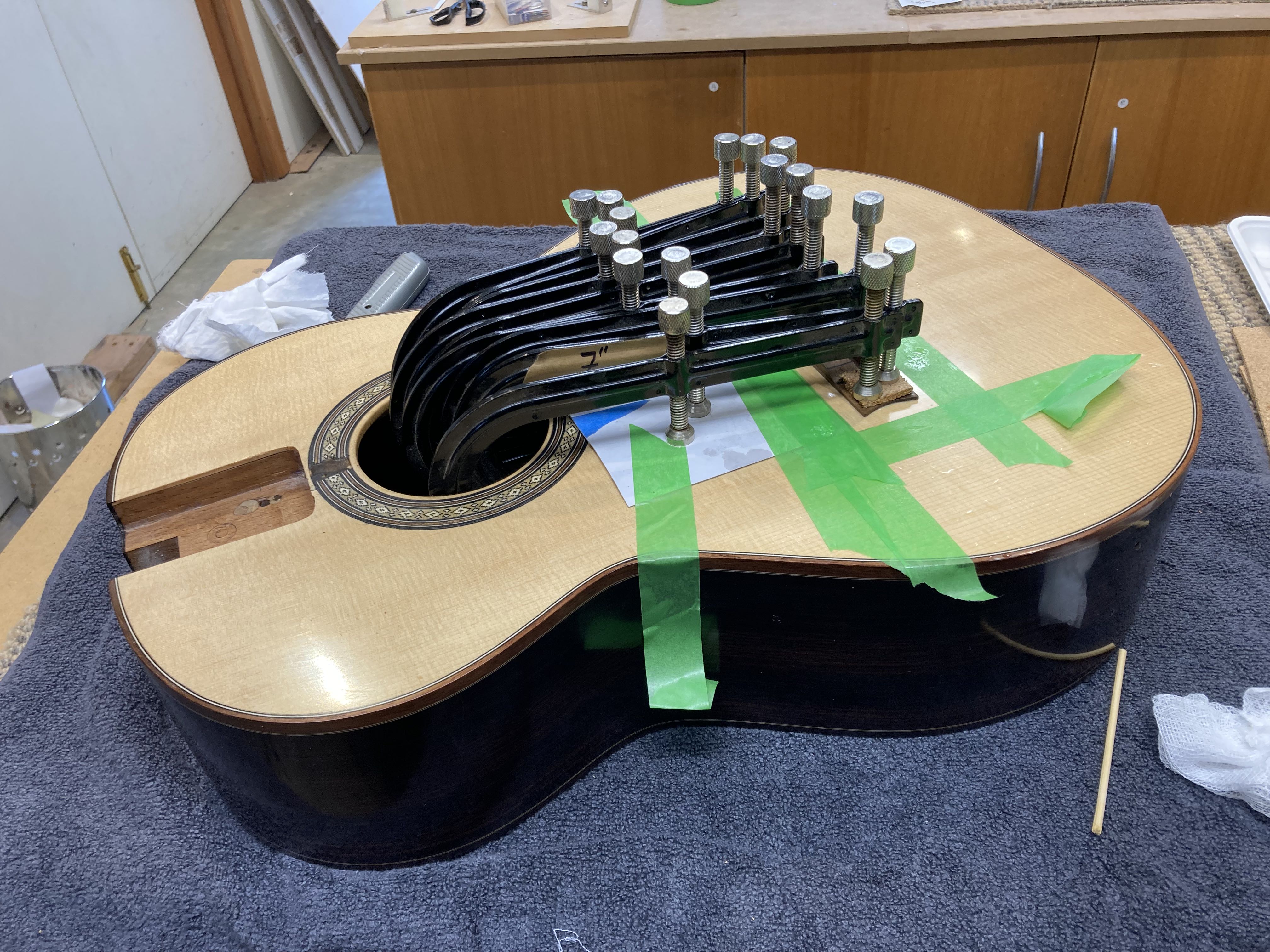

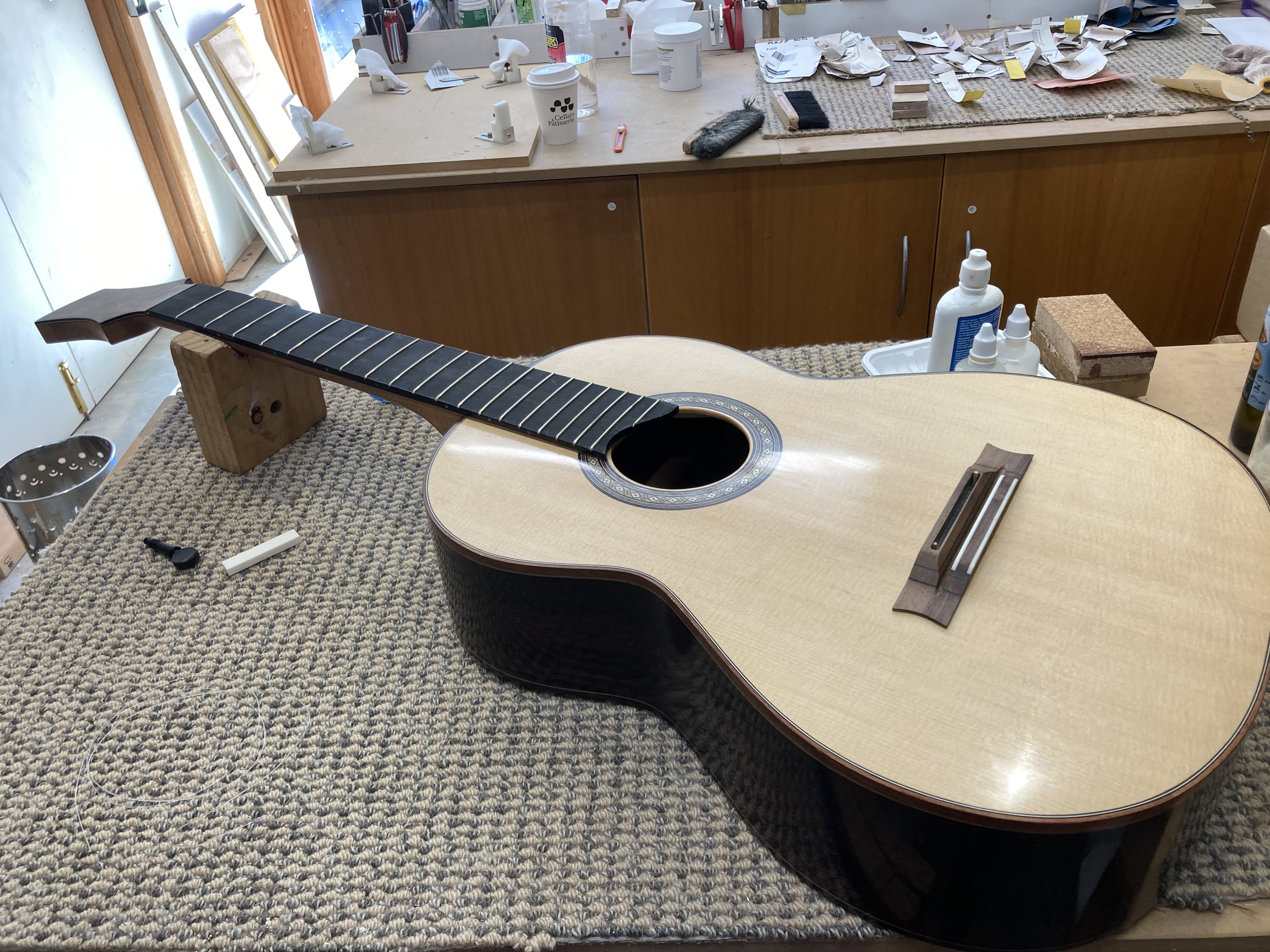

Post by kiwigeo » Thu Apr 21, 2022 12:28 pm
Bridge finally glued on. The original bridge failed on this guitar and I ended up having to replace the top. I manage to jam 9 clamps through the soundhole. After the photos were taken I managed to squeeze one more clamp in to make it an even 10 :mrgreen:

Post by WJ Guitars » Thu Apr 21, 2022 1:54 pm
That's a lot of clamps Martin. Should be a full life time bridge glue job. Great work!

Post by Mark McLean » Fri Apr 29, 2022 9:30 am
Well, if that bridge fails it won’t be for lack of clamps.
