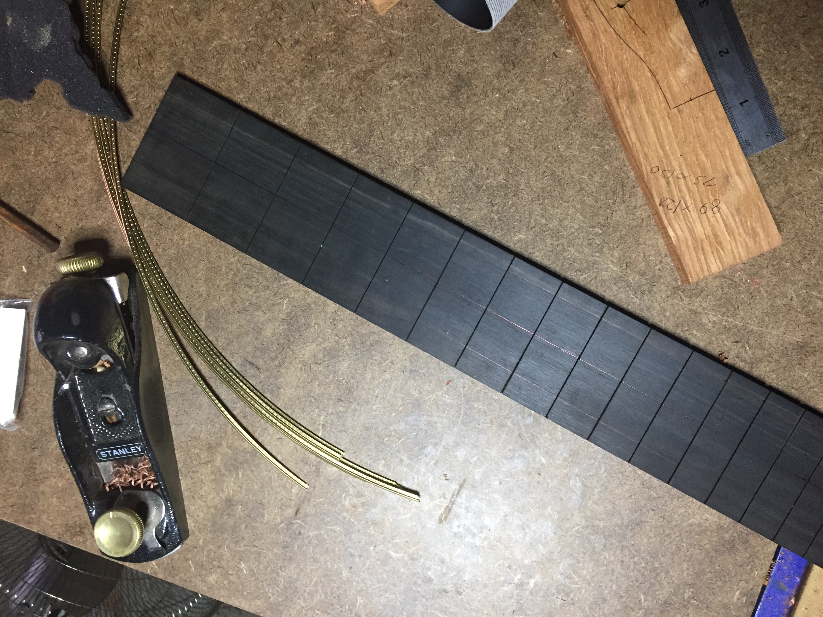

Bit of an update so far.
Bought some evo gold fretwire, some titebond 1,
Bone blanks and a few other bits and pieces, so should be moving a little quicker now...

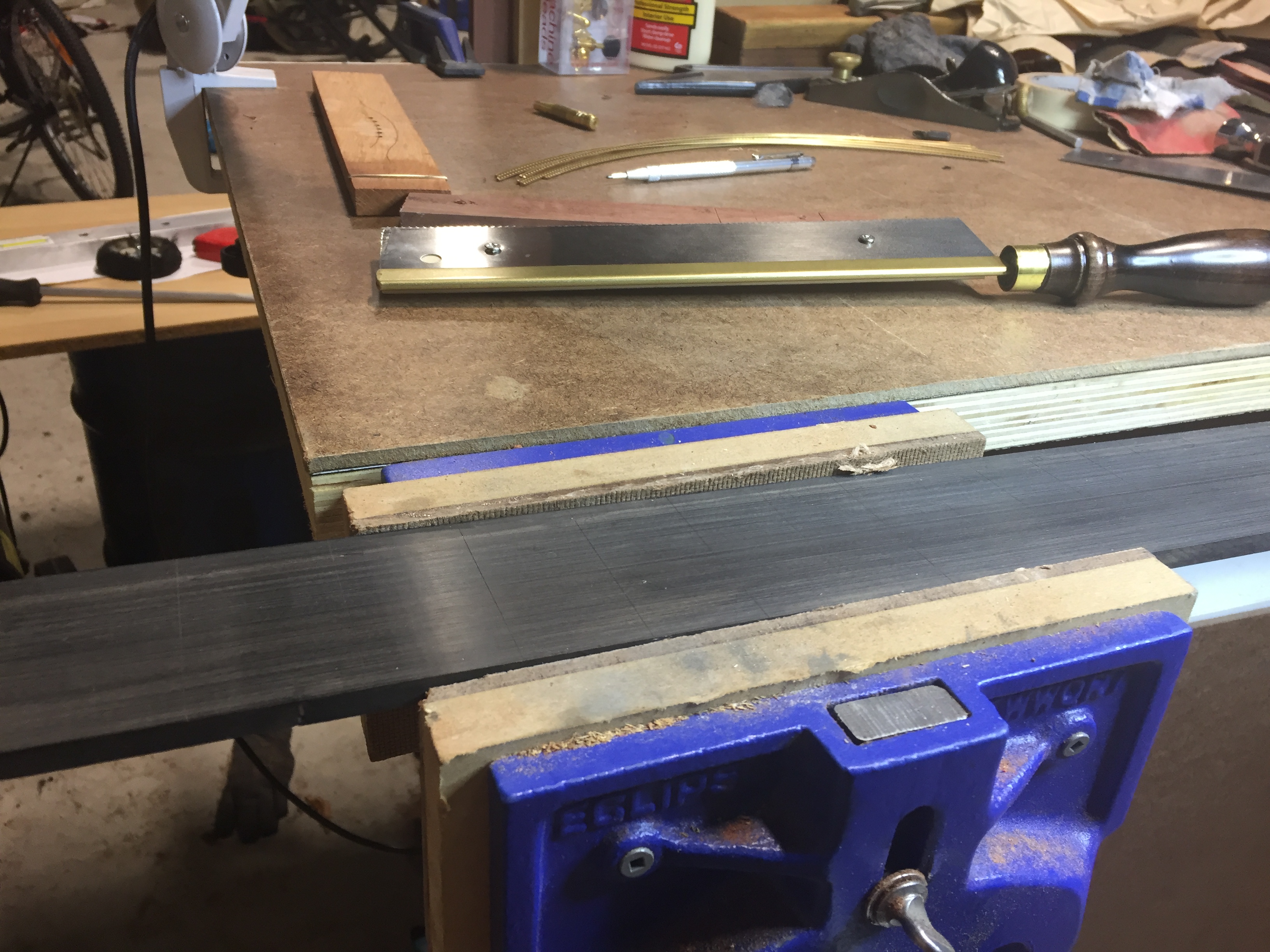

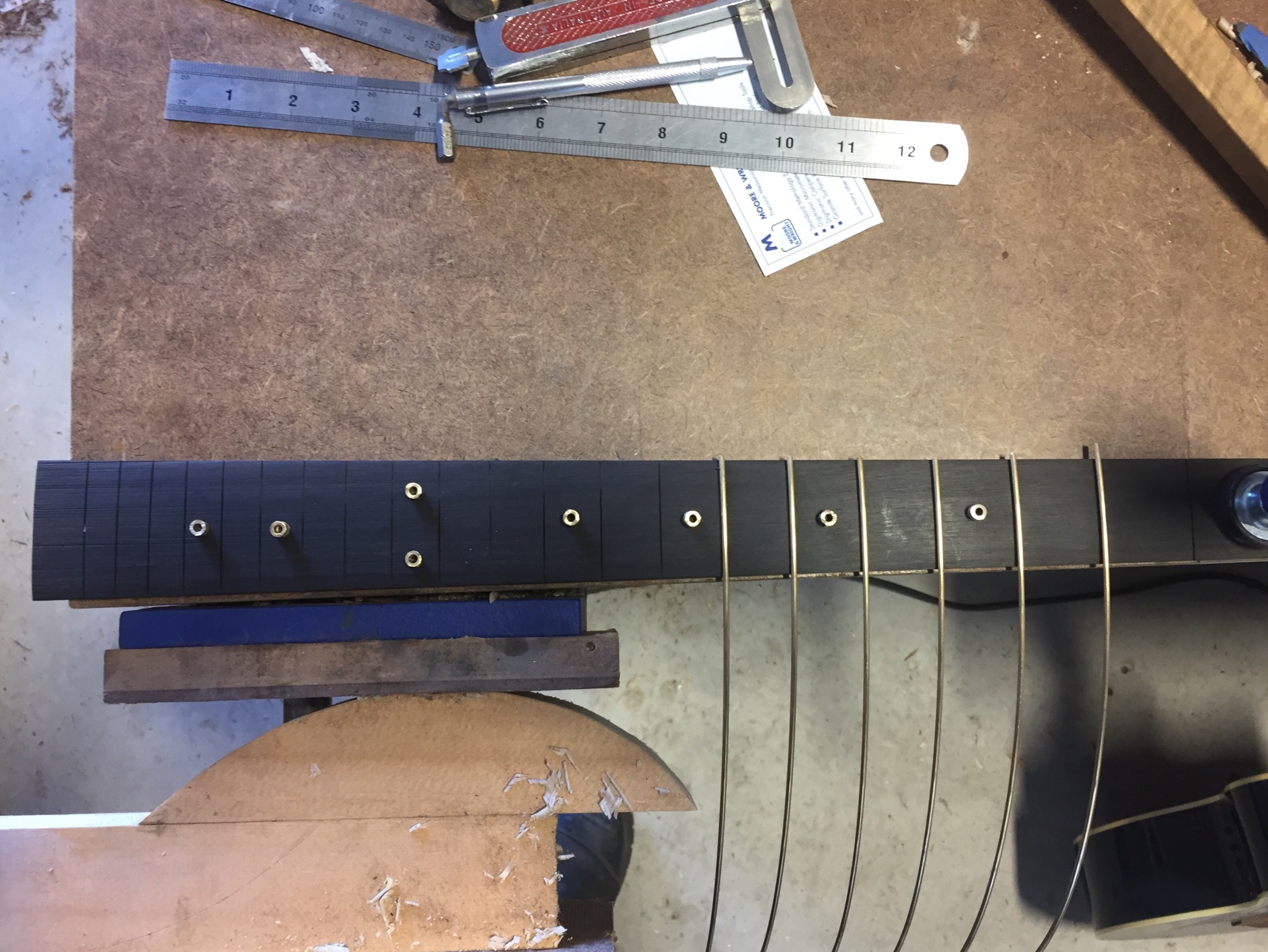

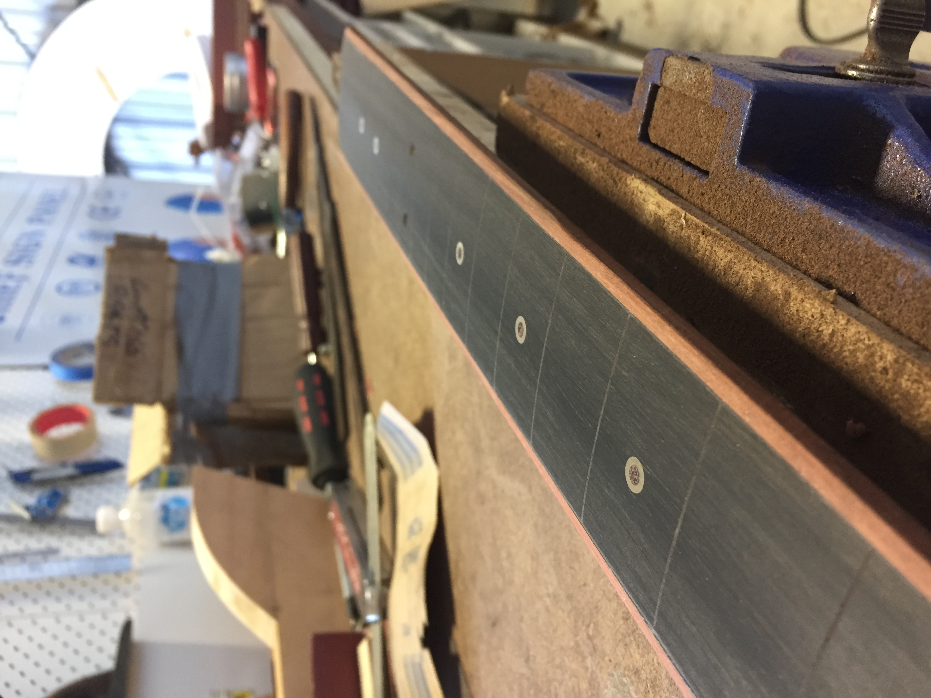

Fretboard is slotted and tapered.
20 frets, 14 to body, and 633mm scale.
I scribed the spacings to nearest 0.1mm.
No issues save fret 10 being a whisker out of square.
Sides have been radiused on the back as well as the arm bevel shaped in.
Headblock, tailblock, and back kerfing glued in before radiusing again.

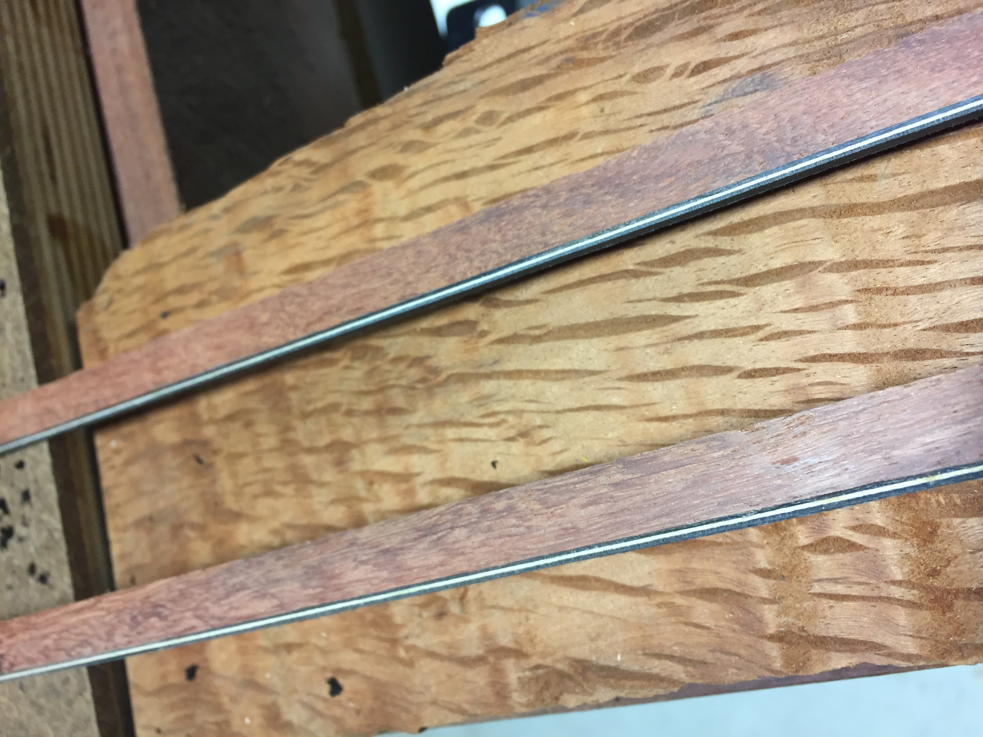

Initially I wanted Mulga headplates, bindings etc.
But that didn’t work out so I’m using Jarrah instead as I’ve got a heap of old floorboard. Has nice enough grain.
Sitca Spruce bracing progressing also.

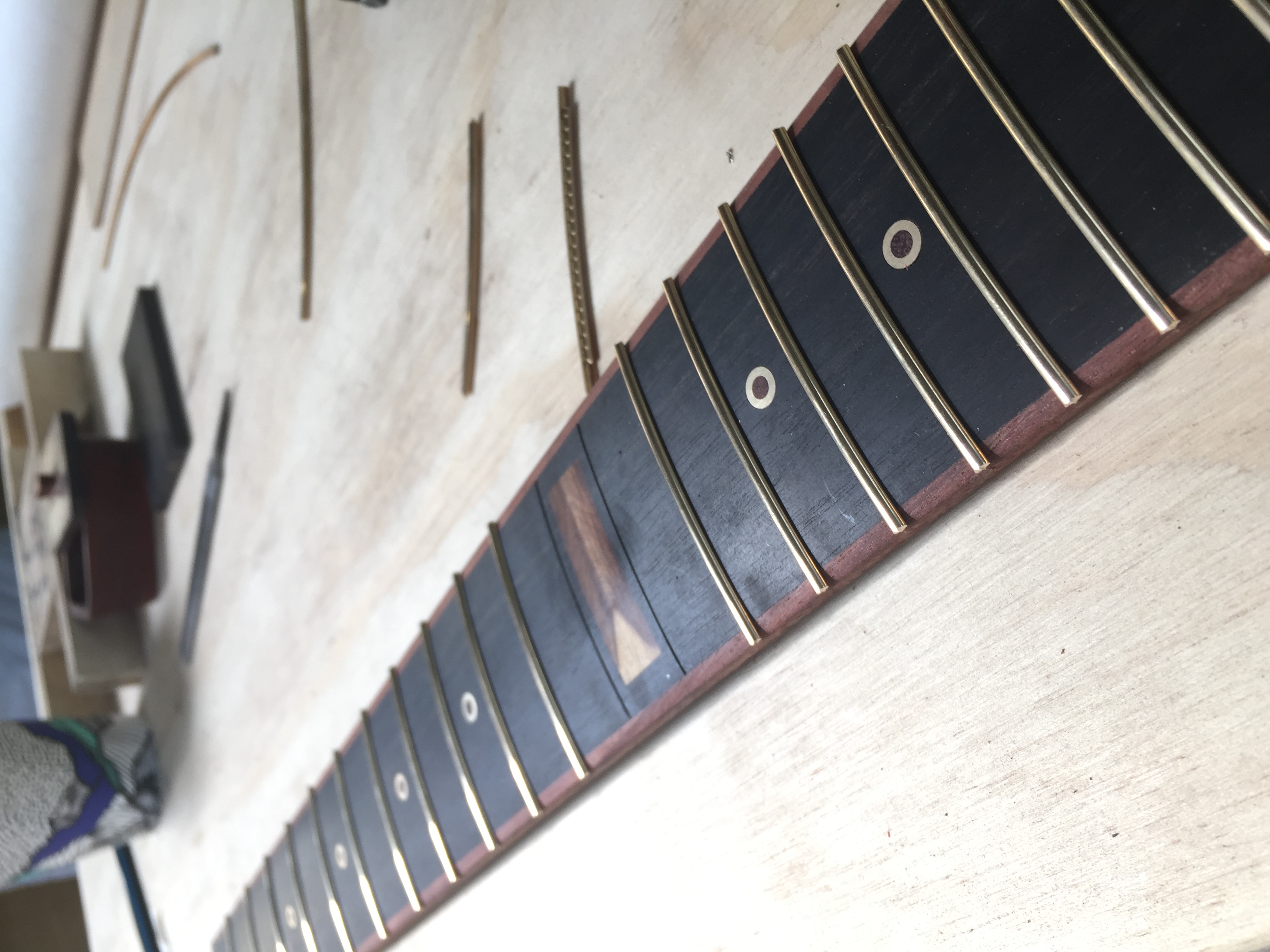

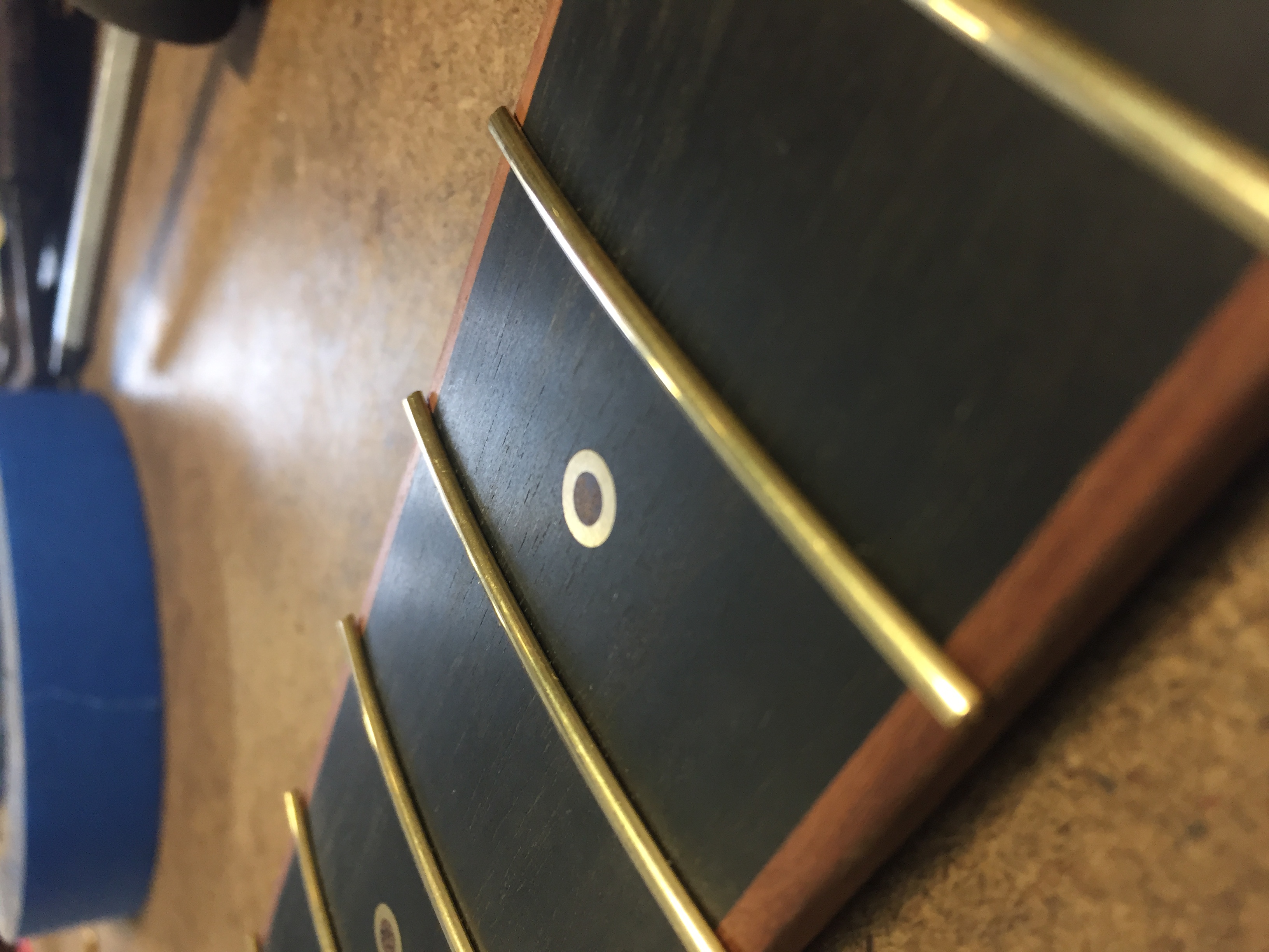

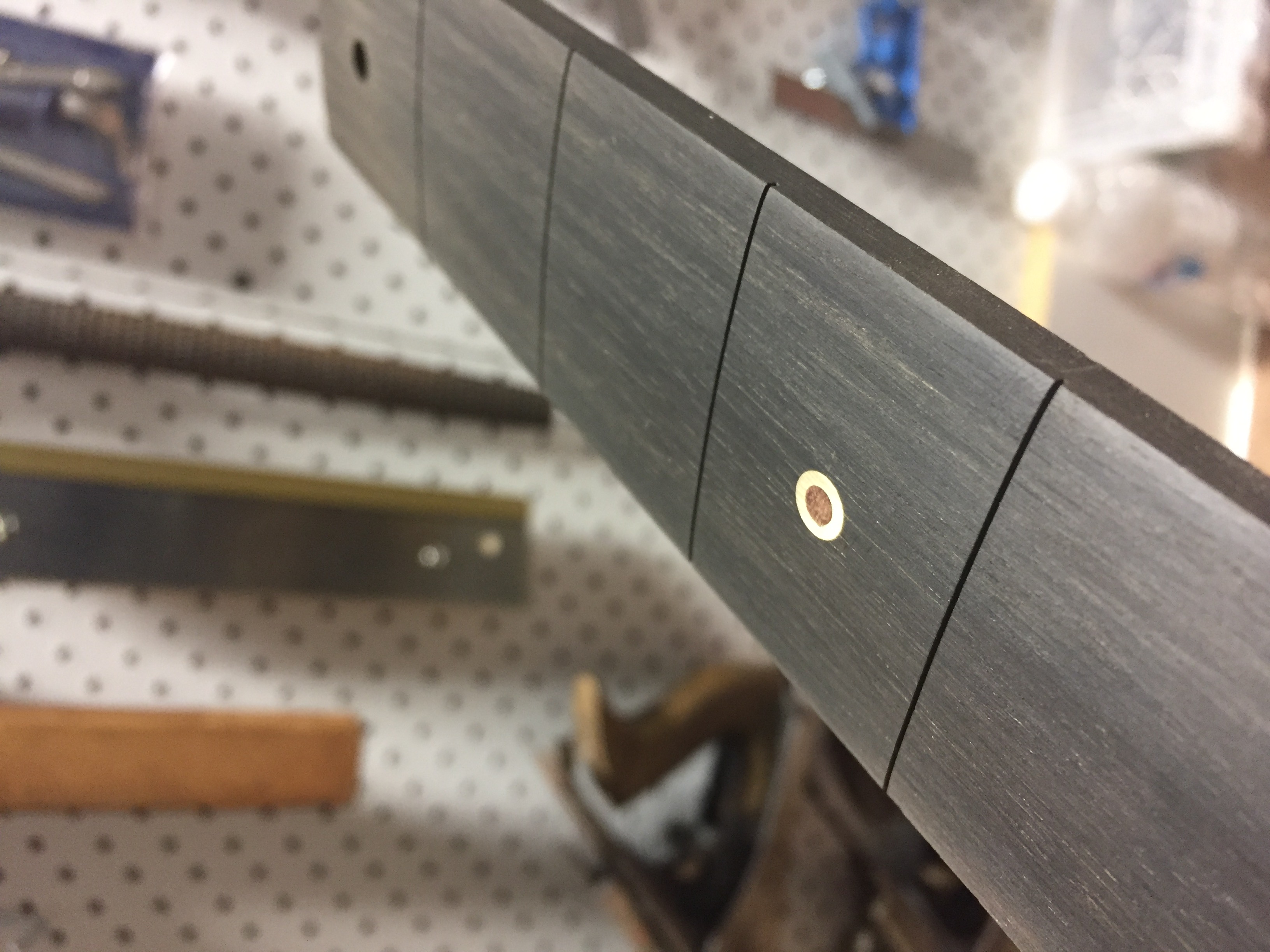

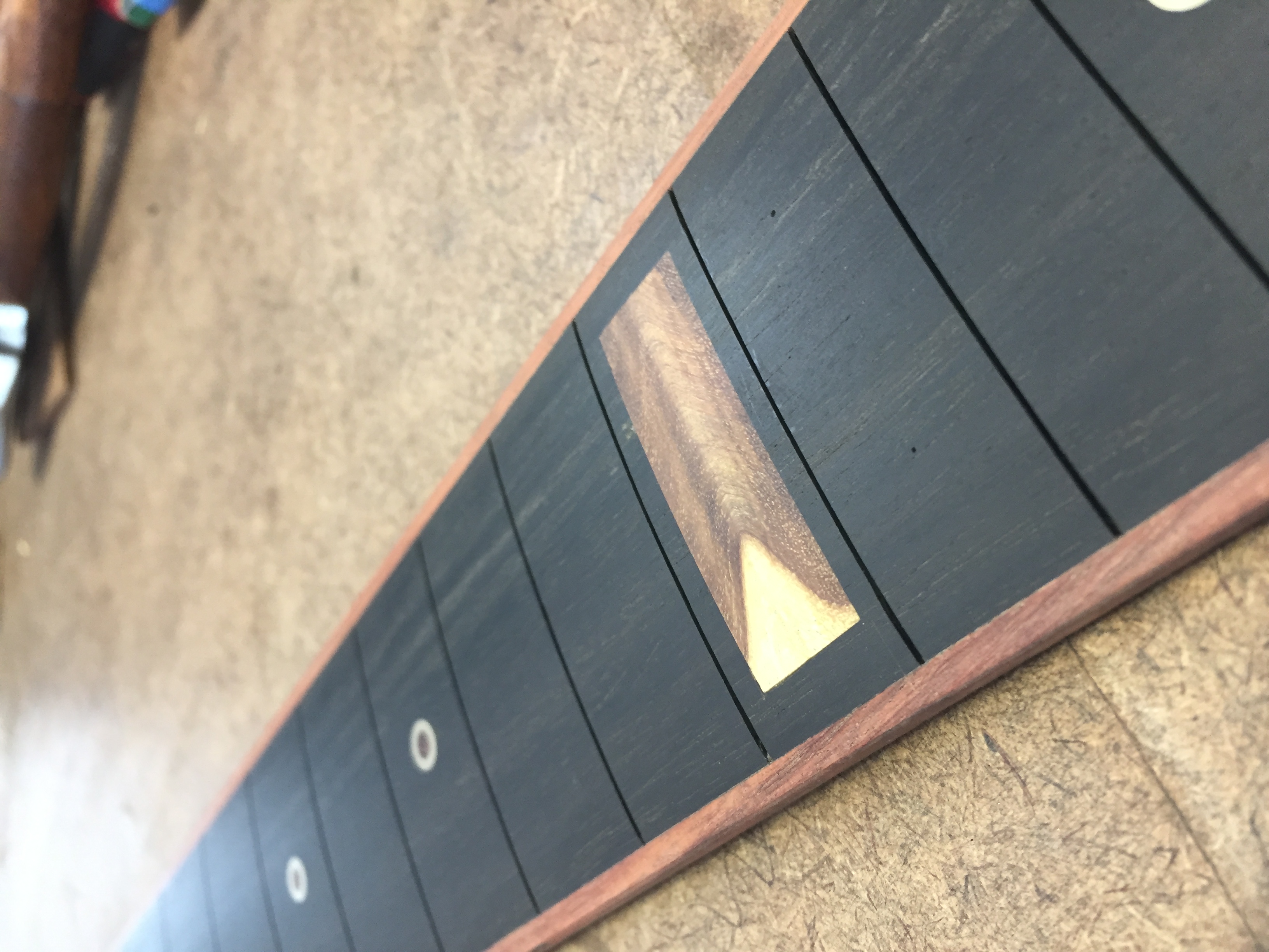

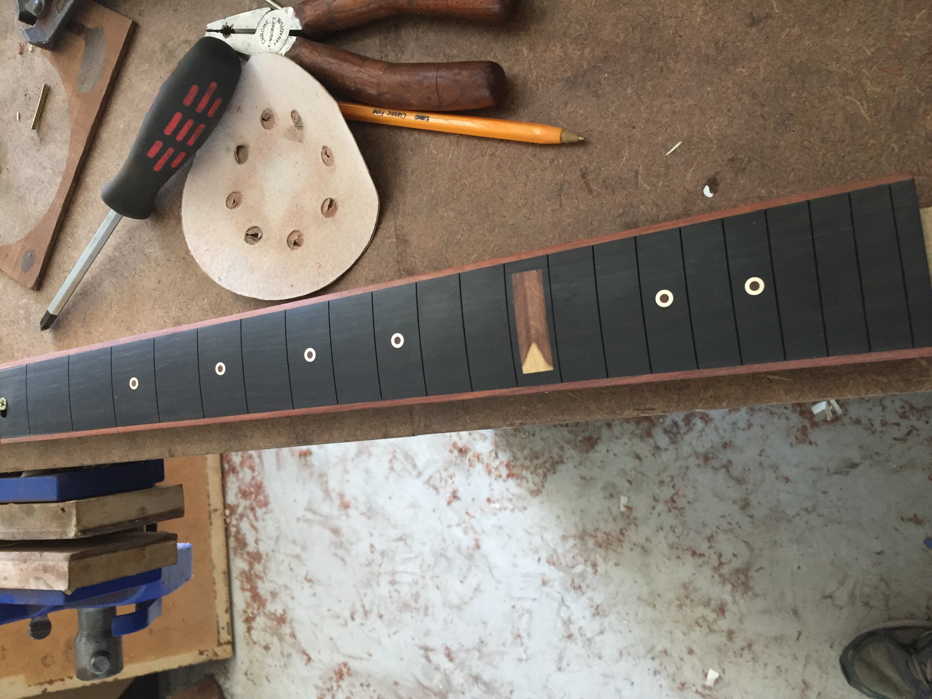

More progress on the fretboard.

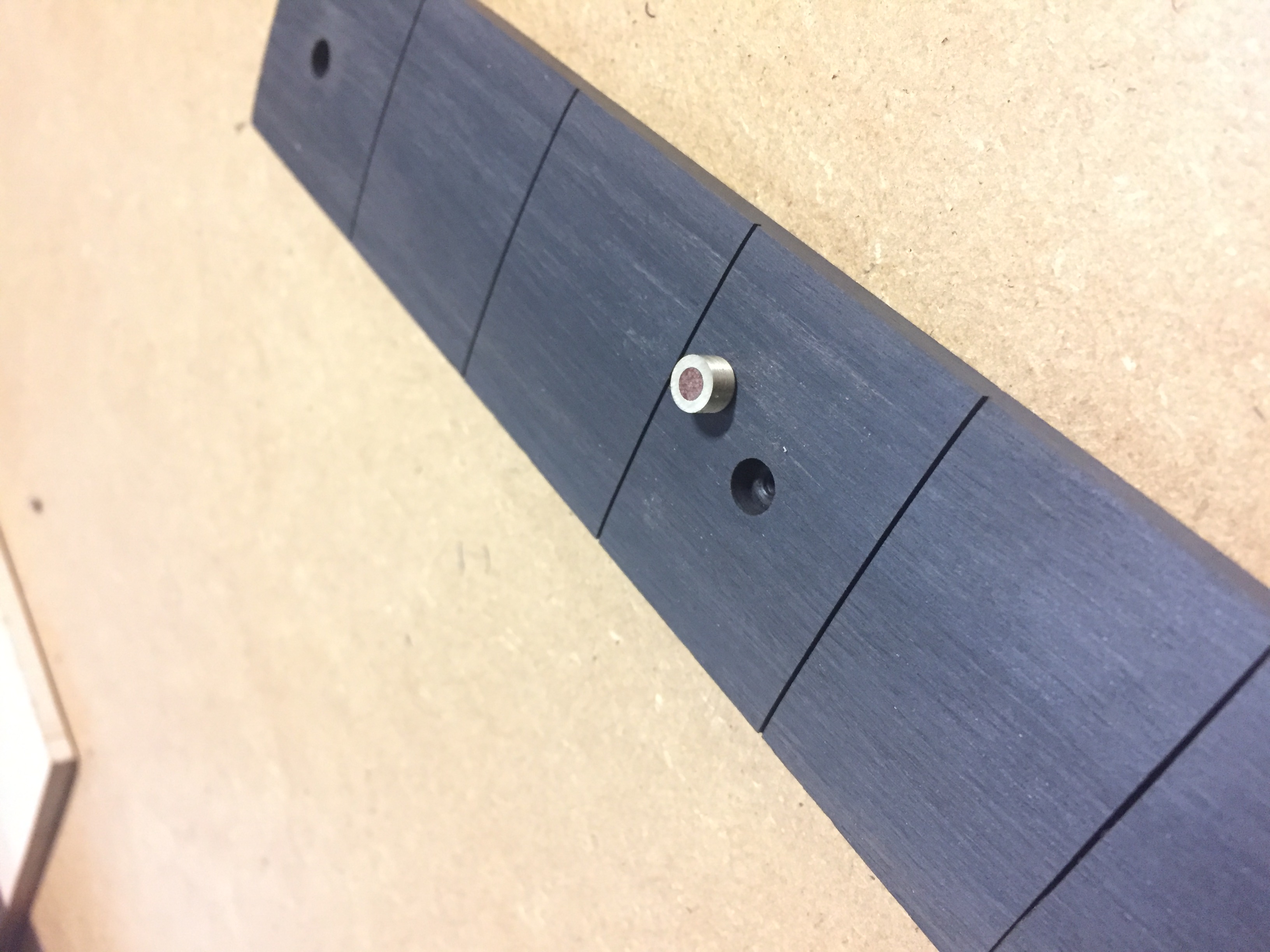

Jarrah bindings and Mulga inlay at the 12th fret.
Was planning on doing just two dots but I messed up a hole... I like it better with the inlay anyhow.
Met up with some Albany luthiers today to put the frets in, Evo Gold.

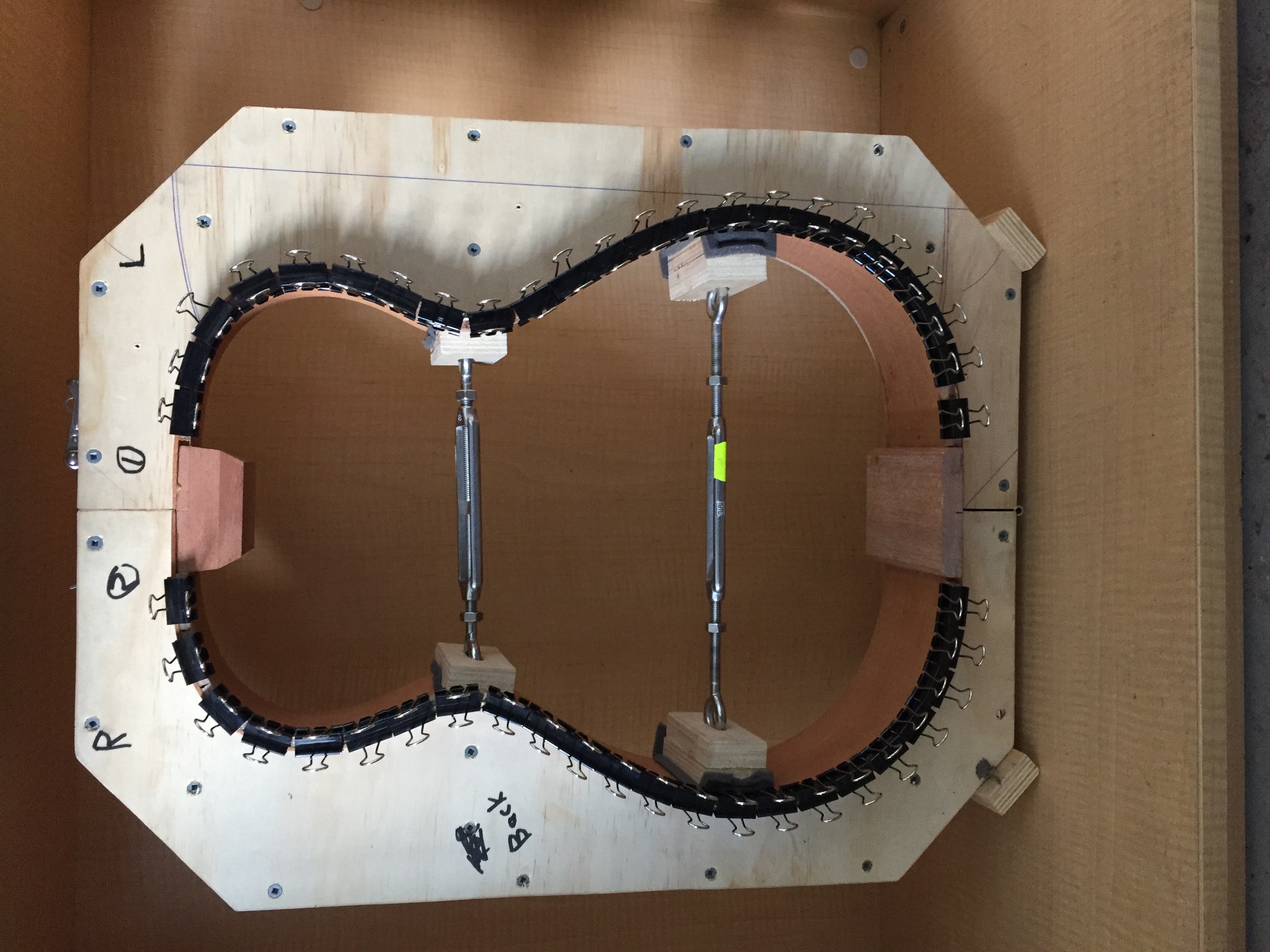

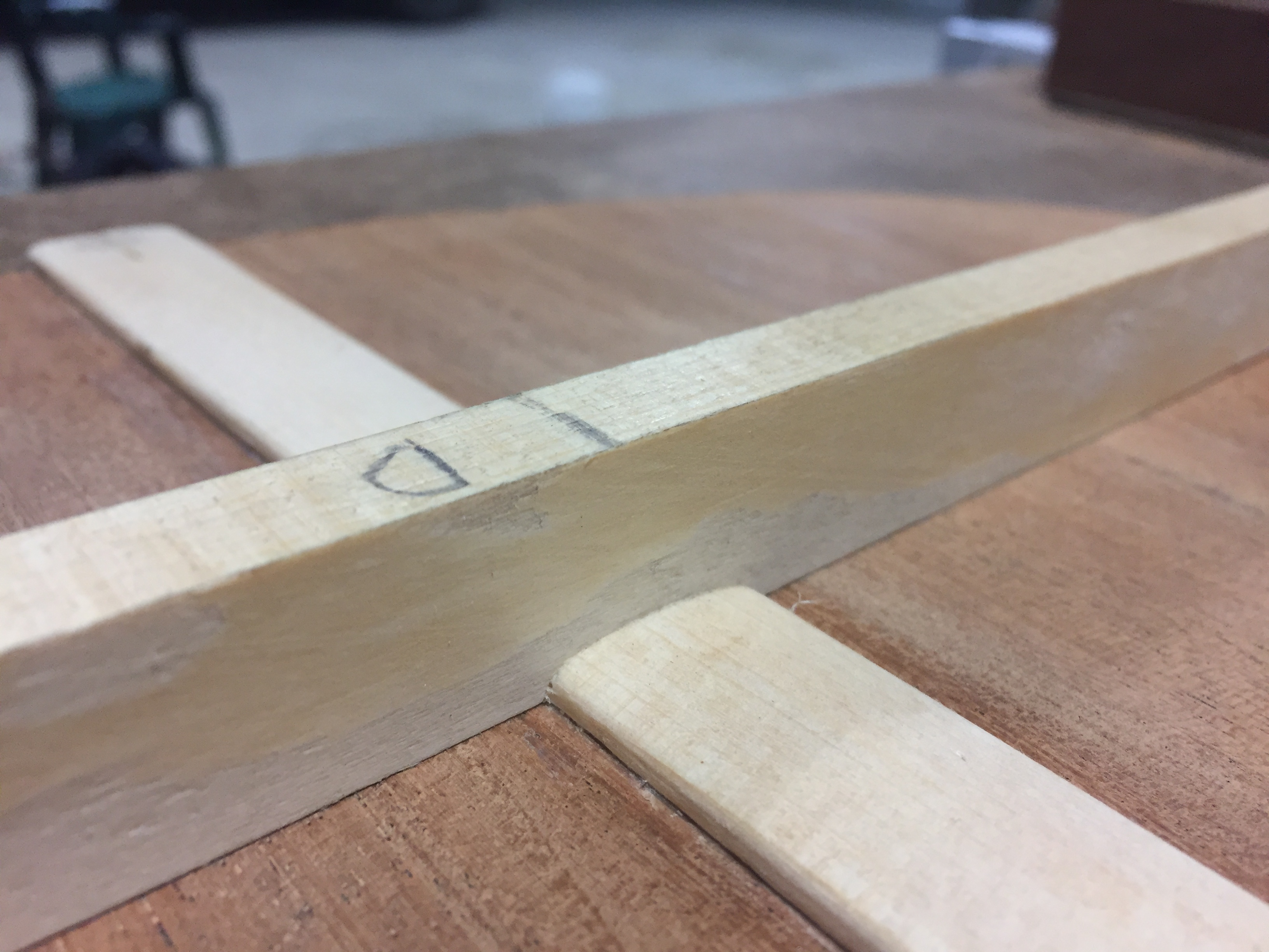

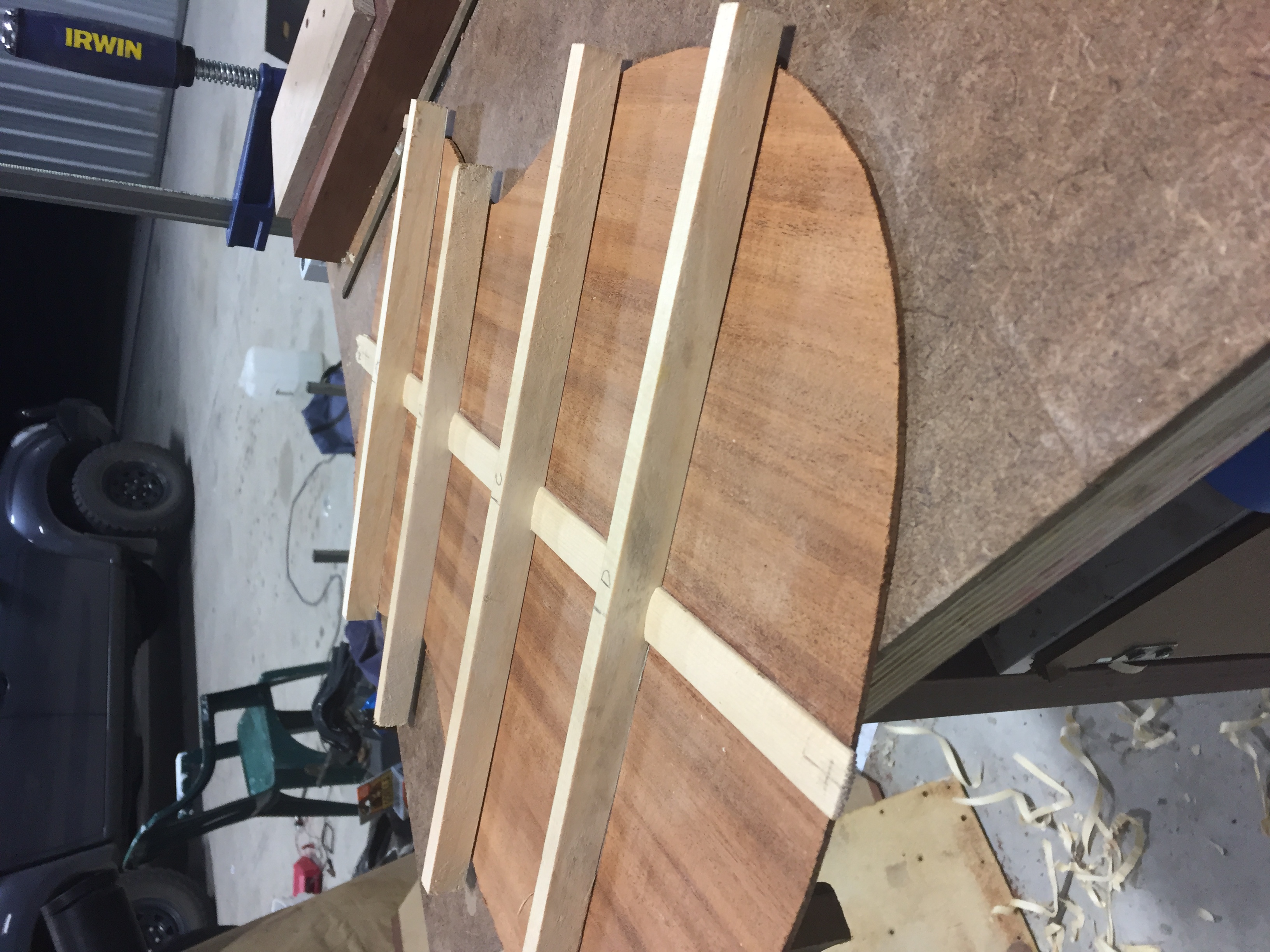

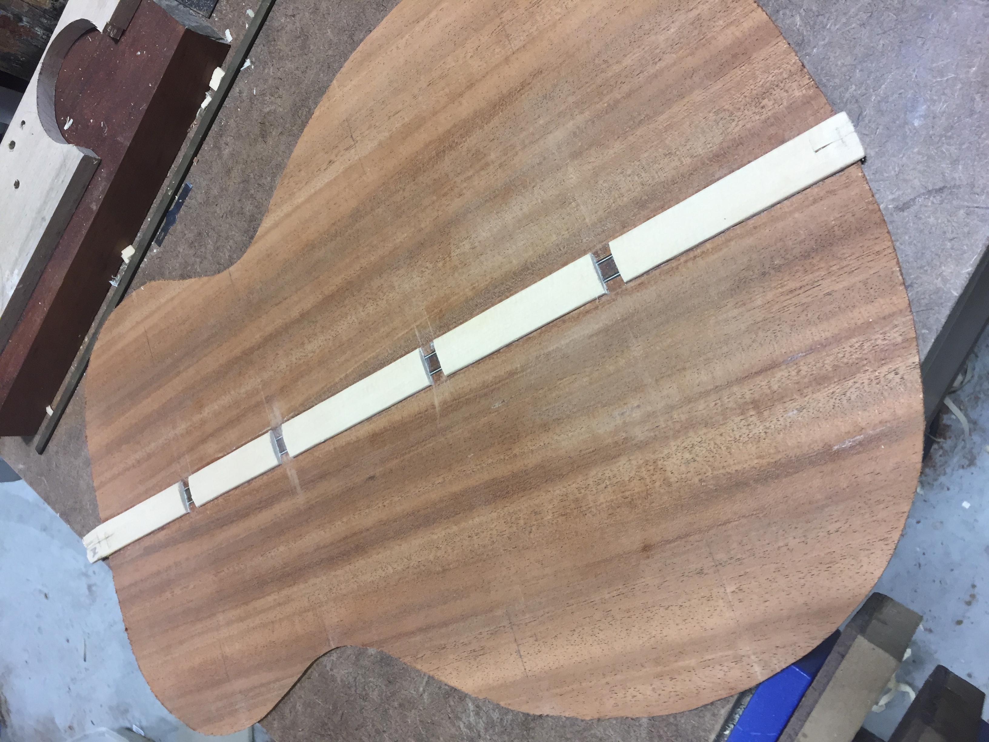

Back bracing.
Just waiting on the humidity before I can go any further on it.
Rim assembly coming together slowly also.
Joseph
