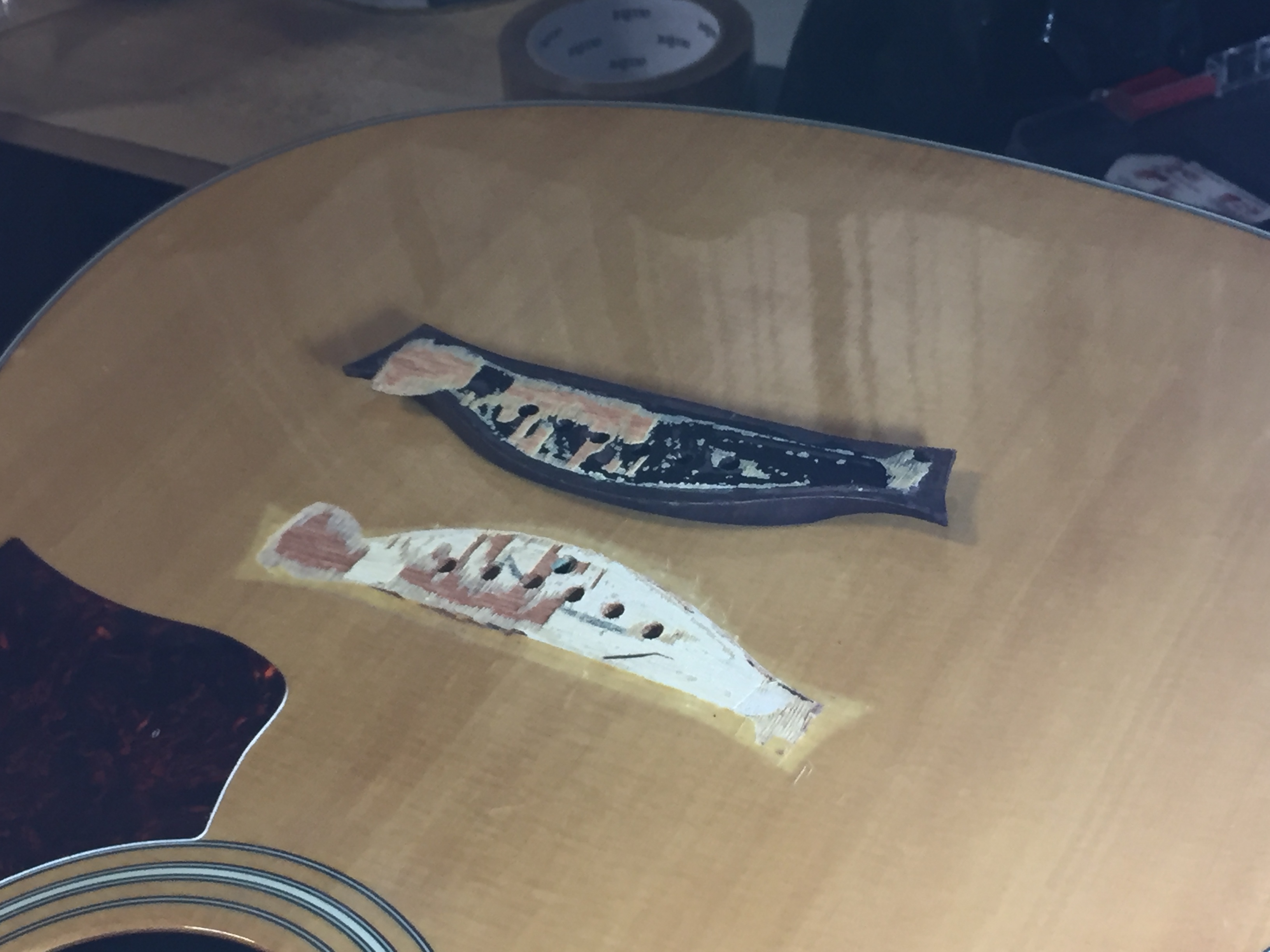

Hi all, just wondering what methods you use to glue a bridge.
How do you keep the pin holes clean and free of glue? or what would you use to clamp it?
I ask this because I am repairing a lifted bridge, I’ve pulled off completely before thinking how I would put it back on.😬
Your advice would be much appreciated.
Regards, Joseph

You need to be fussing about with clamps and checking that it is staying in position - so cleaning out the holes is not going to be a priority at the time. Do it like Martin said and clean that later (pin hole reamer is my recommendation).
You have an issue with some of the top ply coming off outside of the bridge footprint. That is likely to leave a noticable defect in the finish once it is glued back, but you might get lucky and have it sit down nicely. A tip for bridge removal next time would be to use heat to soften the glue and work a thin palate knife all the way around the edge to try to get clean separation. But sometimes it just comes off ugly!

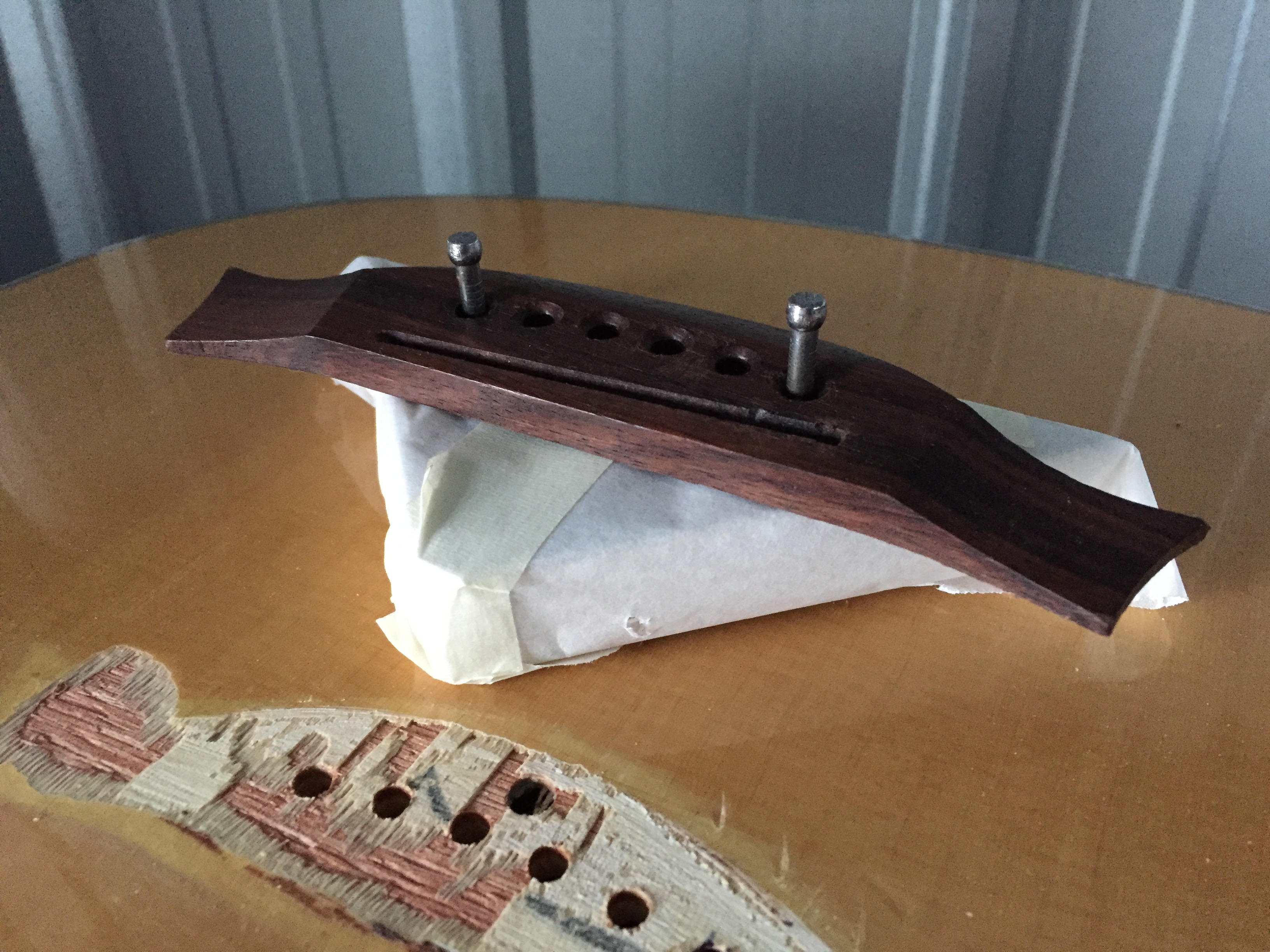

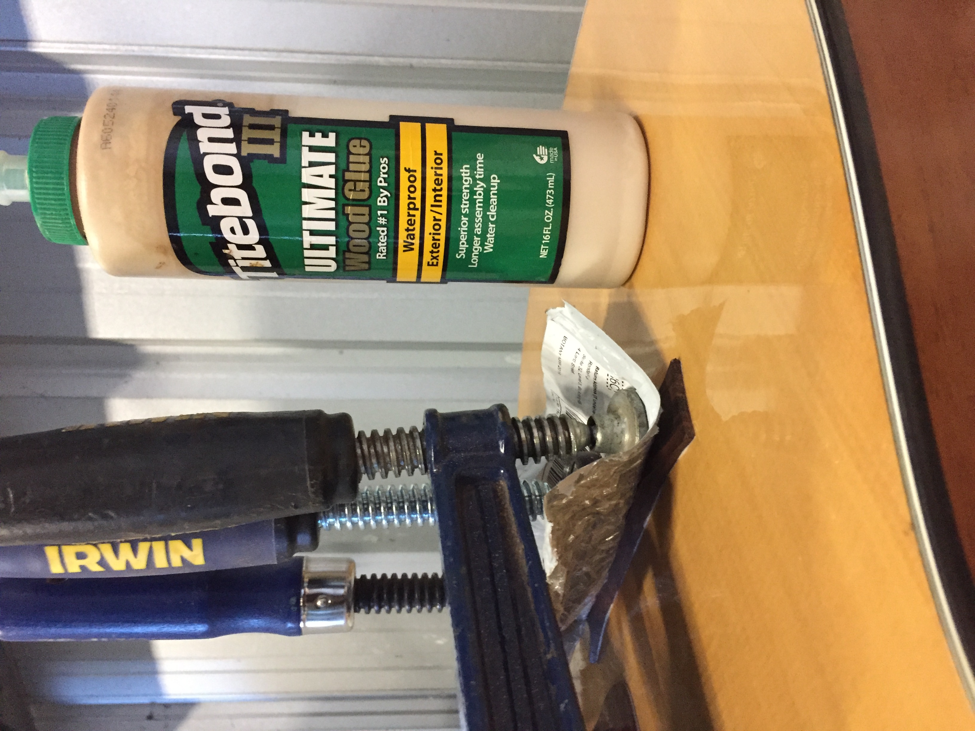

Here’s part of the update I promised, took a while as we were in the process of moving house.
I’ve used Titebond III for the glue and put pins thru the bridge and top into a plywood block cut to fit in the bracing.
Three 200mm clamps hold it well, with bubble wrap that came with my reamer to stop scratching.
Joseph

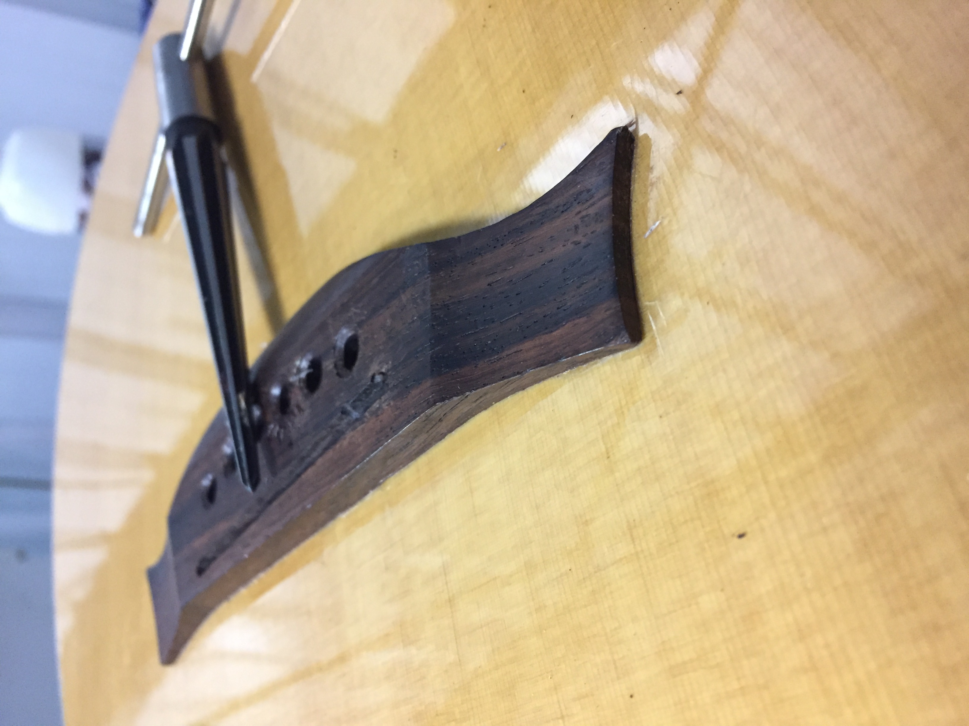

Well, glue up was a success.(apart from that chipped soundboard😡)
Baking paper came off as if it was never glued, and I was surprised at the performance of my new reamer from eBay, especially being unbranded and $16!!

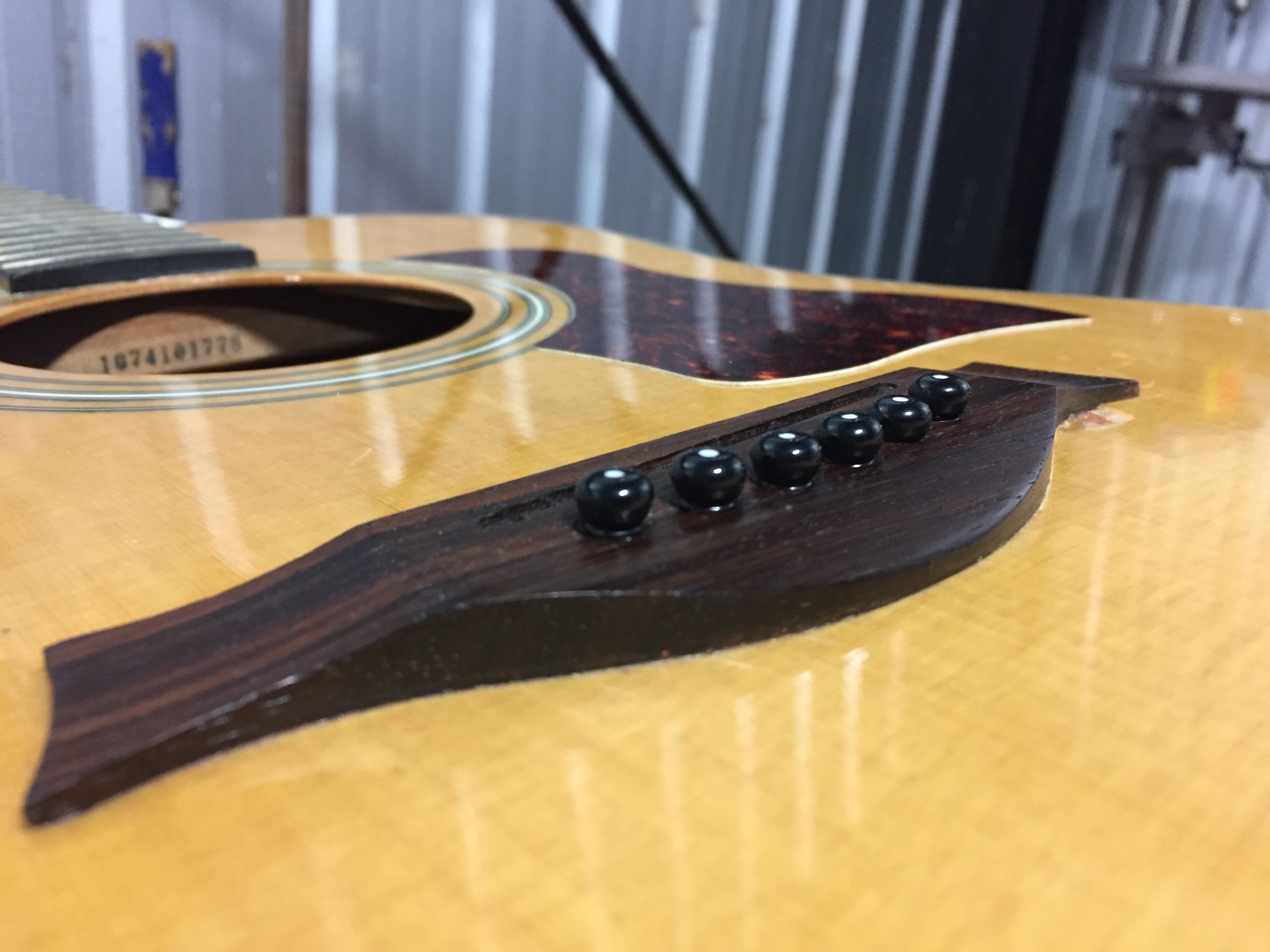

Post by Joseph Jones » Sun Dec 09, 2018 7:31 pm
What do I do if I’ve reamed the pin holes too far?😬
(Sarcastic question of coarse!😰)
Joseph
The stone is hard and the drop is small but a hole is made by the constant fall.
Re: Bridge gluing
Post by kiwigeo » Sun Dec 09, 2018 7:53 pm
Don't do anything until you've strung up the guitar and fitted the string ends and pins. Are you using slotted or unslotted pins? If using unslotted pins have you cut bridge pin hole slots yet? If you cut the string slots on the shallow side you might still get a tight fit once the string and pin are in.

Post by Joseph Jones » Sun Dec 09, 2018 8:08 pm
This was actually a repair job: the owner of the guitar kept it in the laundry and the bridge lifted a bit, causing the pins to pop out.
Slotted pins, and they only just pop when it’s almost tuned. Is counter-drilling the pin heads an option?
Joseph
Re: Bridge gluing
Post by kiwigeo » Mon Dec 10, 2018 7:47 am
Not quite sure what you mean by counter drilling the pin heads.
Are there any string slots cut in the bridge holes? If not you could try cutting string slots and using a set of non slotted pins. I use non slotted pins and hole slots on all of my builds.
Joseph
Joseph Jones
Posts: 77
Joined: Wed Aug 08, 2018 11:56 am
Location: Narrikup WA
Re: Bridge gluing
Post by Joseph Jones » Mon Dec 10, 2018 9:12 am
The rims of the pins sit on the top of the bridge, so I thought counter-drilling might correct that.
There are no string slots in the bridge so unslotted pins would work..... I’ll give it a go!
Joseph
