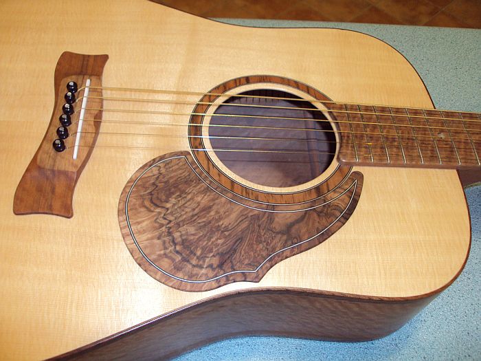

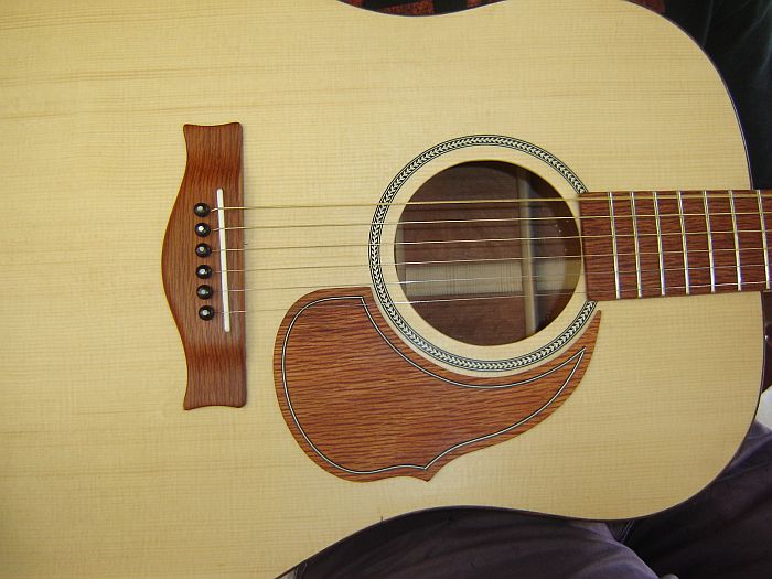

Hello Pat.
Here are a couple of scratch plates I did. They are around 1.5 to 2.0 mm thick
I just used double sided tape. Dreadnaught is true oil finish ... Wando is nitro finish. No problems so far.

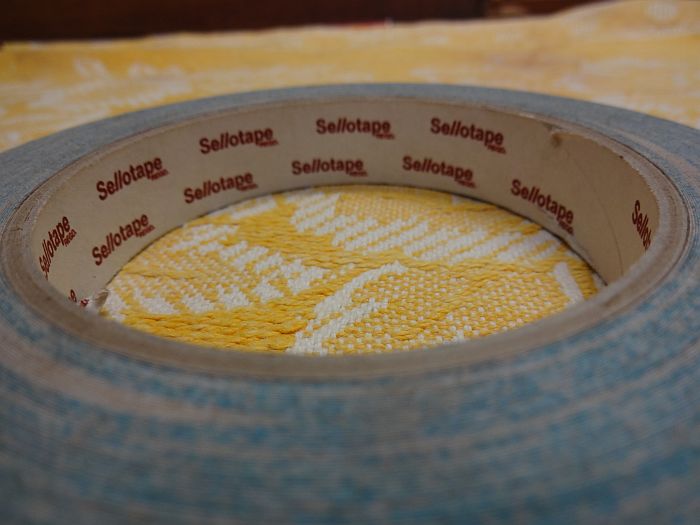

wondering what you guys feel is the best double sided tape? Also, how about putting a layer of the thin clear stick on pickguard material on top of the veneer?

Post by Peter Young » Thu Nov 05, 2015 7:03 pm
Sorry for not getting back sooner. This is the tape I use.

Post by blackalex1952 » Thu Nov 05, 2015 7:39 pm
