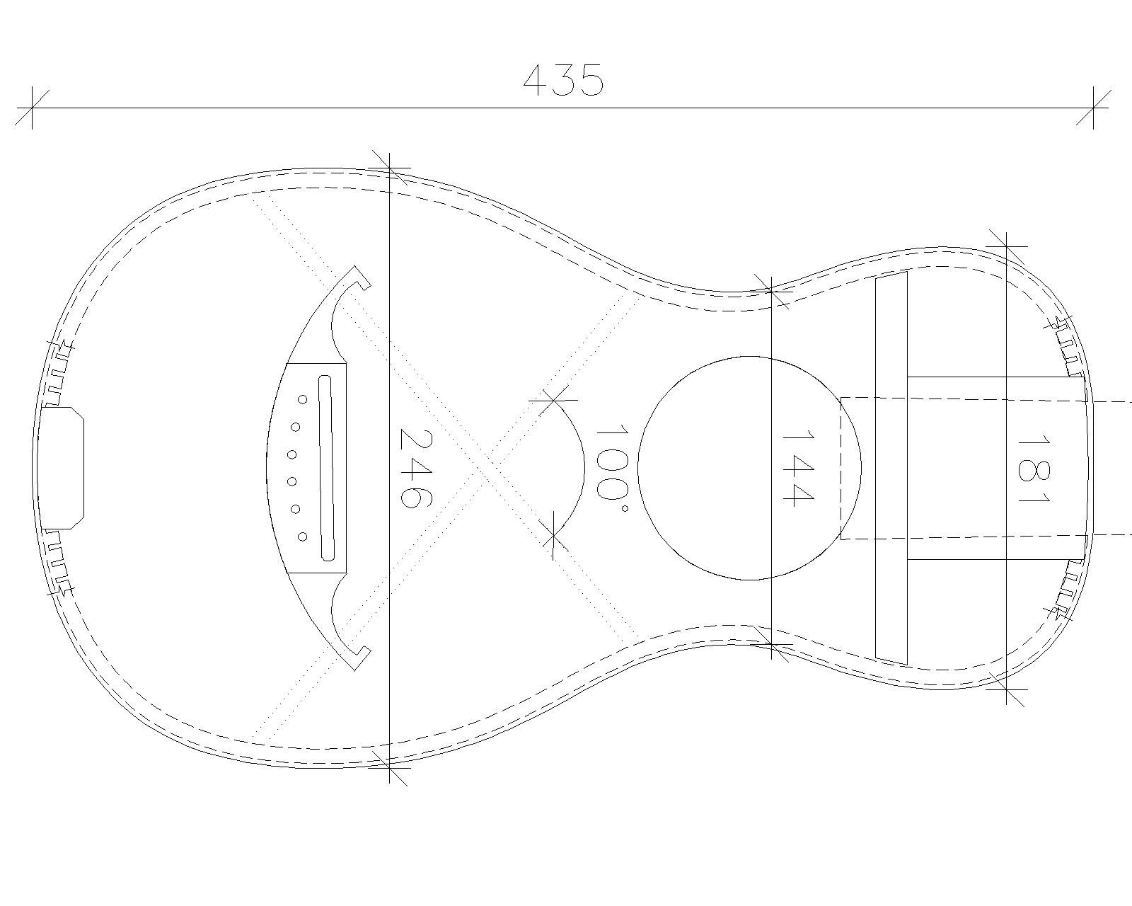

I have been asked to make an acoustic guitar similar to the Ian Anderson model by Brooks guitars.
It will have steel strings with a 622mm (approx 24.4") scale length. It has a very narrow body only 246mm at the lower bout and would like your thoughts on a suitable bracing pattern.
I normally use a X-brace pattern with a 100 degree angle but this does not sit well in the narrow body. Any Ideas?
Thanks Luke
Thanks Luke

I'd be thinking about ladder bracing as a 'conventional' route or maybe lattice as something different. Bob builds some great lattice braced guitars so he may add some useful thoughts for you. Falcate may even be a solution too?
- Bob Connor
- Admin
- Posts: 3115
Re: Narrow Body Acoustic Bracing Patter
For something that narrow I'd be inclined to ladder brace it.
- Bob Connor
- Admin
- Posts: 3115
Or x-brace it like in your diagram.
Put in a very fine finger brace either side.
And a wide (50mm) bridge plate with no other bracing in the lower bout.
Your aim would be to stop the bridge rotating too much by having the bulk of the bridge plate behind the bridge (toward the end block) and placing the finger braces prevent the same. Your treatment of the x-braces in the lower bout
If I read your plan correctly this instrument is 249mm wide at the lower bout. It's very narrow so I would thickness an average Sitka top to somewhere between 2mm and 2.2mm.
The gauge of steel strings will influence things but I doubt whether you'd string anything up with lighter than .011-.050.
I think it would be easy to overbuild something this small.
