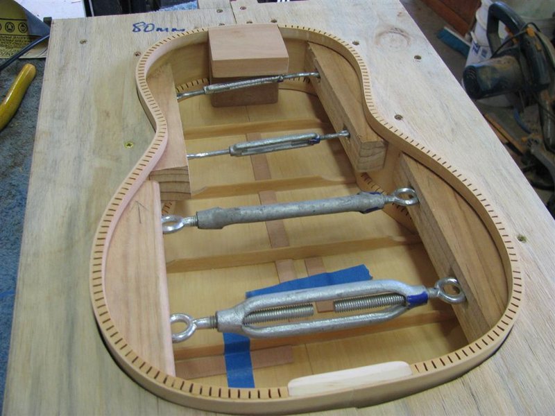

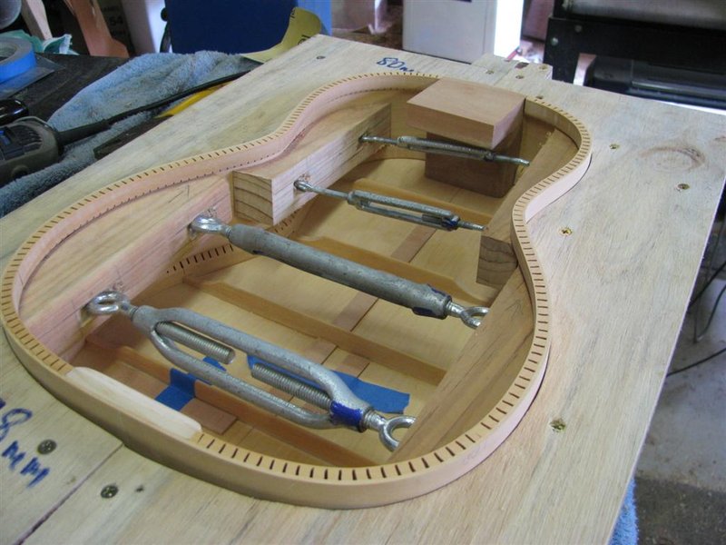

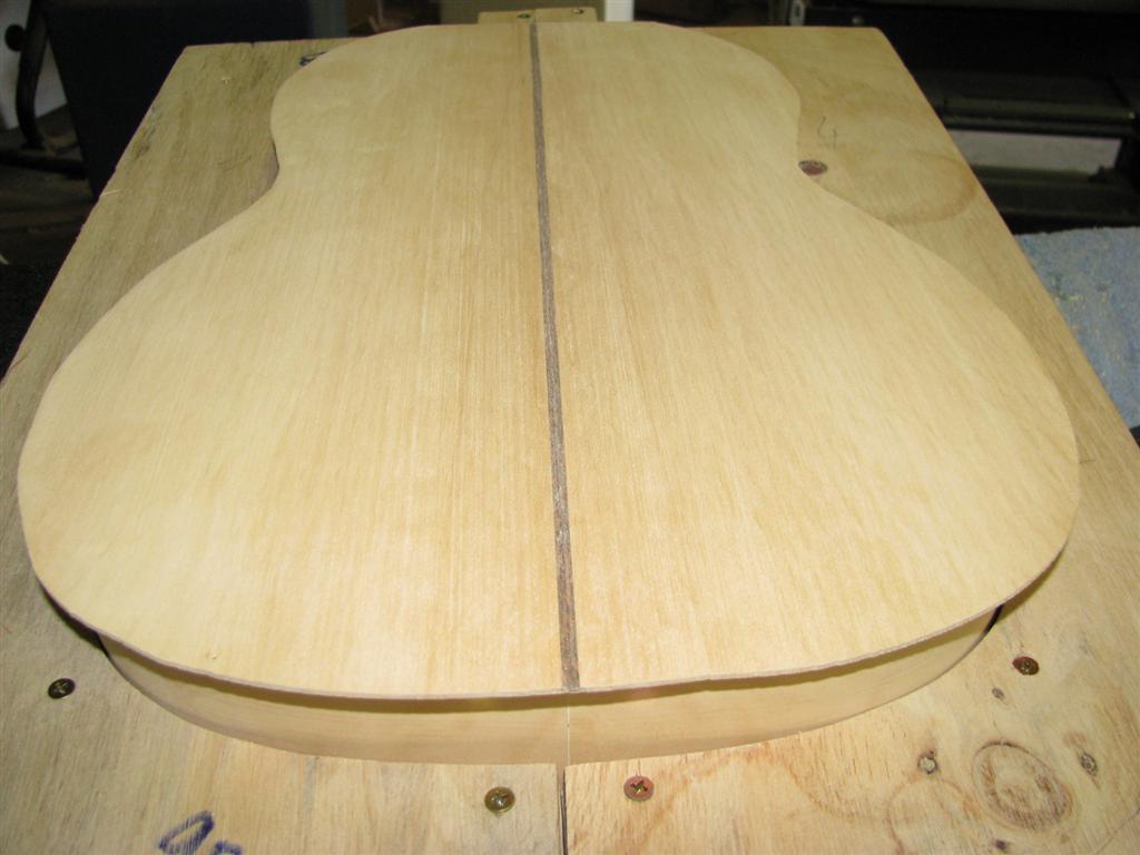

Thought I'd try something a little different with some plans that I got of a Martin size 5 (Terz).
Back and sides are Huon Pine as are the kerfed linings and back braces. Top is going to be King Billy and the bindings will be Tiger Myrtle.

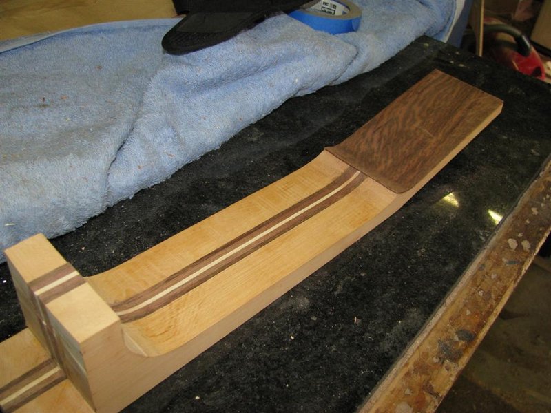

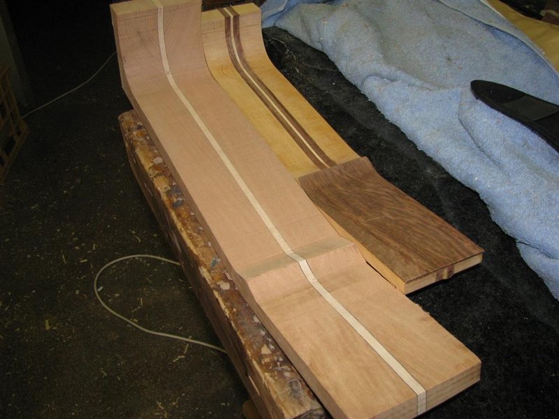

I've made a neck from Huon as well. The centre laminations are Blackwood and Tiger Myrtle.

Interested :) As you'll recall i have some Huon double bass sides and back cut up and ready to go. And the KBP top. How's it working as a neck? stiff enough? I was thinking of laminating a harder centre strip.

I haven't started carving the neck yet Matthew but given that the nut is where the third fret is in a normal neck it should be OK.
I have laminated some Tiger Myrtle and Blackwood on either side of some Satin Box as a centre strip so this should stiffen it up enough.
I've got a mandolin truss rod that'll be going in it as well.
