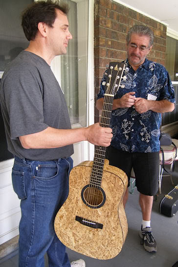

How about something like this.
Back sides and top are made of OSB. I can't remember the blokes name who built it but I've played it when I was in the States a few years ago and it sounds remarkably good considering what it is. (that dapper gent looking on is JJ Donohue who some of you are aquainted with)

Bob, that would be John Ressler of Ressler Custom Guitars. The guitar is mid way down the page.

Post by Bob Connor » Thu Mar 08, 2012 7:29 am
Thanks Lillian.
Just goes to show it was OK if he built two of them :lol:
From memory that green one has a Joe White finish on it so he didn't mind spending a few bucks on it.
