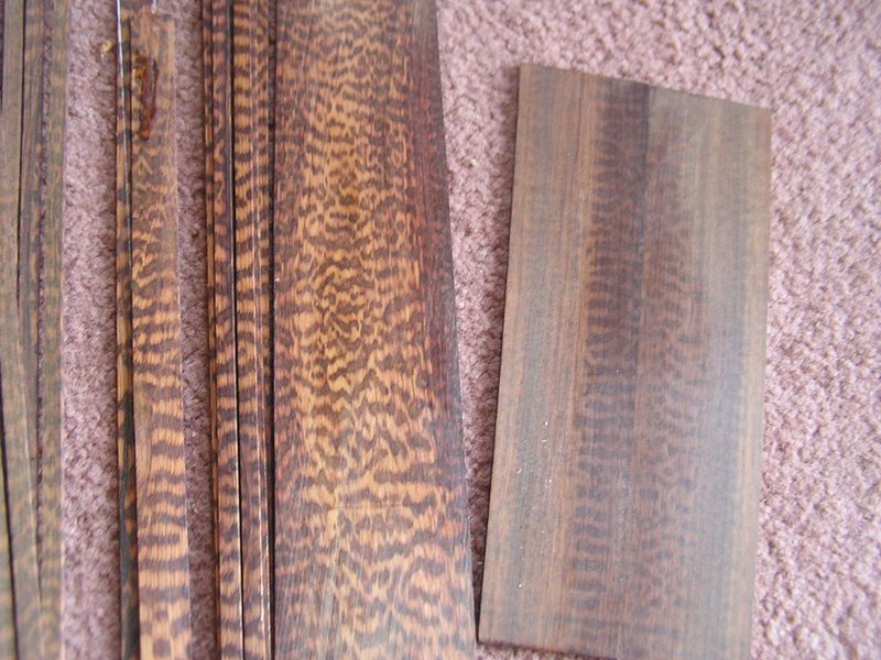

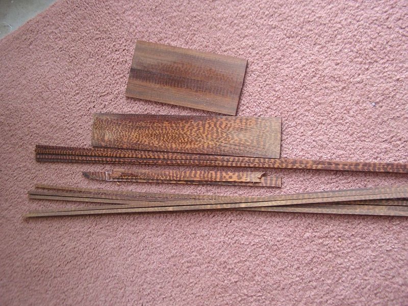

Hi, I was wondering if anybody had used Snakewood to bind a guitar. It is a spectacular wood visually but I bet it bends like glass. I am going to be using it to bind the Brazilian Rosewood OM that I am going to make out of the BRW that I showed in the Wood Rebirthing thread. I was thinking that 2mm would be the maximum thickness you would want to try and bend it with. I would love to hear from anyone who has used it and their tips if any. Thanks in advance
