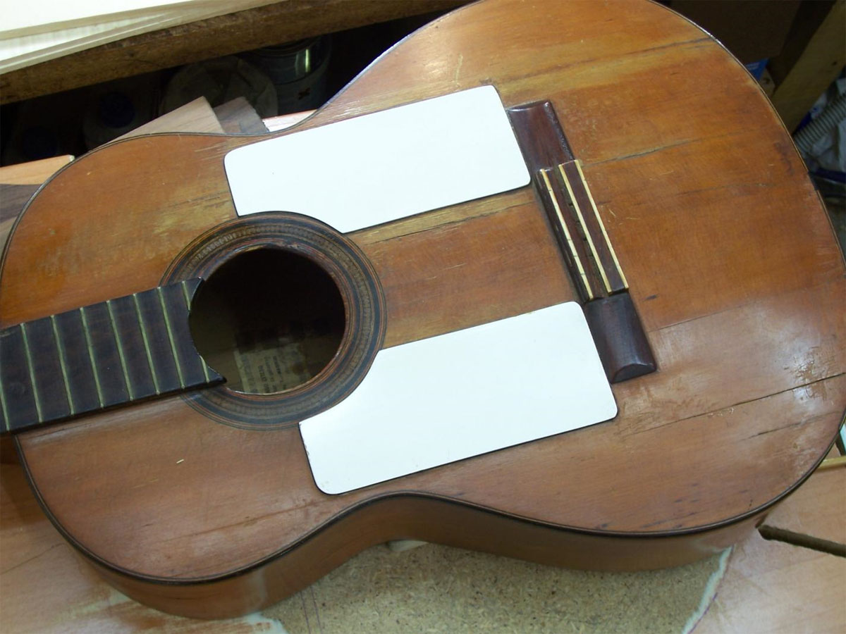

I am asking because two Spanish friends had/have guitars in their shops with opaque tops, but the color of the wood does not seem to be the one of red cedar. In addition, red cedar appears in Spain (and/or Europe) at the first time (at least as it is documented) in the early sixties (via José Ramírez III). The two guitars in question are from 1931 (Domingo Esteso) and 1954 (Marcelo Barbero).

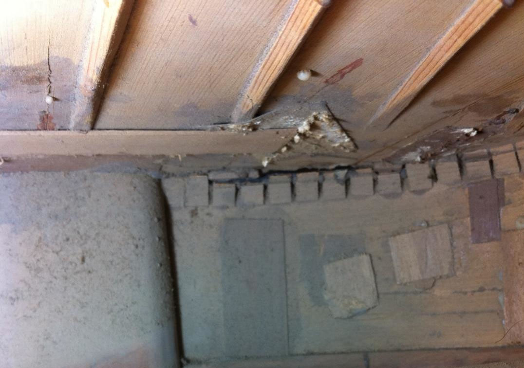

And here are some pics of the Domingo Esteso:

Hi Padma!duh Padma wrote:Now why would you wanna exclude using translucent woods?charangohabsburg wrote:I also would appreciate your input just to know a certain wood is translucent in order to be able to exclude it from the list.
The list I want to exclude those translucent woods from is not the list of woods I want to build with. It's the list of woods the top of this Domingo Esteso 1931 guitar probably was made of.
Nearly all top woods we are using (except Western Red Cedar) are translucent, but the top of this Domingo Esteso isn't, and it's not Western Red Cedar either.
