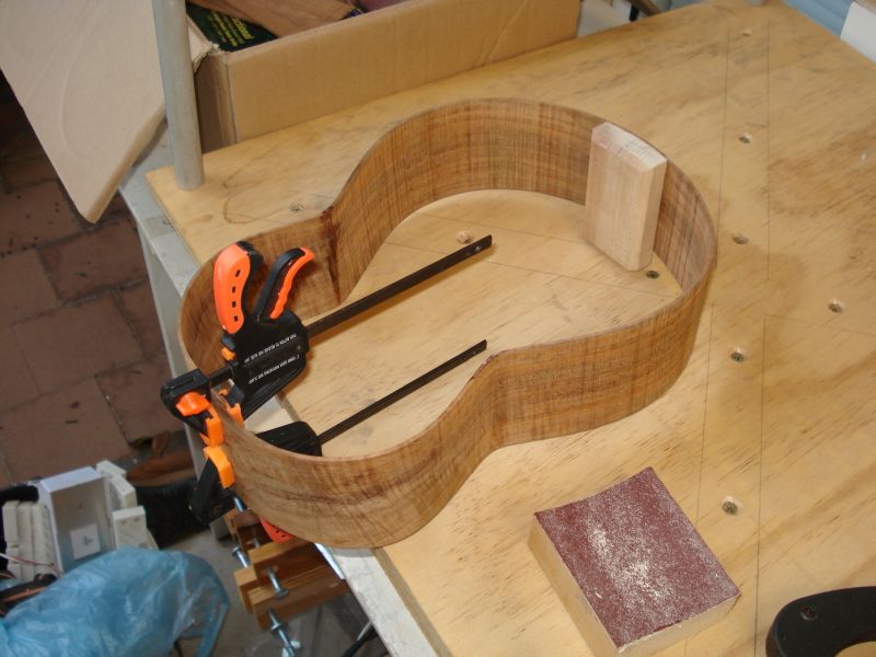

Couldn't show you Liam bending his sides because the cheeky bastard went and bought himself a heat blanket. Did them at home on a form.

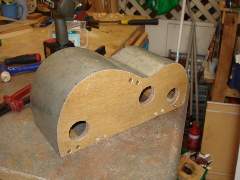

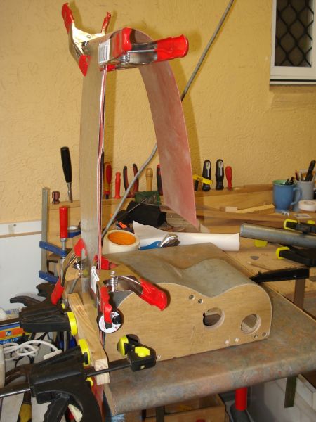

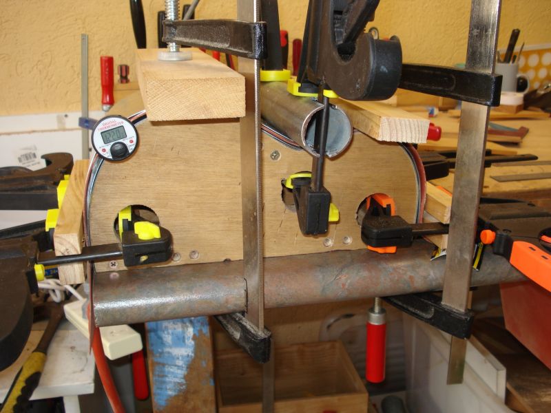

luckily there's no photos of me touching up on the pipes cracking both sides at the waist :cry:
i've only used the blanket once but it seems i've already lost my touch on the pipe. d'oh.
here's the bending process:
And the rest:

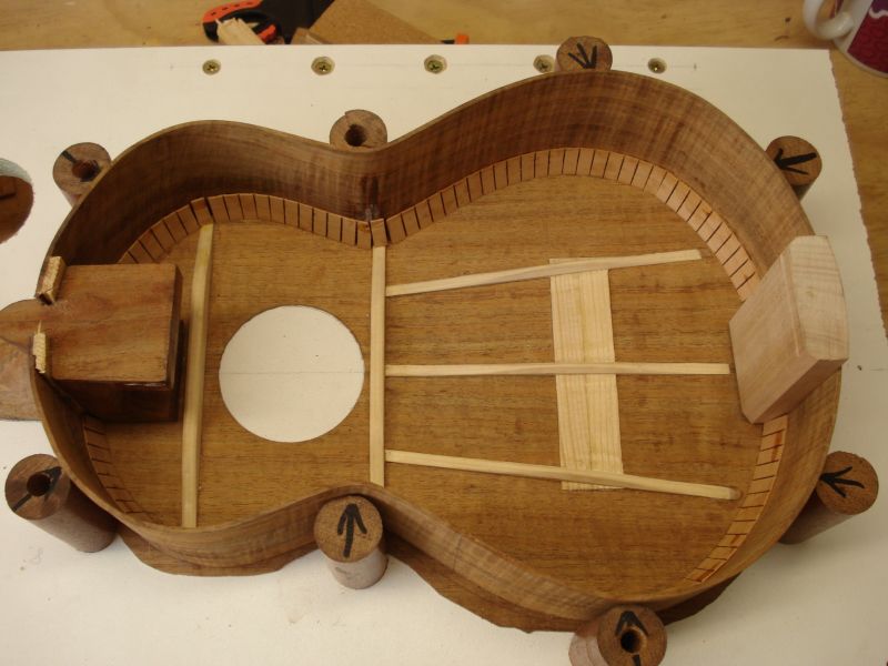

Some have gone to the plan religiously and built according to those dimensions, and I've let them go without any interference. Others have asked for my opinion, and I've gave it to them. It's most interesting when it comes to voicing the top. Those following the over braced top struggle to get a nice resonate tap tone, while those that asked for some help with sizing found it much easier to get to that point.

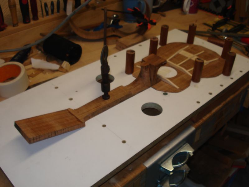

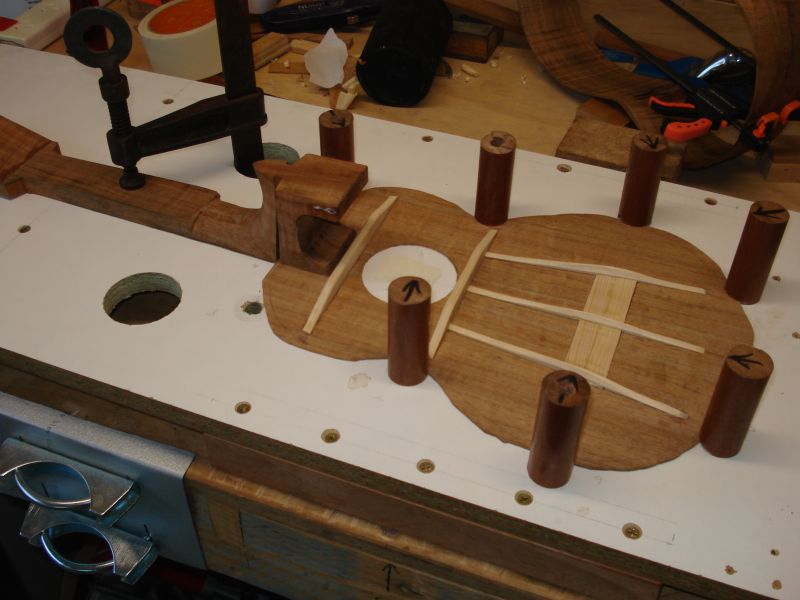

Gluing in the kerfed linings with HHG.
Bracing the soundboard.
Getting some sides bent into shape.

Oh...suggestion...put a couple of 100 watt light bulbs inside the form as well as using the heat blanket on the outside. That helps get the bend set nice and quickly.
