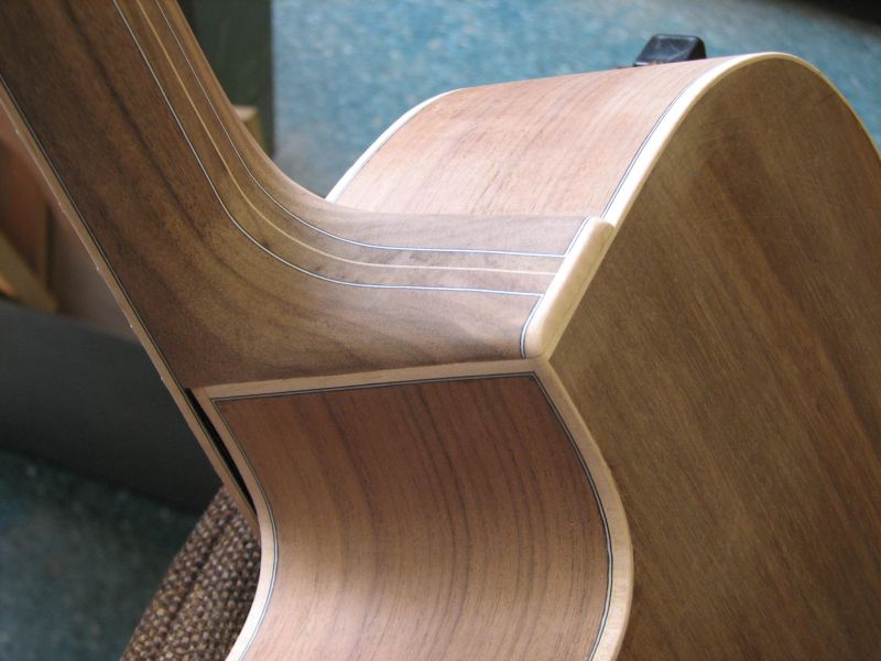

Wow, what can I say Nick, that binding/perf line-up on a dovetail neck to body joint is astonishing!
And I very much appreciate your pics showing your jigging for the dovetail joint. I'm getting ready to set up jigging for dovetail neck joint and am absorbing what info I can find.

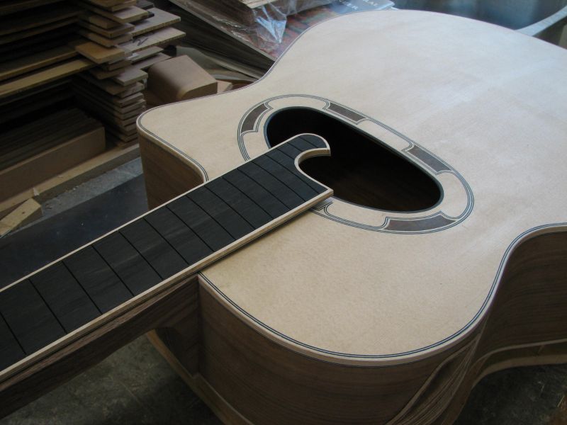

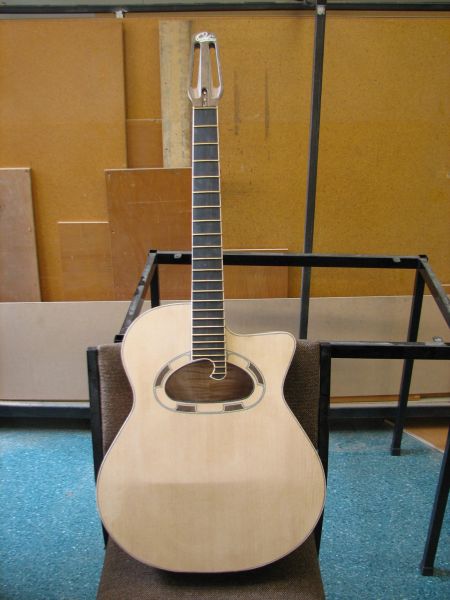

Things still continue to move slowly on this build (damn outside 'distractions' :evil:) But I thought I'd just post some pics to show where Im at.

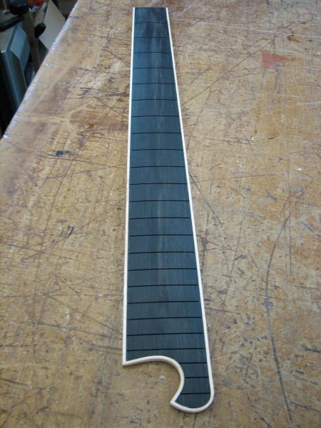

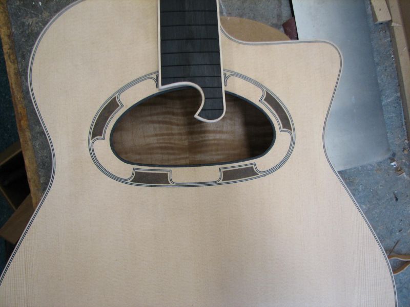

Fingerboard cut, slotted and bound.
& just sitting on the body to show the effect.

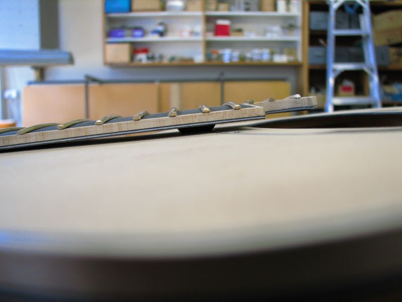

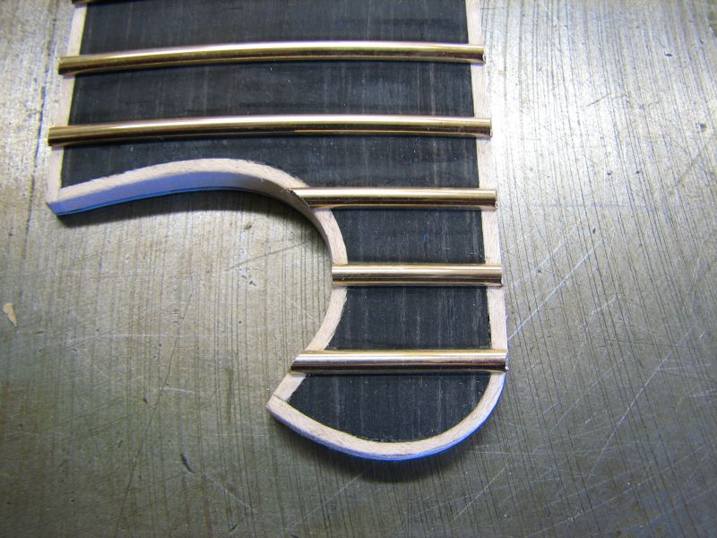

I press my frets in with the board off the neck and use the StewMac Fret Barber to size the tangs with just a few thou interference. Once all the frets are in the board has about 1 -1.5mm of bow on it and easily straightened with a minimum of downforce. For this build I decided to go with the EVO gold wire from LMI, seems harder that the standard nickel/silver wire but not as hard as Stainless.
Frets in but ends just squared off, chamfering will be done when I shape the neck.

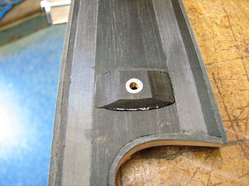

I'm also going with a cantilevered overhang on the board (2mm gap at the neck/body join). I layed a couple of CF rods into the underside of the board with the intention of stiffening up this area, unfortunately it didn't end up being as stiff as I felt it needed to be so I've added a small packer on the underside where the UTB falls so it looks cantilevered but is supported by the upper transverse bar. Rather than gluing this spacer down to the top I'm going to put a cap screw in up through the UTB. If the neck ever needs to come off the cap screw can come out and the dovetail steamed in conventional methodology.The little spacer seems to be more than adequate to hold the board flat and rigid in my "PRESSure" tests so far :wink:
The spacer with an insert to take the 4mm cap screw
And a side shot showing the cantilever

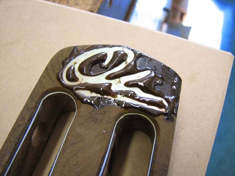

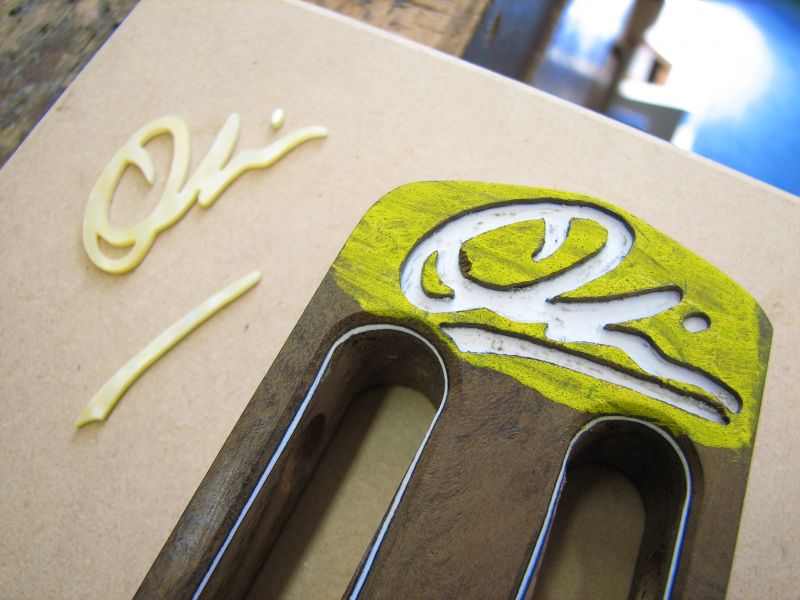

& a couple of shots showing my 'Signature' headstock inlay, decided to keep with the gold theme and used Gold MOP.
The Burl veneer still likes to kick my arse from time to time and you can see the small chipout on the inner edge of the 'O' loop :evil: So I've mixed a little Imbuya dust with the epoxy, I was hoping to avoid this but... hopefully the colour match will be close and it won't show too much once I've dressed off the excess.
Epoxy's drying as we speak so I haven't got a picture of the finished inlay yet but I did take one in it's 'gloopy' best state

Post by Kim » Sat Oct 10, 2009 7:42 pm
Looks delicious Nick, just THE classiest build.
Post by Allen » Sat Oct 10, 2009 7:51 pm
I'm just so in love with the styling Nick. Are you going to be able to part with this instrument should someone want to take it home?

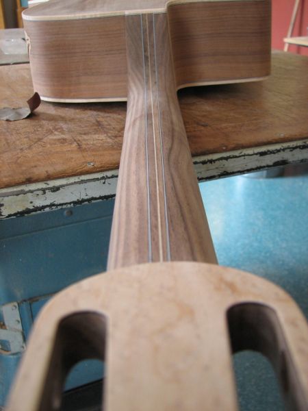

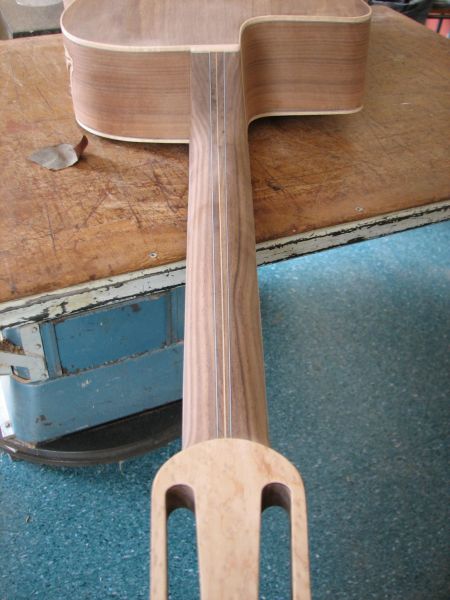

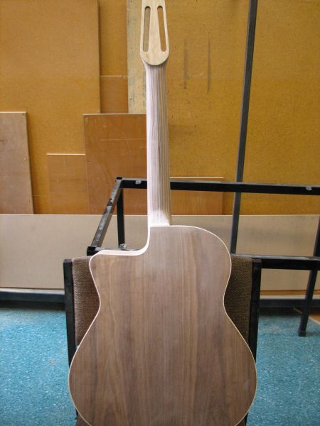

Post by Nick » Wed Oct 21, 2009 1:55 pm

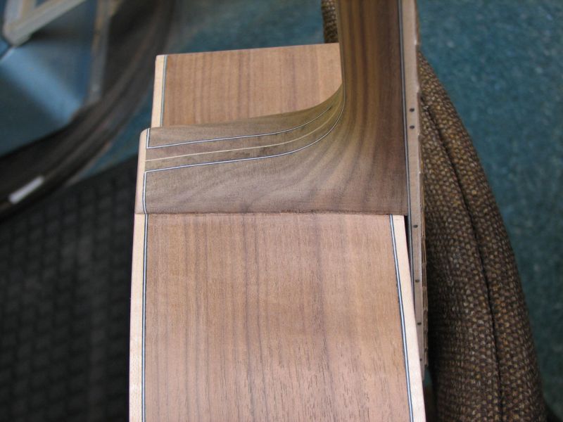

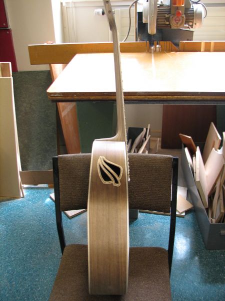

Necks on (or as my dear old mum refers to it.... "The handle") Woo Hoo! It's looking more like an axe now :wink:

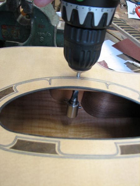

I used a Stainless Cap screw to fix the fingerboard extension to the top (through the transverse brace).
Image (just incase you aren't familiar with a capscrew)

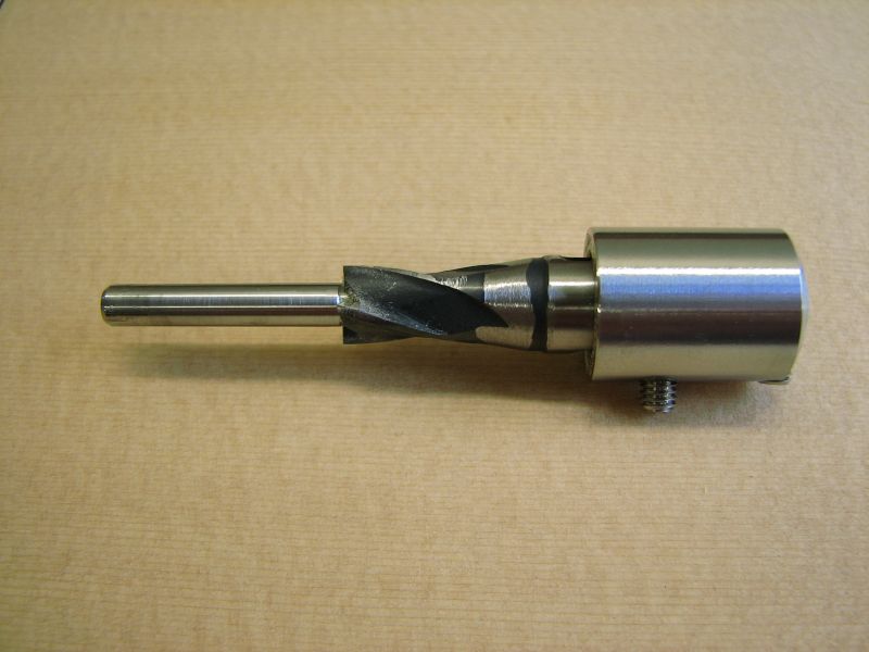

But in order to get the head of the screw 'hidden' in the transverse brace meant counterboring the 4mm hole I put through from the top to allow the screw to sit below the surface. Easy when I have the brace in my hand and seperate from the top but it was already in place! So I had to make up a counterbore tool that I could pull up from the top. Fortunately metalwork is what I do for a real job :wink: so I made an adaptor for a commercial counterbore cutter (black item in the pic).
and in use
Just ran the drill backwards and pulled up rather than pushing which felt strange as I'm so used to pushing to get things to cut! this cut the counterbore for the head to sit in so it was flush.
Just a few pics showing the neck shaped and glued in, the heel still needs a little shaping to "feel" right under my hand against the body.
Image Image
Image Image
Now I have the, nut, finish truss rod cover and the bridge to sort out and it will be ready for a coat of jam.

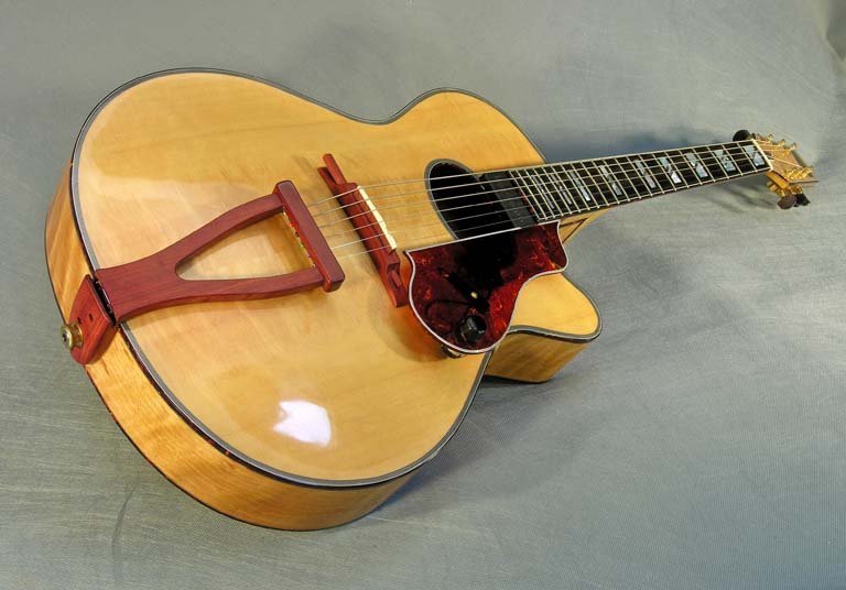

I was thinking of an adjustable bridge for this but didn't want to use the traditional thumbwheels Archtops use as this may 'thin' the tone somewhat, I liked the wedge style of adjustable bridge that is currently being used by a maker I cannot currently recall, but didn't want to copy him exactly (don't want to go breaking patents e.t.c :oops: ). Fortunately my copy of the latest GAL quarterly showed up and low & behold there was an article by Luis Mesquita showing how he did his wedge bridge, which was along a similar line I was thinking down so I may incorporate his system but with my own design aspect to it. I think (hope) my design will look abit 'sleeker' than Luis's design(no large thumbwheels)and plus it could avoid being accused of copying directly! :wink:

Post by John Steele » Wed Oct 21, 2009 2:16 pm
Looking great Nick. Ingenious counterbore. How did you attach the center finder to the cutter?

I drill holes in the neck block for my neck attachment after assembling the body and face the same counter bore issue as you. It looks much nicer looking through the sound hole if the flat head bolts are set into the neck block a bit.
I ended up finding part of a pen making kit from Woodcraft (read about it somewhere) which does that same thing as your bit but is not nearly as cool because I didn't make it myself.
Post by Nick » Wed Oct 21, 2009 6:27 pm
John, the counterbore has a 4mm hole up it's centre and is designed to have different sized pilots fitted. The large 'collar' on the end I made to fit the shank of the counterbore and has a 4mm hole up it's centre also. I just pre-drilled a 4.5mm clearance hole through the top and brace (in the right position!) and made my own pilot with a 4mm at one end (held into the collar with a grub screw onto the 4mm shaft) & a 4.5mm at the other, this then guided the counterbore concentric to the pre-drilled hole. Hope this made sense?

Post by Craig » Wed Oct 21, 2009 7:40 pm
Nick , I think the wedged bridge you're thinking of is Howard Klepper . I'll see if I can get a link . He once said it was his favorite playing guitar.

Craig wrote:Nick , I think the wedged bridge you're thinking of is Howard Klepper . I'll see if I can get a link . He once said it was his favorite playing guitar.
This guitar of yours is looking absolutley awesome Nick . Could you please just Stop,,,,,,, :lol:
Thanks Craig, I have seen the wedge bridge before & Howard Klepper rings a bell, the link would be much appreciated. As for your request, I'm afraid I can't stop :oops: I need to know how this damn thing sounds!
Posts: 1086
Location: N.S.W. in the bush
Post by Craig » Wed Oct 21, 2009 7:58 pm
Here ya go Nick . I had this pic on file as I was so impressed with it when I first saw it. Don't know if Howard invented it or what the story is . Give him a yell , he's been very helpful to me in the past.
Howard's bridge ,,,, way cool !! 8) 8)

Post by Arnt » Wed Oct 21, 2009 9:08 pm
I'm pretty sure Klepper didn't come up with the concept of the wedge bridge design originally, I have seen a number of 'contemporary' archtops that use variations of it. I believe D'aquisto was among, if not the first to use it. Brekke mandolin bridges use a slightly different wedge design, check out Webber mandolins, I don't know how something like that would work on a guitar.

Post by Lillian » Wed Oct 21, 2009 11:03 pm
John, you can pick up a reverse spot face cutter. No manufacturing necessary.
Post by Nick » Thu Oct 22, 2009 5:28 am
Thanks Craig an Arnt, gives me some more avenues to look down before finally 'nailing' the design.
Lillian, I didn't need to 'manufacture' mine, just did it because I can :lol: Although I was restricted by the room I had to work with inside the box so even a shop bought reverse spot facer would have had to undergo some Oliver surgery. :roll: :wink:
