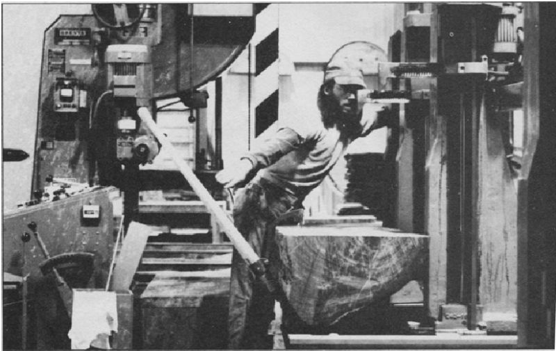

Check out the long hair on the operator. No OHS issues with that in those days. :D

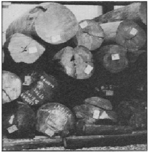

Back when Martin could still import whole logs, piled Indian rosewood logs awaited their turn at the band saw. The smaller logs in the foreground are ebony.
"Most of the time we bought logs at foreign government auctions," says Martin operations manager Joe Steinbach. "We would personally inspect them, and sometimes we'd even have a piece cut off to check the color, grade, and sap content. Through these personal inspections we kept waste resulting from bad logs down to perhaps two percent. Most of the time, by looking at the ends and looking down the length, we had a pretty good idea of what was in any log."

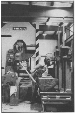

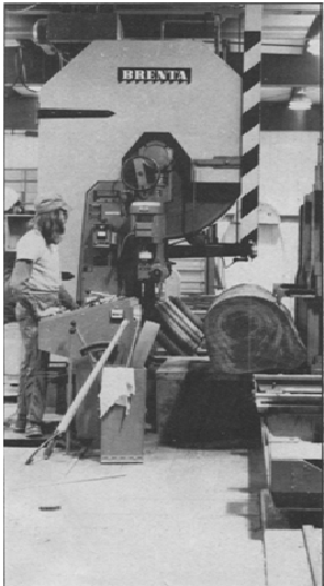

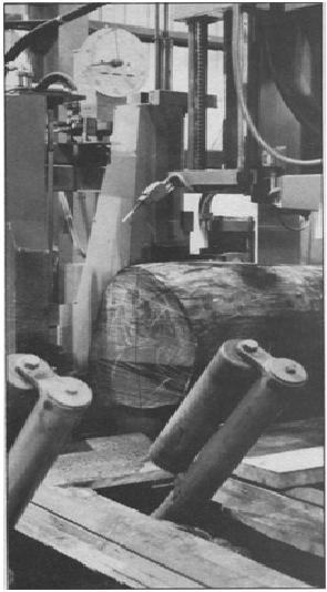

The operator of a mill's cutting saw is called a "sawyer." Martin uses a band saw in place of the traditional circular saw because (among other technical advantages) the "kerf," or total cut width, is less. The smaller cut leaves more wood and less sawdust.
Martin's saw is a precision tool. The logs are held in place with special clamps and the entire log-holding frame is moved laterally, directed from a set of controls on the sawyer's panel.

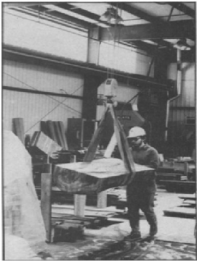

The "cant," or half-log, is carried back to the storage area with the aid of an electrically operated overhead crane.

The sawyer then rotates the log 90 degrees and positions it with the aid of a "cant hook," a wooden-handled bar with steel hooks
The precision capabilities built into the mill for its instrument-wood applications make it ideal for milling other varieties of fine lumber. Bill Hall and his assistant, sawyer John Ventin, can cut wood to tolerances within a tenth of a millimeter. The saw itself is a band saw, rather than the large circular saw usually associated with sawmills, because the band saw blade's narrower "kerf"(cutting width) creates less waste. The carriage that feeds logs and lumber into the blade is hydraulically operated and can handle logs weighing thousands of pounds as gingerly as a seamstress at a sewing machine would handle pieces of silk. An electrically operated over-head crane with a five-ton capacity transports logs from their storage piles to the saw carriage.

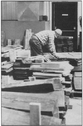

When the pieces have been sliced from the cant, they are inspected, numbered in pairs, and placed in Martin's kiln for seasoning.
