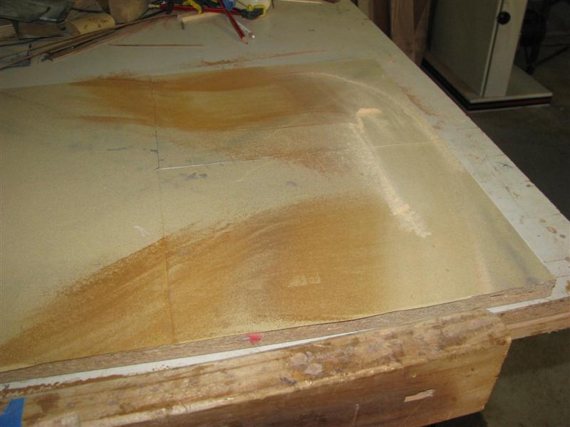

The top was joined using a Jet jointer. I then put some 3M Stickit sandpaper on to the bed of the jointer and make a couple of passes of the top on the sandpaper (which generally ensures a tight joint)
The Cocobolo is extremely oily and will clog up the paper on your drum sander in no time at all.
I keep a roll of 40 grit paper just for jobs like this. It will get your wood down to thickness reasonably quickly without clogging up like 80 grit does.
In this case I was thicknessing the sides which I wanted to end up at .080". I took them down to .095" with the 40 grit and then swapped to the 80 grit to end up with the dimensions that I wanted (which ended up around .081"-.082")

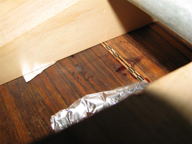

I used my now standard procedure for side bending, which is to sandwich the sides firstly in kraft paper, the spritz lightly with water and then wrap in aluminium foil.
Then heat the sides in the Fox bender, starting the lower bout bend when the temperature hits 100c. Then do the upper bout and finally screw it all down. Watching the thermometer allow it to reach 150c and them turn it off and allow to cool.
This Coco bent easily with very little springback.

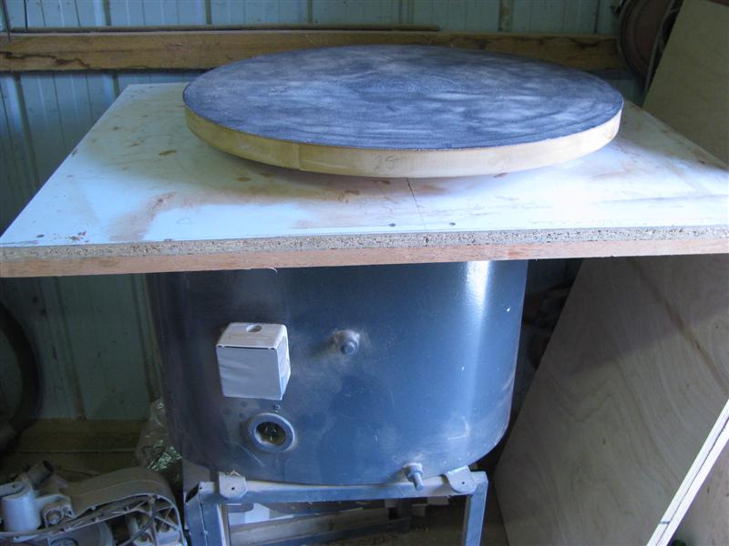

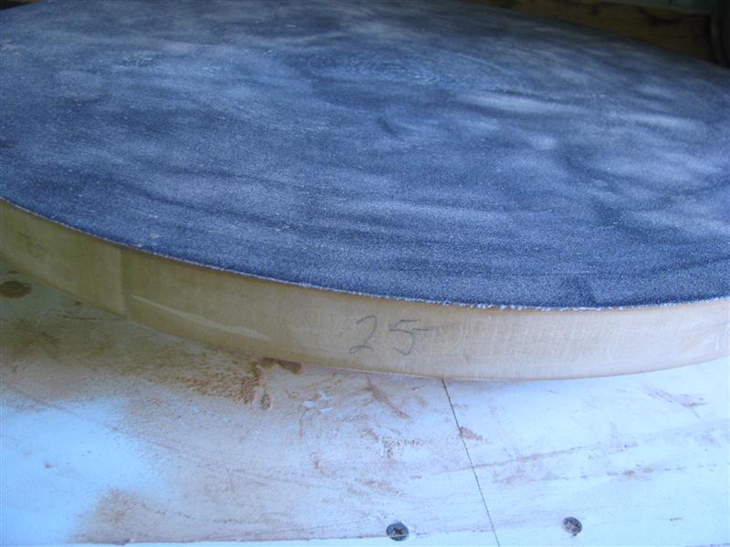

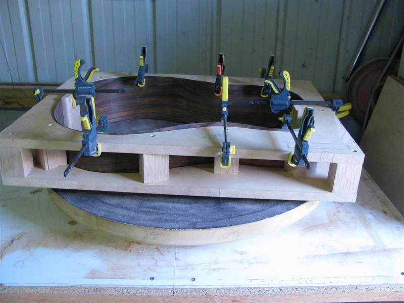

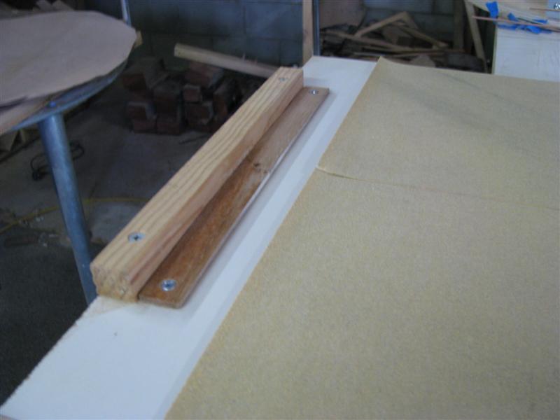

Next we need to put the sides into the mold and shape both the back and top with 15" radius for the back and 25" radius for the top.
We converted an old potters wheel.

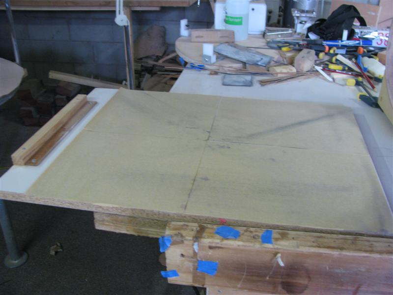

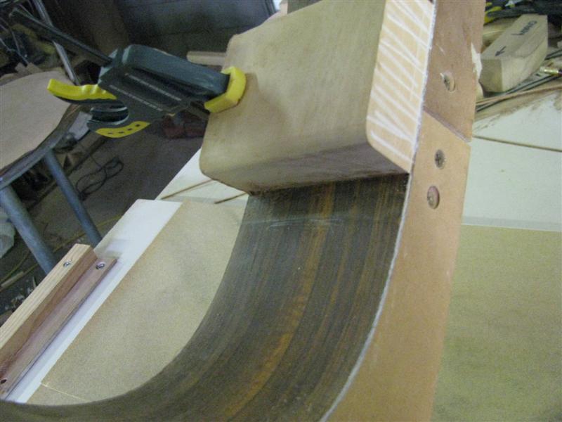

The next step is to flatten the upper bout so that the 2 degree neck angle fits properly and there's no 14th fret hump.
I built this jig to do the job. the tail block sits on a piece of wood 1/8" thick.

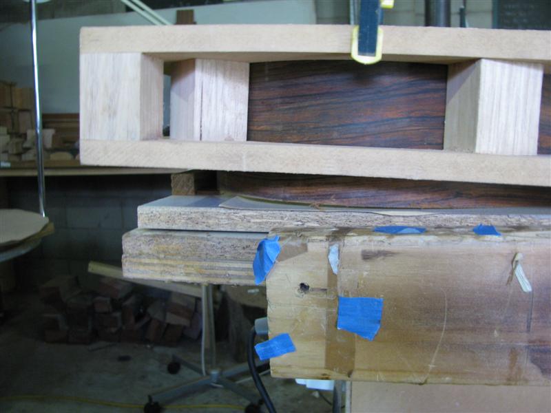

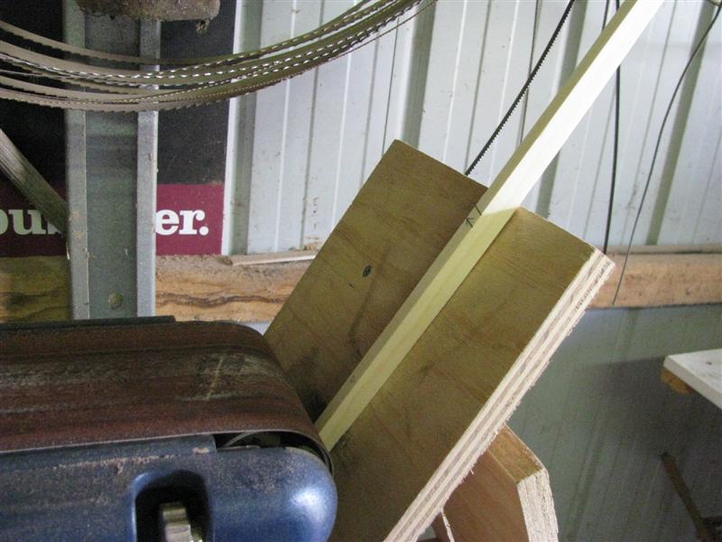

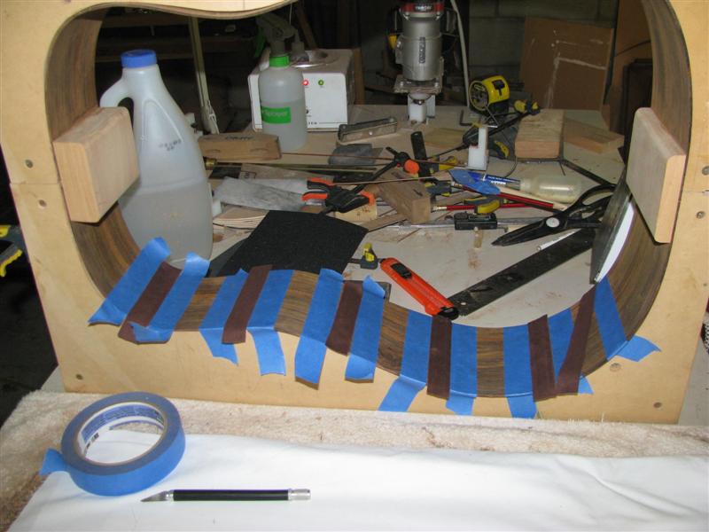

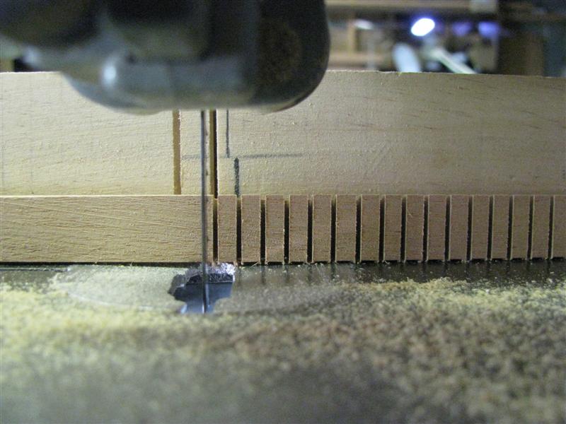

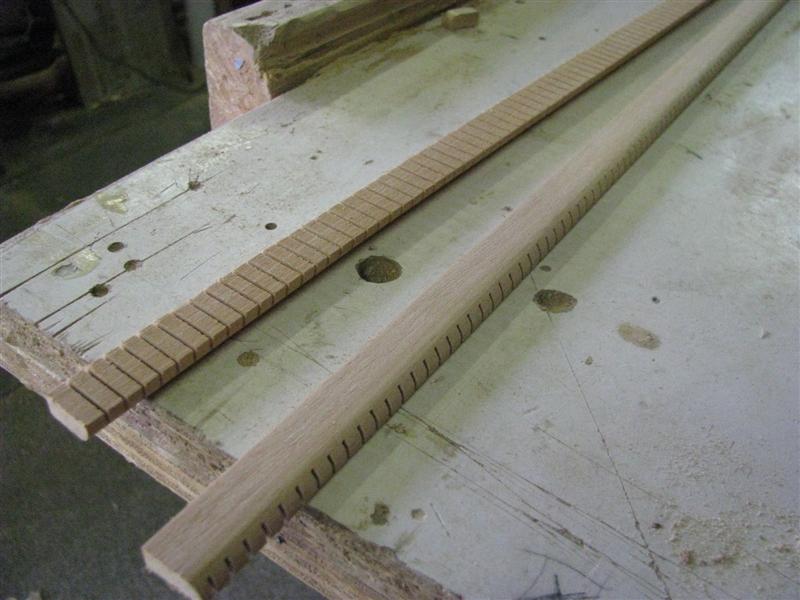

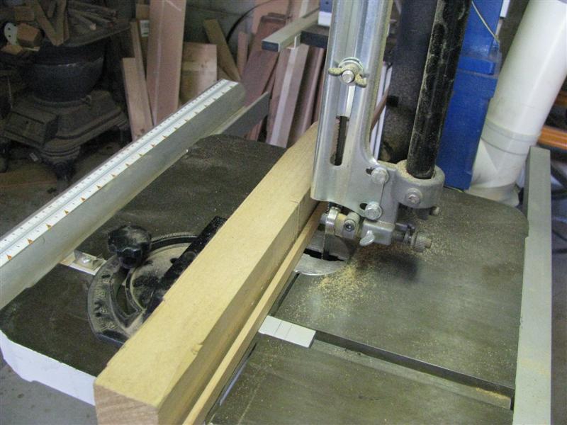

The next step is to install some cloth strips on the guitar sides to prevent the spreading of cracks in the event that the guitar gets a knock on the side. I haven't got the strips yet so I'll make the kerfed linings ready to be installed over the cloth strips.
This is a simple jig the sits on our small bandsaw. The depth of the kerf is varied by by adjust the upper blade guides back or forward and the cut is done by aligning the pencil mark up the the jig by eye. ie no indexing pin.

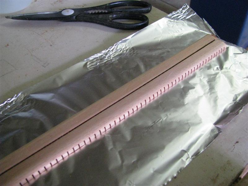

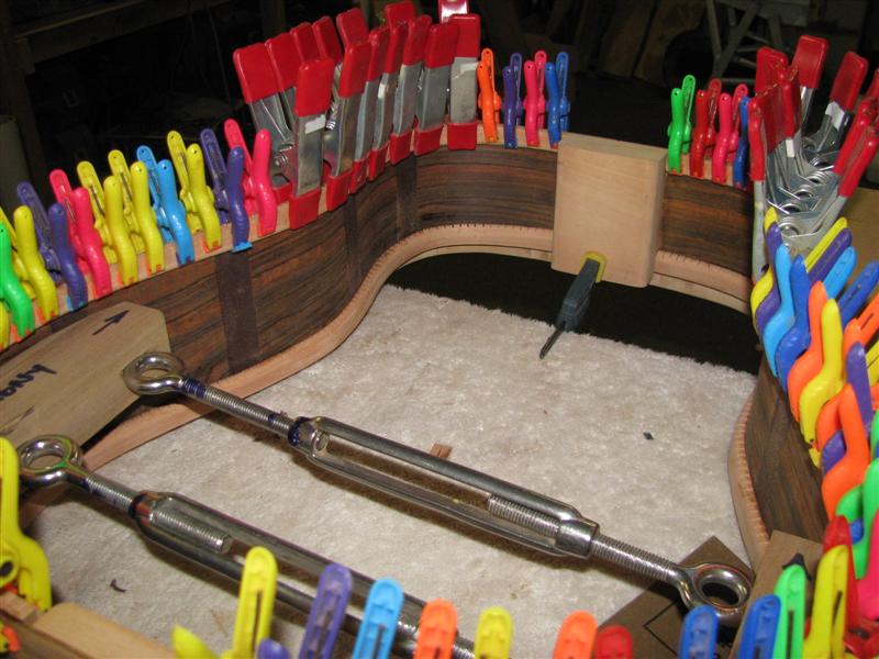

Today I took myself down to the local haberdashery shop to buy some bias binding. This is for reinforcing along the guitar sides to stop any cracks spreading further that they should.
Previously I've used wooden ones or in small instruments none at all but I thought I'd give the cloth a go considering that it doesn't weigh too much and the fact that the Cocobolo is bloody heavy.

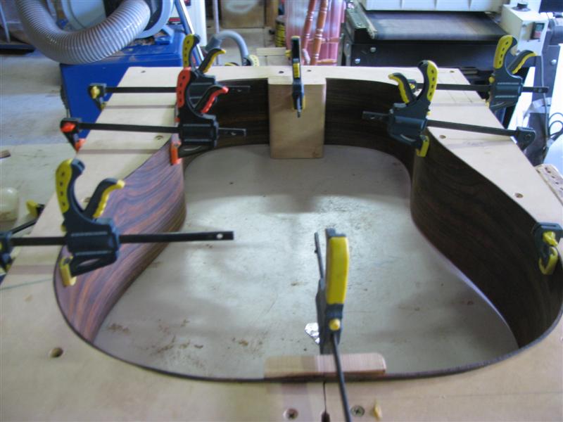

Next I throw the kerfed linings into the Fox bender not so much as to bend them but to heat them up and make them pliable. They'll get a spritz of water before they go in.
Once they're cooked ( I'll start bending them at 80 C and once the bend is completed turn the blanket off and leave for about 5 minutes.
While they're still warm I'll dry clamp them into the sides so they'll conform perfectly and also to allow them to dry out completely. (We've glued them before when they were still damp and the glue joint came apart.)
Once they're dry we'll glue them with Titebond and clamp.

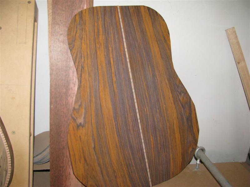

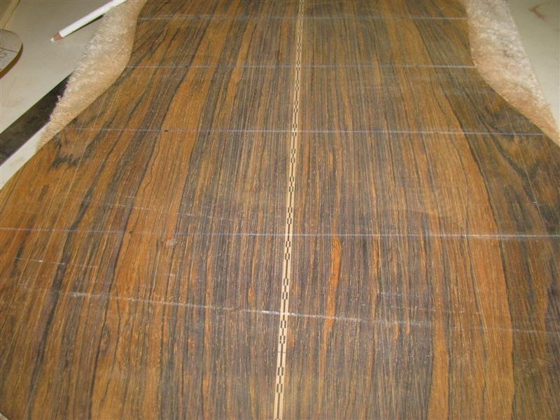

While all of this was going on the back plates were joined.
I took the liberty of throwing in a piece of decorative backstrip.
Allan, who'll be the new owner of this weapon was admiring a similar one in my Hondo Rosewood OM, plus I thought it may be better to glue the Coco to the Maple backstrip rather than Coco to Coco given the problems that a lot over people having glueing this wood.
I didn't wipe the joint with acetone or anything. Just glued the two back plates as soon as the joint had been done on the jointer.

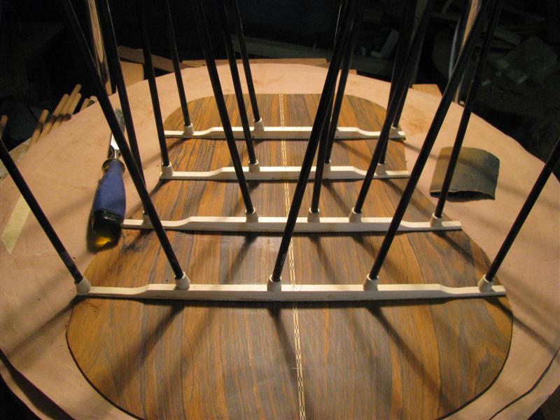

I took the back out of the clamps this morning and thicknessed it down to .090"
Then marked out the back brace positions. I know the bottom one looks way off but it's where I picked up one of the back braces and the chalk came off it.

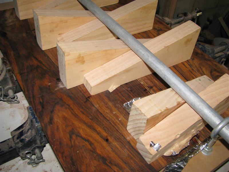

Radiused the back braces to 15". These are Engelmann Spruce and I cut most of the radius with the bandsaw before using the radius dish. The braces are 8mm wide. On smaller guitars I use 6mm.
I scallop out the ends of the back braces on the belt sander before glueing.
I used Hot Hide Glue for the back braces on this one. Normally I'd use Titebond but I thought I'd see how the HHG goes with Coco.
