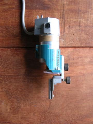

Post by Taffy Evans » Sun Nov 09, 2008 6:06 pm
Hi Jake

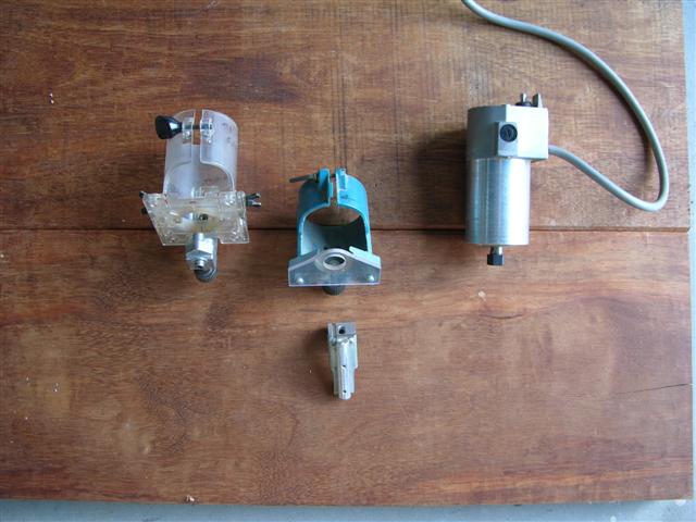

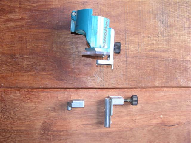

I always used to hate doing this job. Heres one of the ways I used to do it years ago.
Makita trimmer white base is standard size, blue base shows how I modified it so theres very little of the table on top of the guitar, so there it little interferance from the radius of the top or back plates.
To aid stability the standard [small] bearing guide was changed as shown so that there was more surface contact with the side. Still a worry though had to be on the ball, sides had to be true. I would also do as suggested by others previously, I used a purfling cutter and only used one blade.
