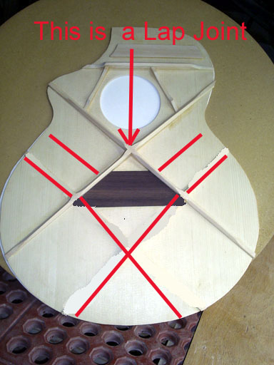

Josh,
Not that I have any qualification so take my suggestion for what it is worth. How about a double X brace top. Tuck the legs of the main X into the lining both at the upper and lower bout and have the secondary X positioned between the legs of the main X in the lower bout with it's upper legs running across the outer ends of the bridge plate and then tucking into the legs of the main X. That should hold up well to a belting, in fact it is how some of the early Maton's and Gibson's were braced.
Sort of Josh, that is one configuration that certainly may work OK. But I was thinking the secondary X could be tighter having the ends running "across or over the top of the very ends of the bridge plate and tucking "into" the main X a little closer to the lap joint and NOT following through to the linings.
Your image shows the upper legs of the secondary X spread at about 90deg and running right across the main X introducing two extra lap joints to the construction that I would be concerned may prove to be be week points...
