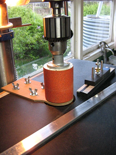

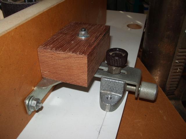

Here's my version of the Robo Sander . Made the bottom Robo part out of Myrtle ( Not Tiger
) Gives a bigger table than the Stewmac and saved a small fortune, although I did buy their slide vise pictured . The drum is wood which I've trued up ( I took off the original soft covering ,,,, rounded corners and all that ) It has a very clever and convenient sandpaper clamping system . Got it from Carbatec .
I don't often use the Robo system , but the drum sander gets a good work out . The drum can be lowered into a hole in the bench top when the Myrtle plate is removed.

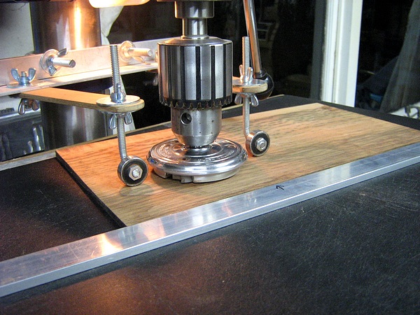

While I'm at it , Here's a pic. of my Saftey Planer set up. I find I don't use it much either, but is handy on reducing down the back of the headstocks , thicknessing bridge blanks etc. Those Myrtle slats give just the right amount of hold down flex
Hoping this may give you some ideas Sebastiaan

I must say I wondered why Robbie didnt have anything to hold timber down as it entered and exited the safetplaner on his video, I'll rewatch it and see what I can glean. I was thinking of a roller guide as well. Its good to know you can make it work with the bearings! Some of the timber I have is a bit challenging.

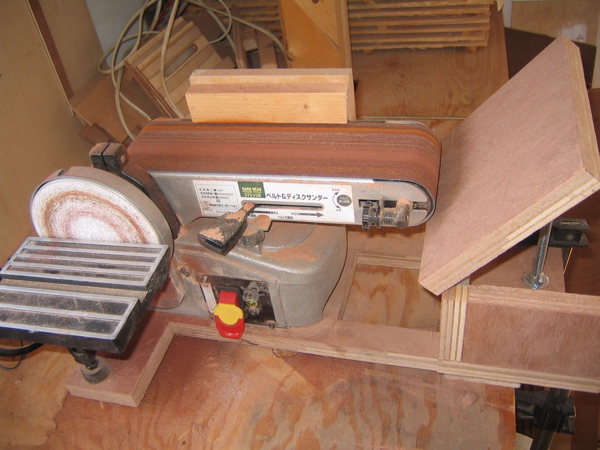

I've built pretty much the same set up for my belt sander after seeing some pictures of Bob's about a year ago. You'll find that using a longer belt rather than a small drum, you'll get less glazing of the paper, because it runs cooler. I can hardly do any work with the sanding drum in my drill press, but there are some jobs that it is the best tool in the shop.
It does bridges, back of head stocks and numerous other small pieces really well. The thing that I like about it is that it's really easy to put that curve in the transition from one thickness to the other like you see on bridges.
I think that trying to do backs and sides would be more than this design could handle. But maybe there is some clever bugger out there that can make it work.

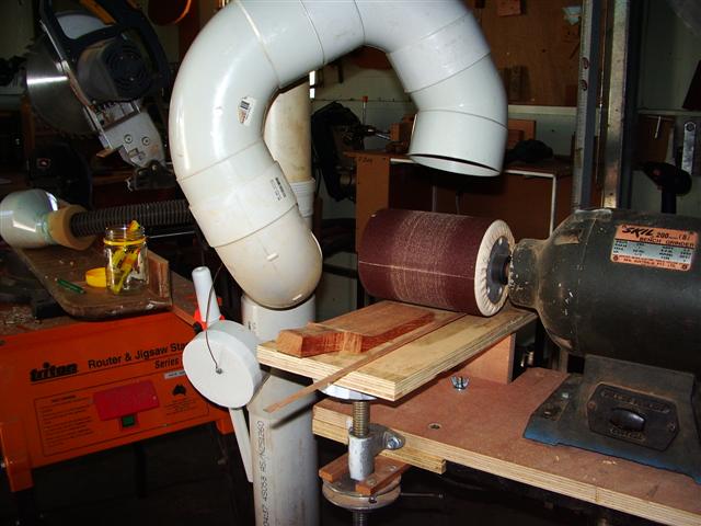

I agree with Allen's comments and do use the belt sander for shaping, however at times there is a need for a different way to do things and here are a few of mine.
The newest idea is a couple of years old, the mini drum sander, the other drill press sander I've been using for over twenty years [it's got a modern drum here]. The micro adjustment for the fence is from a Makita router, I keep all machine parts for recycling. However it's there if I need it now, at one time it was all I had
I've also shown the original drum I got made up, close on 30 years ago. It fitted into a hand drill on one end and your hand on the other, later when I got a drill press it fitted into that, never gets used now.
I then built a horizontal drum sander that I used for 15-20 years, now I have a proffessional thickness sander with power feed ect.
