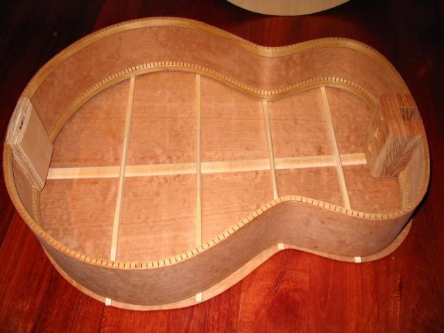

And while I try to stop whining about it, I'll post a couple pix of my latest - #5.
An OLF SJ, b&s blistered Sapele from Don Williams when he was New England Tonewoods (matching boards to the stuff you got of Don, Heshtone).
The top is Lutz from Mario via Barry at Woodtone Guitars.

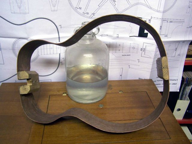

The linings and neck block are New Guinea Rosewood (Narra) 'cause I had some and I want to hear what happens when you use woods with a high 'Q' value instead of woods that tend to dampen tone. This stuff really rings...
The tail block is Fijian plantation mahogany plywood, which looks really crap with that void in it, but it'll do the job.
Back braces are Adi.
Rims sitting on the braced back.

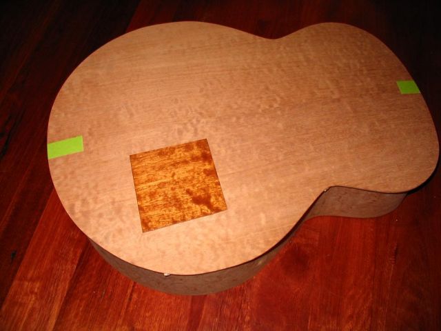

Blistered Sapele, the little square is an off-cut from the sides that I threw a bit of shellac on to see what I'd see.
All the bits and pieces.
Oh, and this is the first guitar that I've used hot hide glue on. Man, I don't know what I was stressing about - I love this stuff!

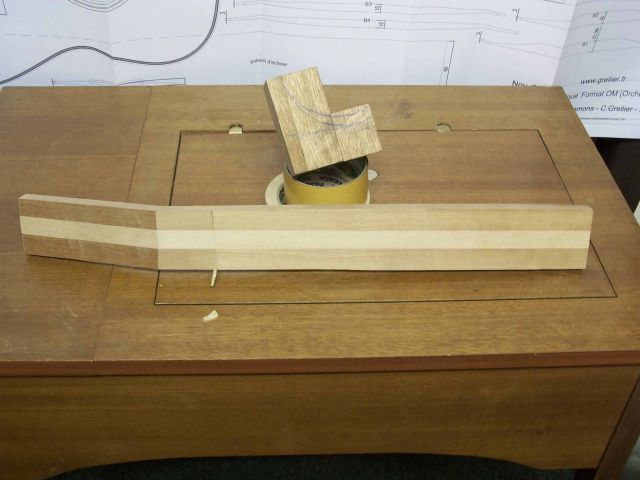

Hi John,
Looks like youre making some progress there.
Just one thing....I may be seeing things but that scarf joint on that neck doesnt look quite right. On my scarf jointed headstocks the cut is angled the opposite way to what youve done..... ie the joint appears on the headstock and is covered by the headstock veneer.
What do the rest of you guys think?

John, the first neck I put together as a practice exercise I did the same thing you did. I can't remember if I read it in Campiano's book or if it was pointed out to me by someone at MIMF, but gluing it up this way could lead to a possible hump under the fretboard that could react to humidity changes. Maybe and possible. If you can get the joint apart with heat, I'd flip it and reglue it. I was going to be using mine for kindling any way so I wasn't worried about it.
Your 5th is looking great Paul. That Sapele is gorgeous. I really like it.

Yes guys didn't know at the time I'd made the mistake with the neck, but it's gonna stay that way now as it works and I haven't the length to undo it and swap it round. Should of added a big thanks to Joel Thompson who helped me voice the bracing.
Just another mistake to remember not to do in number 2!

Hi John, go and look at any Ibanez electric (and probably many brand name acoustics as well), they all have the neck like you have done.
I am sure Martin won't mind me saying that you have not made a mistake as such, you have just done it differently.
One reason i have heard not to do it like you have done is that over time (a long time) the joint can creep and put a slight hump under the fingerboard and this effects playability. But if its good enough for Ibanez why should you worry.

There are also asthetic reasons why I do my scarf joint differently from the way John's done his. IMO it looks neater having the joint visible over the nut/headstock section of the neck rather than further down the neck. On a classical the side plate on the tuners neatly cover the splice and its not really noticeable at all.
As for Ibanez guitars...I tend to aspire to make something a little better when I make my instruments. The Ibanez's I see in the shops of late arent that great and theyre factory built which means time spent making sure that joints look tidy gets sacrificed for speed of construction.

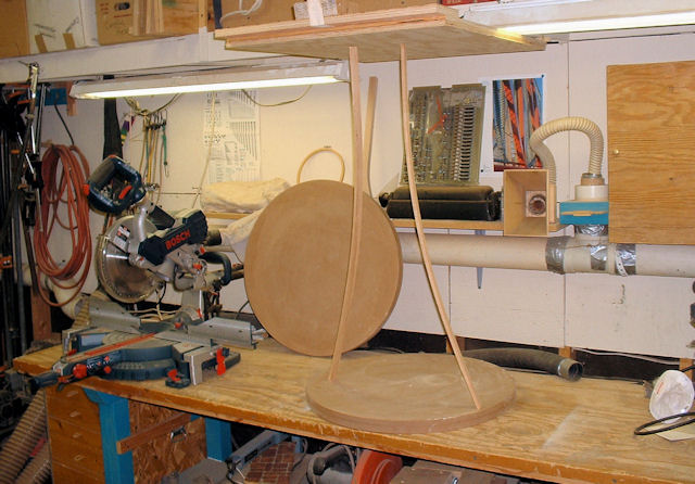

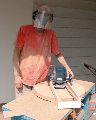

Allen warned me about the great amount of dust created in making the radius dishes. Guess what? He was spot on.

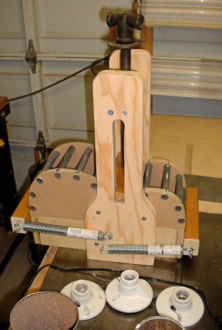

This bender is the size of a size 5 Martin. I may use lightbulbs or I may buy a silicone blanket. As yet to be determined.

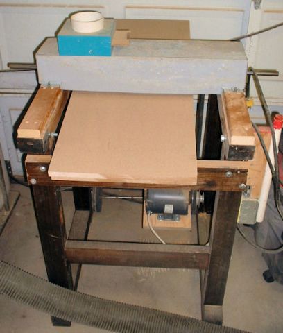

My drum sander was made mostly from material I had laying around the shop. The washing machine motor will probably need to be replaced after it boggs down enough times to motivate me to buy a different motor. The stand was an old workbench from my father's shop that was collecting dust and wasting space where it was.

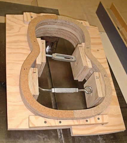

This guitar mold speaks for itself.
