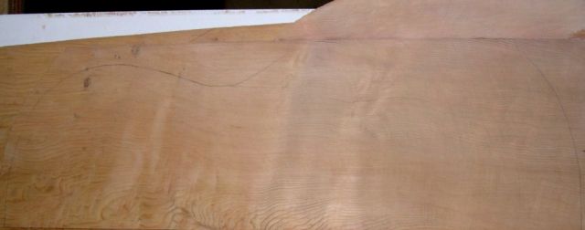

I’ve been tempted to stray from tradition in the one area I didn’t think I was ever likely to do so, the soundboard. I recently threw in an impulse bid on some King William Pine that Barry was selling on ebay and ended up getting it. I didn’t really have any plan for using it except for maybe as an interesting soundboard on a harp. But when I unwrapped it I was instantly enamoured by both the look and feel of it, so decided to glue on a couple of wings to get the width I need to and give it a go on the Huon pine flamenco I’m working on. The grain isn’t very straight but is well enough quartered on the main working part of the top so I’m not too concerned.

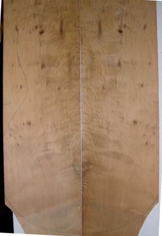

This got me to wondering how far you could go using less than well quartered top woods with the odd flaw (or fifty). I’m very tempted to use the offcuts from the more figured part of the boards on a little steel string.
The question is how much would it hurt the sound to do so???
Couple of pics… Top is half the top for the flamenco and below is the bit I’m thinking about using for a small steel string.
P.S. The strange little knots are totally sound and not much harder than the timber.

Dunno mate..there are some pretty healthy looking knots happening.
Ive got some Huon in my shop but its cut on the quarter and knot free.
Give it a go if youve got nothing else planned for the wood and you never know you might get a surprise.

straying from quarter sawn will loose you stiffness first and formost which would mean you would have to use a thicker top which would defeat the purpose of using lightweight stiff wood for the top.
the top is under so much presure you need as much strength and stability as possable anything, other than quarter sawn wood will cuase real problems.
have you held a spruce top that has even grain spacing and is perfectly quarter sawn for the first half and runs just a little (say 2 degrees) off quarter for the rest of the top.
The off quarter side will be noticable floppy compared to the perfect quartered side.
in soft wood tops its very impotant impotant that the wood be as close to bang on quarter as poss or you will loose stiffness.
i dont know about aussy woods but i wuld presume its the same principle.
as for hardwoods again stiffness is an issue but you will get uneven bellying if you your top runs off the quarter at the edges due to uneaven stresses in the wood.

If it were me I'd use it for a steel string and use it as an interesting learning exercise in using all the other elements of instrument design to coax out the best sound from a less than "conventionally perfect" top. There are lots of ways that you can bring stiffness back to a floppy top (now there's a potential new Aussie euphamism :D ). Extra thickness - especially in the centre - is not all bad news, especially if you like good mids and trebles. Put more arching into the top than you usually would for example.
Then make one with a perfectly quartersawn top and see how much better you can make the sound.
Doing things differently from conventional wisdom will usually give you one of two results - a confirmation of the wisdom, or interesting discoveries that take your building into new and interesting areas.

A couple of things to consider. King Billy is not spruce, and has to be used quite differently. I would add 20-25% in thickness to what you would use for a similar spruce soundboard, unless you are going the lattice/carbonfiber route. A too-thin King Billy soundboard will just sound tubby. Thickness it to 3mm and compare the tap to a 2-2.5mm spruce top. That will give you some reference point and help your decisions about whether to continue with it. If it is roughly in the same range that will suggest that you can do with it what you might do with a spruce top. If not, perhaps some rethinking.
The swirly grain may or may not be a problem, but it will make it fun cutting the rosette groove. :) I think you will want a Dremel or other router setup.
At worst, you can always remove the top and replace it. Don't be seduced by all the waffle that gets written about having to have the perfect materials for every instrument. Very good instruments can be made with what often gets dismissed as inferior A or AA grade timber and having an understanding of the material. It doesn't have to be AAAA grade wood. I suspect there are lots of guitars being made out there with really choice materials that are little more than good carpentry.

Back to the King William Pine… I only build for fun so tapping the timber isn’t probably the best option for me (still haven’t penetrated the mystery of tap tone). I’ve taken a bit of WRC, Sitka and a bit of both the quartered and non-quartered KBP down to about 3.5mm to compare stiffness across and along the grain.
Just going by feel (no science involved) the quartered KBP is about a third stiffer across the grain than the non-quartered but the non-quartered seems a little stiffer along the grain. As is to be expected the bits of KBP are far stiffer across the grain than the WRC (which is like a wet noodle). Doesn’t seem to be much difference in stiffness between the WRC and KBP along the grain. The spruce and KBP are much closer, the quartered KBP is a little easier to flex along the grain and a little stiffer across it. The non-quartered is very close to the sitka in both directions. When I tap a half top of each that are about the same size, the WRC is quieter with more ring than the sitka and the KBP falls somewhere in the middle (and none of them come close to lovely sound from tapping a bit of quartered Aust Red Cedar). I’ll try and find some time over the weekend to do something a bit more scientific.
