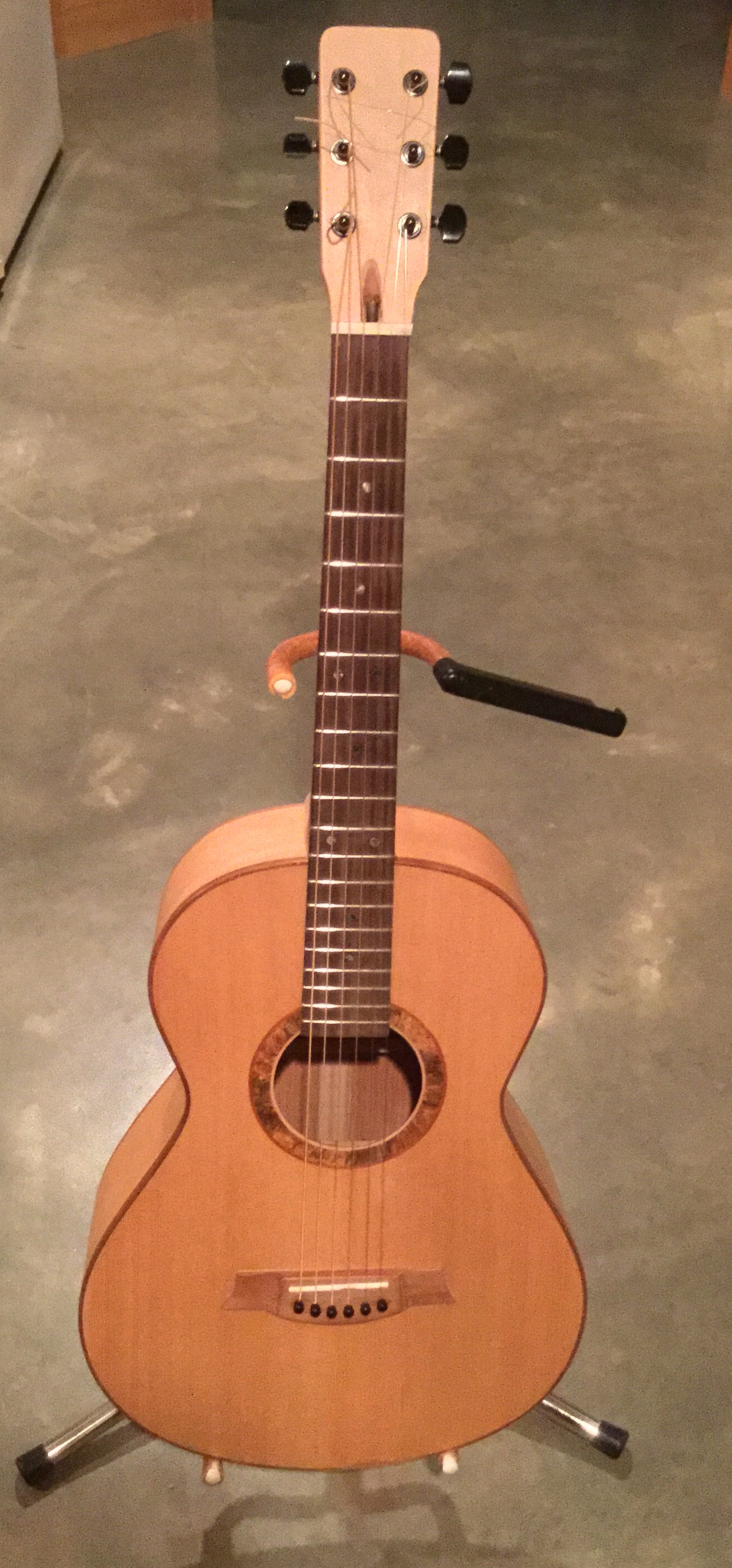

I'd like to thank you both for this thread, it's perfect for me, and I appreciate Mark summarizing his experience, and years of forum discussions.
I thought I would contribute, but with the caveat that I'm only 5 guitars in myself, and I'm really interested in experimenting and pushing boundaries. Because these guitars won't be marketed, I'm quite comfortable with failures.
I just completed this guitar, in fact it's only been strung up for a few weeks now, and since I finish my necks separately, I'm still working on the final shape.
It is similar in size to the Froggy Bottom guitar, Body length 19 3/8", width 13 3/4", depth 4 1/2". The top, back, and sides are all Douglas Fir.
The neck is Sapele, the bridge is Arbutus. Bridge plate is Rosewood, braces are Engleman spruce, not let in to the linings, , and linings are kerfed Sapele. Scale length 25.4". Top thickness 2.3 mm. It has K&K pure piezos in it and sounds great amplified.
It has a huge balanced voice for its size, which has been getting nothing but better as the weeks tick by.
I have seen videos of guitars like this, and was always impressed with the voice, so I just drafted one up, and built it, deciding that I would keep it very simple.
Here are a couple of photos.
What would I do differently? Well I really miss the 14 fret neck, otherwise not much.
