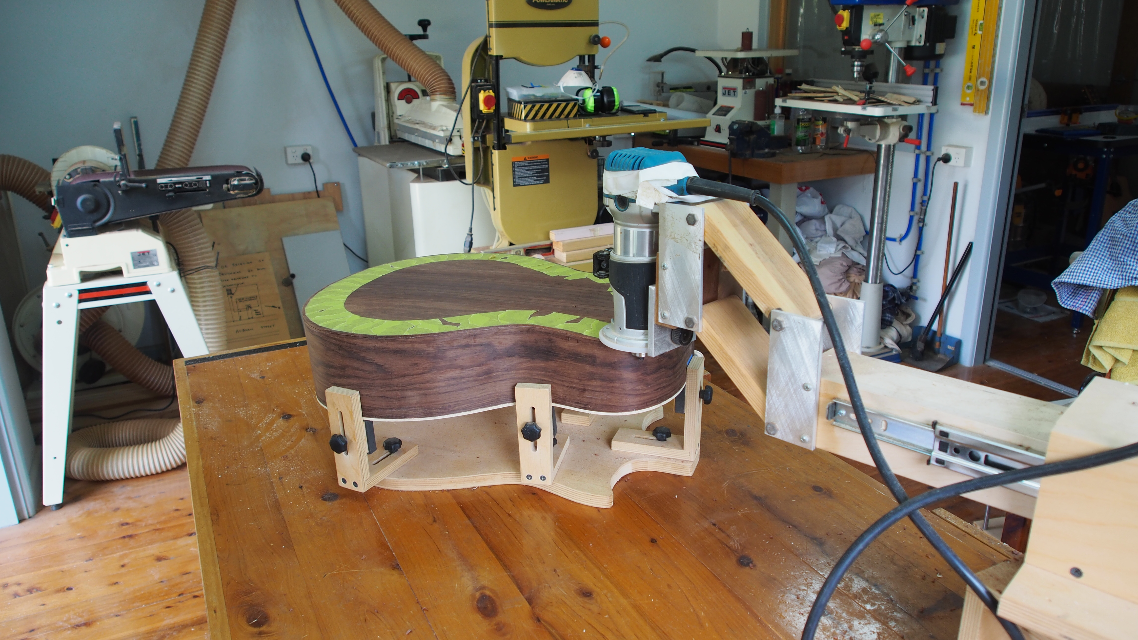

I'm continuing to push ahead with the build. Routed the remainder of the outside of the body. Unfortunately I got another tear out on that same corner despite doing a climb cut. I'm now suspecting there must've been some defect that I couldn't see with the naked eye on that area because all of the rest of the body came out ok. Next weekend I'll make up an epoxy sawdust mix to fill those spots and then clean up the corner. I also routed the access for the electronics. Getting closer to gluing the top on.
I also finished the truss rod routing jig. Just need to get some longer bolts as the ones I got are too short.
I'll also need to locate another bridge because the cheap one off eBay had the pickup hole cut at the wrong angle which threw everything out of alignment. I could've modified the body for it to fit but I didn't want to cut a weird shaped bridge pickup cavity just so this bridge would work and risk not being able to swap components in the future.
