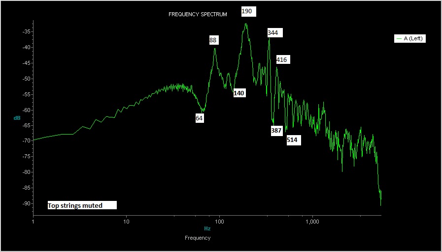

Some tap test info would be helpful Simon.

I don't have the guitar back yet so I can't make nice new pictures however I dug this one out. Any hints from that?
Thanks guys.
Edit 1.
added some note values for peaks.
88 F1 (87.3)
190 between F#3 and G3 (185 & 196)
344 a bit below F4 (E4 329 F4 349)
416 G#4 (415.3)
My tester was very accurate in assessing the fundamental. :-) I would not hear that.
Edit 2.
For what it is worth, the guitar is based in general terms on the 1912 Ramirez plan and the Santos Hernandez in in the Courtnall book. I wouldn't go so far as to call it a copy but that is the direction.
