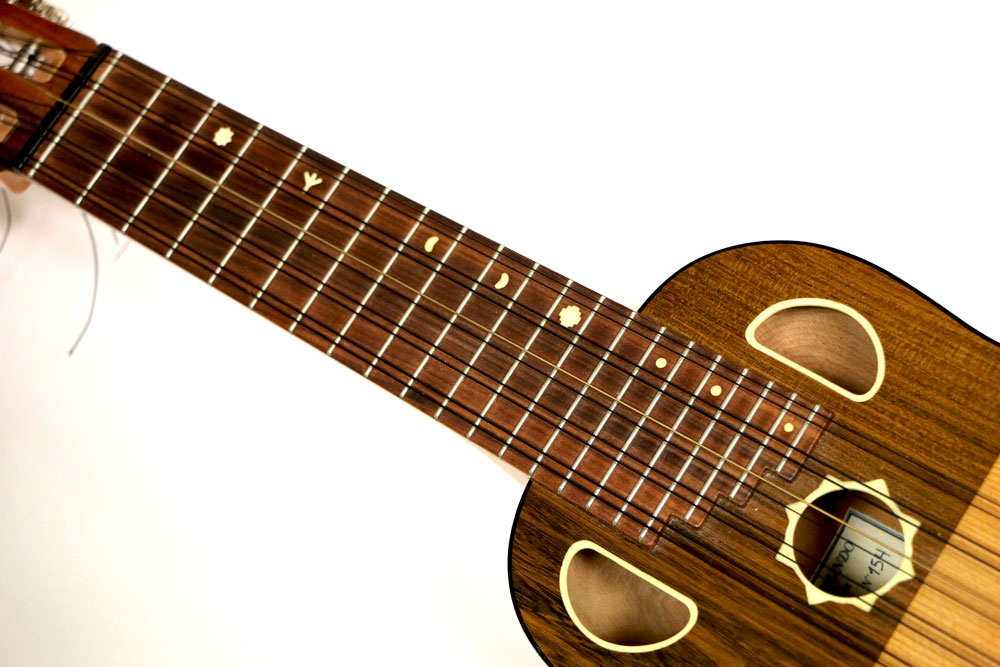

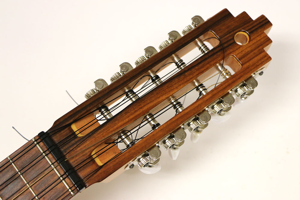

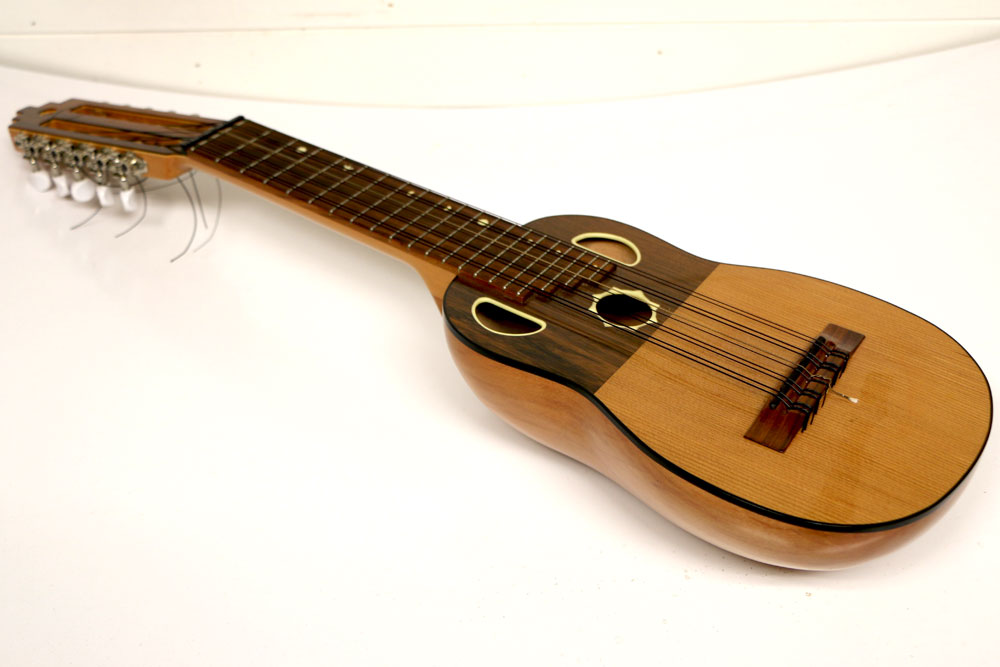

Just had a Charango come into my possession for a short period. A friend of mine owns and plays it, however has elected not to take it overseas on travel, so he left it in my hands instead. Foolish man! It's already been photographed and beaten all over with a rubber ball mallet! :P
Seriously though, I've never had the opportunity to look at one of these close up. This is no factory made Charango either (should such a thing exist), but a nice custom made instrument from Argentina, by a known Charango luthier, that does not, it ought be mentioned, use Armadillo shells.
I thought while it was in my possession, I'd take records of everything about it for the broader benefit of all - especially those whom may take on such a project. So I'll start with the photos and a tapped spectrum analysis. Of course, no reference points for comparison on the latter... Unless Markus has taken any?

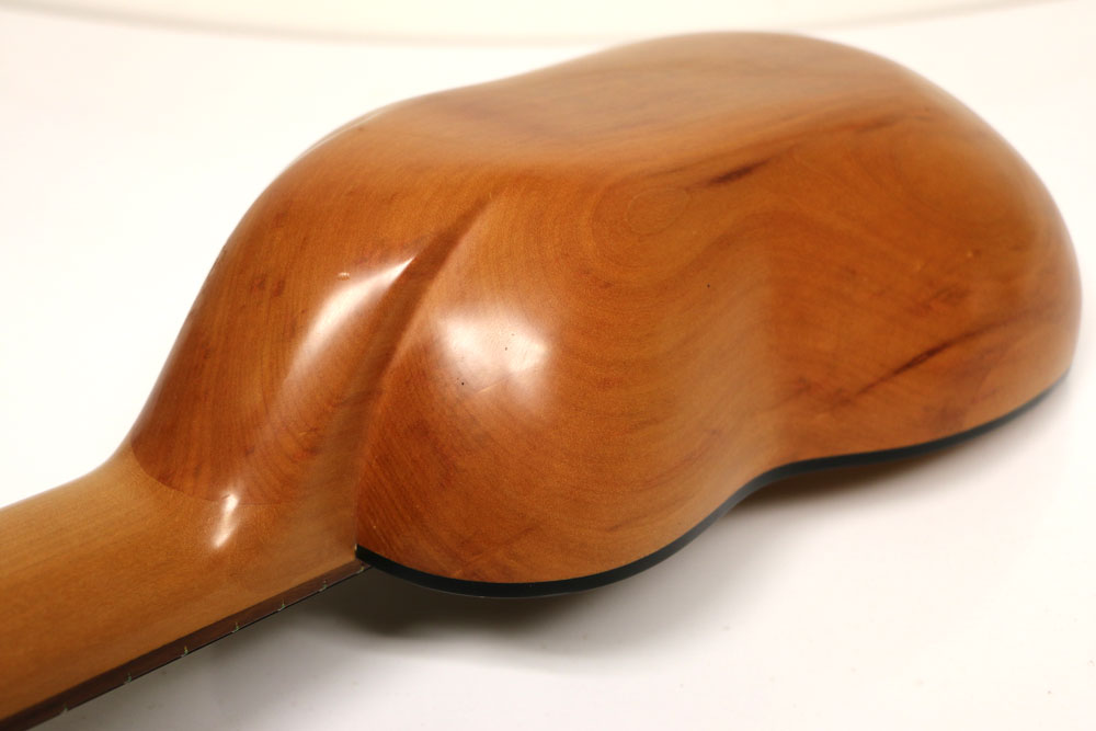

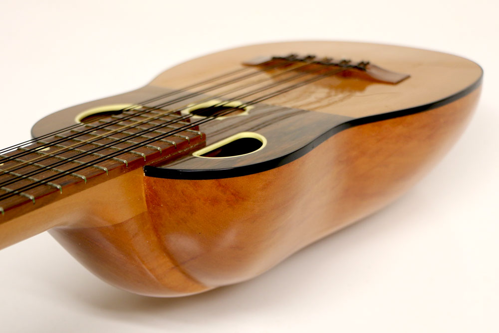

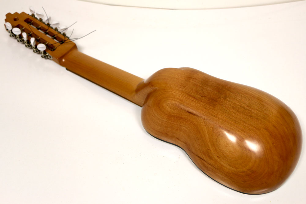

The back is carved from one solid piece of timber, as you can see. A rebate has been routed for the neck to glue in to - the "heel" is part of the body blank. Not sure what thickness that back has been carved down to, as I don't possess one of those fancy ball digital thickness gauge doobewhackers.

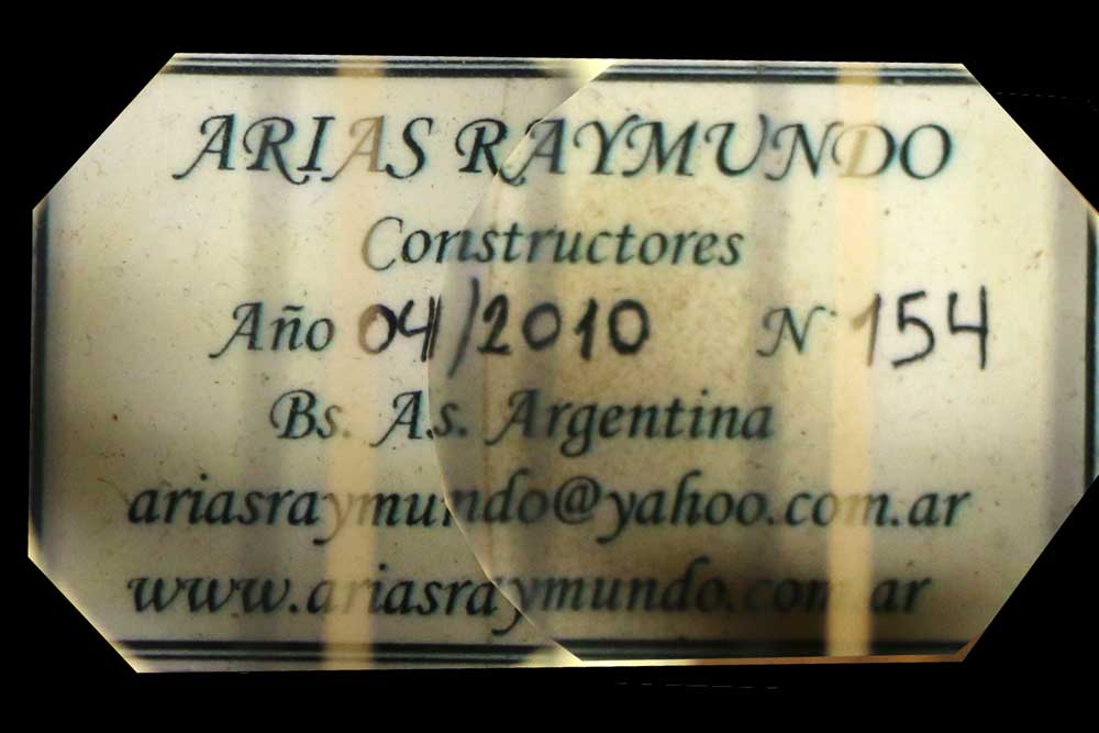

And here is the label, poorly stitched together from two images as my camera could not get all the label in one shot, through the soundhole.

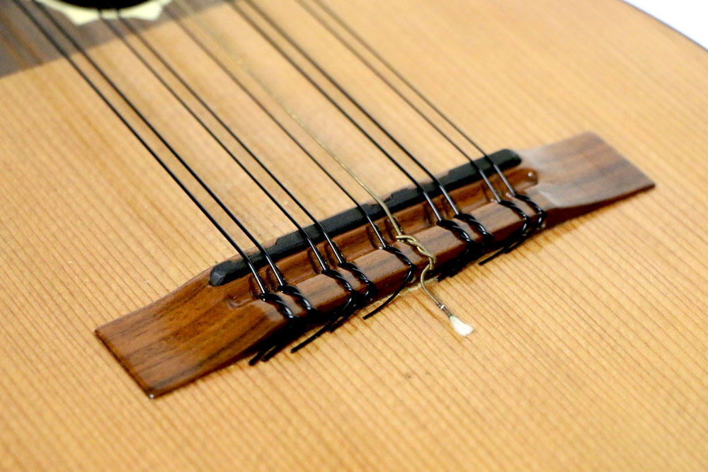

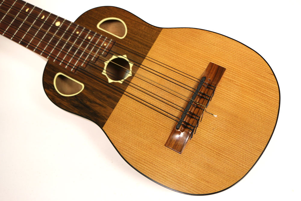

It has a nice low action and is very easy to play, though there is noticeable bridge rotation going on - deliberate? Not sure. There is certainly a notable belly now. In any case, with no reference point, it sounds great to my ears - particularly when my friend plays it rather than me!

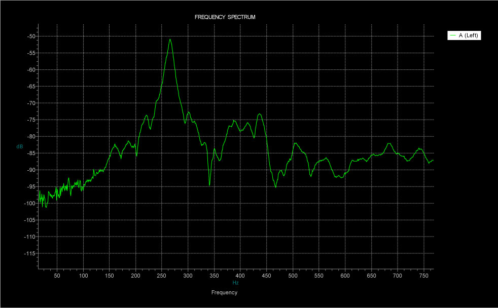

Here is the spectrum I got -

J.F. Custom wrote: Not sure what thickness that back has been carved down to, as I don't possess one of those fancy ball digital thickness gauge doobewhackers.
You just need two rare earth magnets (about 8 mm diameter, 3 mm thick will be fine) and a spring scale that goes up to about 0.5 kg (or tweak a cheap spring scale as I did once I was in Peru). All you have to do then is measuring some reference thicknesses, transfer the values to a graph paper, connect the points with a smooth curve, and you are ready to go.
J.F. Custom wrote:It has a nice low action and is very easy to play, though there is noticeable bridge rotation going on - deliberate? Not sure. There is certainly a notable belly now.
Generally charango builders just hope it will be fine, and if it won't be fine they hope the owner will not be too picky. :lol:

Peak at about 260Hz would be main top frequency. But no Helmholtz peak????

kiwigeo wrote:Peak at about 260Hz would be main top frequency. But no Helmholtz peak????
That looks like the air resonance.
These are the spectrograms with opened and closed soundhole for this armadillo charango from which I made a plan:
