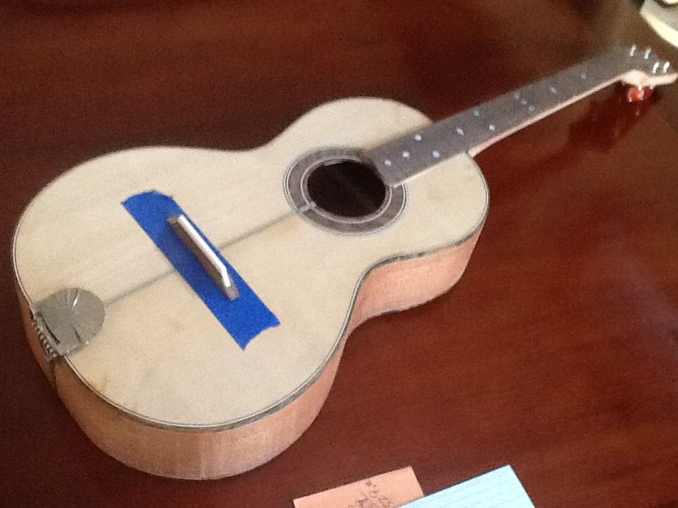

Re: Tenor Guitar help
Allen, I don't really know yet, as it's not finished.
But, having always read that his plans are over-braced, I've reduced the dimensions a bit, and as is(photo), it has a nice sound tapping the top and back. Nice separation between the two, and a mellow tone from the top, which is huon pine. Another experiment...
It is all ladder braced, with the lower bout basically having two 3mm spruce braces, so really just holding it together, I think....
Gonna fret it this weekend and string it up before finishing. If it sucks, there's no reason to continue, hey?
I think it'll sound OK at this point. Will let you guys know how it goes over the weekend....
Also, I think that the string tension is so low, at this scale, that one could forego a truss rod, or just make a one-way that would do the job easily enough....I was worried about it being neck heavy with a two way, but I think it's OK.
Happy to give any dimensions from the plans for those interested.....
