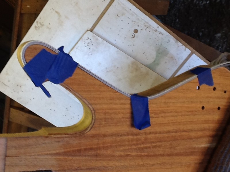

I've got a project going on that I intend to use pearl celluloid binding with a multi-ply BWBWBWB purfling. Not because I want that much, but, because I had a slip with the router and needed that much to cover the gouge.
Here's a look. My issue is that it's a massive task to try and get them all in at once.
I'm thinking of gluing in the binding first, and then filling in the purfling lines, in the way Chris Paulick did in his tute on the ablam he showed us.
Has anyone done this? and if so, is there any advice? My inclination is to do the binding first, and then feed the purfs into a bed of cement....
Thanks. I'm hoping to figure this out, as I bought a couple hundred black and a couple hundred white purfling strips, and would hate to use them as tooth floss...... :oops:

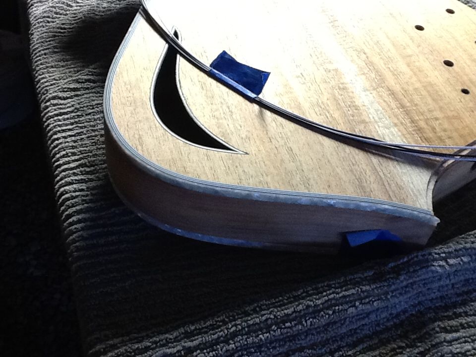

OK, first side went well doing the binding first, then feeding the purfling into the channel left by the teflon strips. For the other side, I tried all of it together. Also went pretty well, but I did "lose" a purfling line here and there. It'll do for now.....
Funny how well the mitre fit together when there was no glue involved. Fit beautiofully in fact. As soon as glue was introduced into the equation, thjings went a little off. I'm happy enough with it for a first effort, so I'll leave that too....
The tiny plastic purfling is quite a challenge to manoeuvre. Wood at least sort of sticks together. This stuff simply flies apart. I hope to get the hang of it, because I think it's a great look..
Couple pix....
