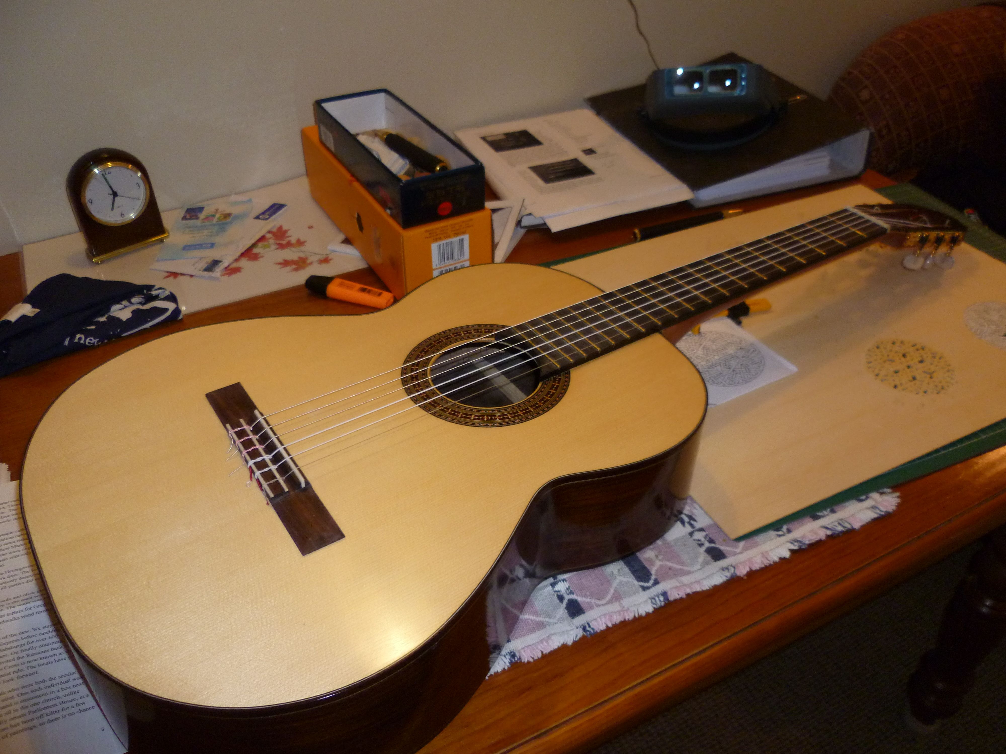

Post by kiwigeo » Fri Dec 17, 2010 7:48 pm

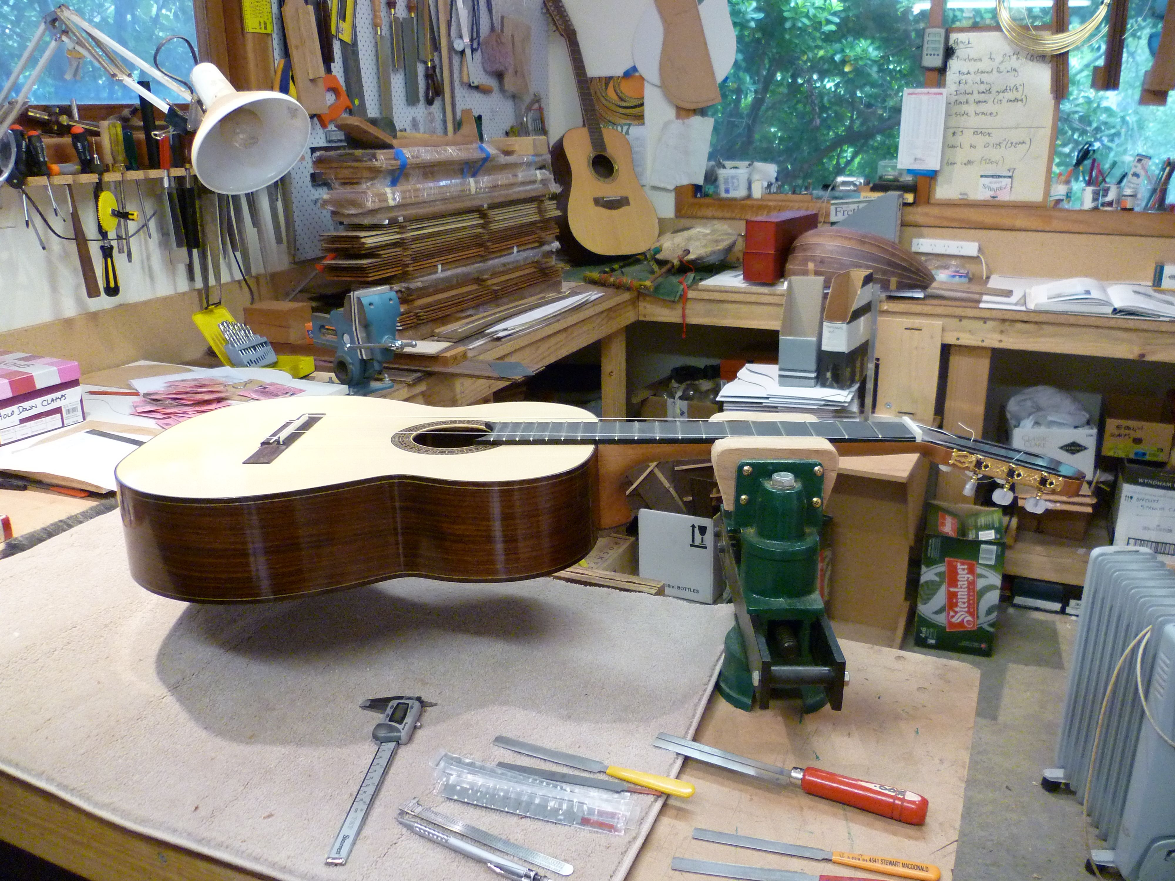

Today's Geologists lunch ended early so I came home and spent a bit of time in the shop getting the classical setup and the strings on. 13th fret is a bit high so she's sounding a bit buzzy. In the bottom photo you can see my new pattern makers vice in action...very handy indeed.

Never mind the vise. Hows the box of Steinlager on the floor? I love that beer. :D
Re: Classical - strung up.
Post by kiwigeo » Fri Dec 17, 2010 8:14 pm
Allen wrote:Never mind the vise. Hows the box of Steinlager on the floor? I love that beer. :D
The beer is long gone mate but there a couple of full cartons on the spare room ready for Steinie loving visitors like yourself.

So Ive got a buzz on one of the strings (5th and 4th) so I start checking for high frets...and find a few and file 'em down. Buzzing seems to get worse. I check the nut and saddle (should do this first)....both ok. Checked string height at first fret.....ok. I immediately had thoughts of the neck relief being out. Layed a straight edge along the neck and verified a slight positive relief as is normal on a classical. I left the guitar overnight and spent a few hours thinking about what might be going on.
The next day I decide to check the action at 12th fret.........shockingly low on the bass side. I'd done a sloppy job on the saddle. I whacked in a new saddle and set action at 4mm on the bass side and 2.5mm on the treble side.......no more buzzes.
A lesson learned.

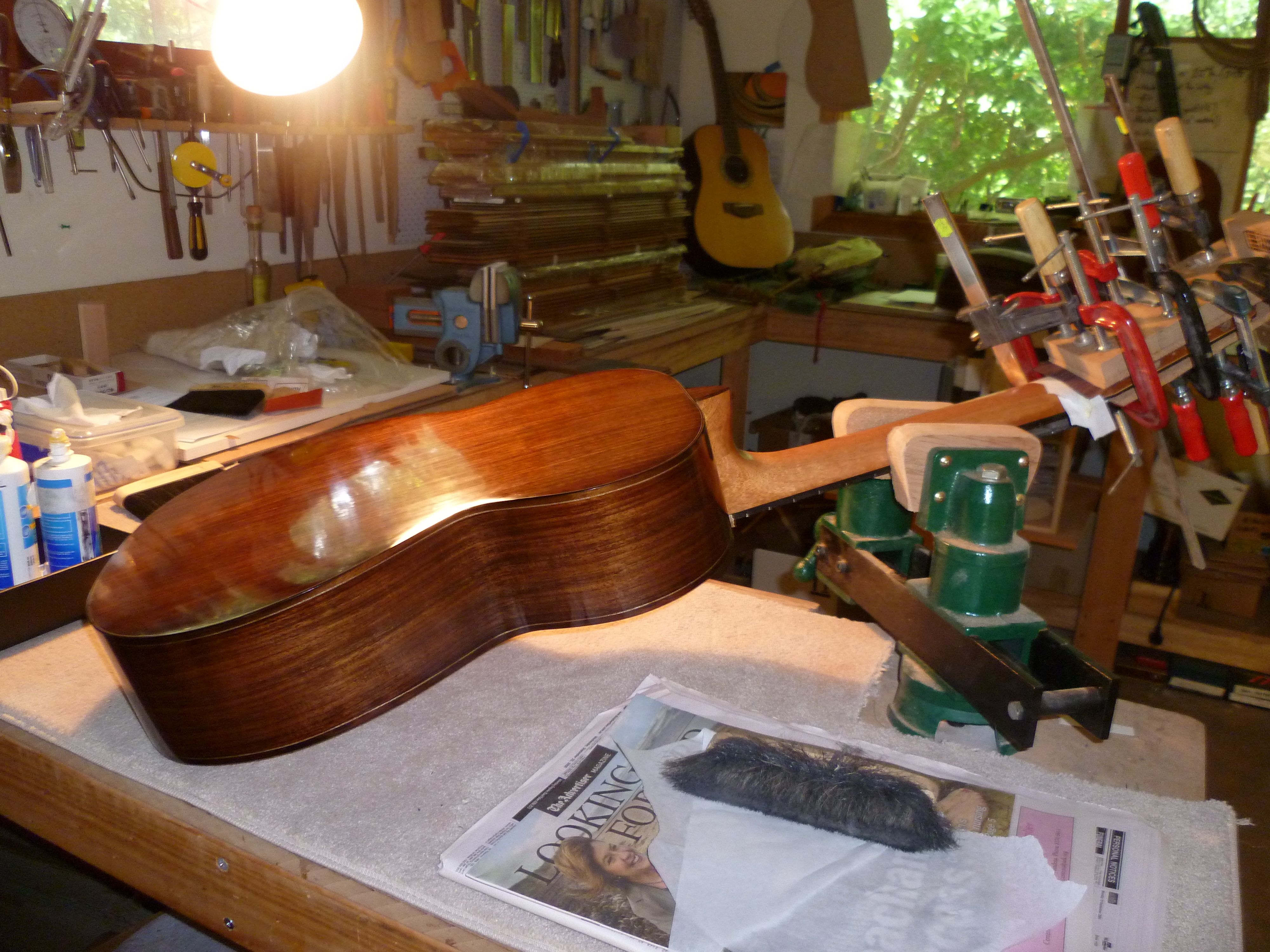

Decided I didnt like the back of the headstock (scarf joint more visible than usual) so I glued on a veneer to hide same. With the guitar in my trusty pattern makers vice I was able to glue up the veneer and then carry on French Polishing the back of the instrument.

The FP has been an absolute P in the A. I've changed my method a bit since yesterday and it's going alot better. Issues were as follows:
1. During bodying sessions Ive made a point of not reworking the muneca over the same spot more than twice.....this avoids dragging half dried shellac around.
2. Instead of doing a body session then stiffing off Ive started doing 2-3 body sessions in succession and then doing a stiffing off session after a few hours. I then wait another few hours and do another stiff off if there's still oil on the surface.
3. Ive been using less meths on the pad during stiffing off and have started pressing alot harder.
Results are alot better with the above changes to my technique.

Martin, reading this as I am after a couple of post prandial pinot noirs, I hope you wont mind me saying that sounds like an awful lot of stiffing off. I know I've never managed that much. Have you ever had problems with meths irritating the skin? Was that all in one session or spread over several???? :wink: :wink:

Not really a huge amount of stiffing off. Actually Im stiffing off after 2-3 body sessions rather then after each body session so Im actually doing less stiffing off.
My munecas are made such that I dont have my fingers in contact with meths while using the muneca.
