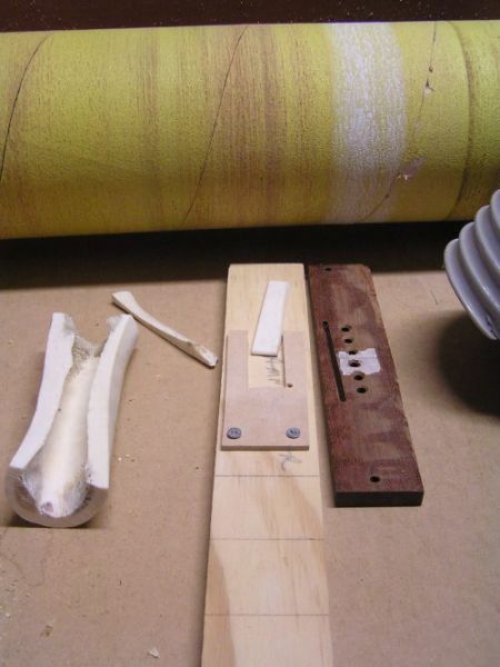

- Posts: 414
Thanks Kim and John FM (especially for Carruth link)Kim wrote:Frank,
If your slot is a tad wide you can make your own custom width saddle from beef bone from the local butcher, takes a bit of frigg'in about but it works very well.
As you said, a bit of stuffin around, but a nice tight fit now. I'll never take an off the shelf saddle for granted again.
Frank
