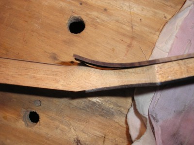

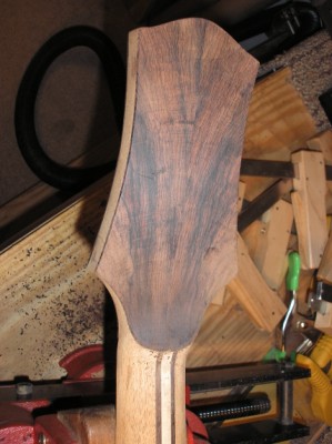

Well, I managed to get the back hs. plate bent and glued on after cracking the 1st AND 2nd plates. I never had trouble bending ebony for this before but this guitar just didn't want to have ebony for the headstock overlays I guess, so I switched to a piece of bookmatched brw. sprayed some Supersoft2 and it bent very nicely. I sprayed the ebony with SS2 also but It didn't help much.It was a stubborn and dense piece of wood!I'm using Schallers with ebony buttons so I thought ebony plates would look good.This guitar is Really fightin' me! But , I'm glad it worked out this way.

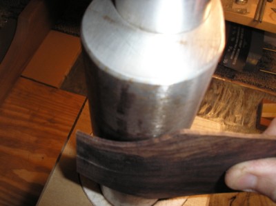

I like bending this piece with the pipe vertical.I can control it better.

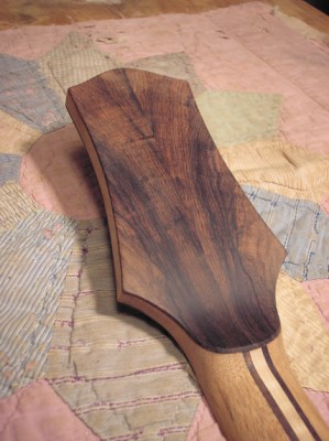

Scraped and sanded

Very nice bit of brw Dave, the job has turned out well worth the perseverance. Just a thought but maybe if you went a little thinner the ebony would have been OK.

Kim, I did go as thin as I thought possible with the ebony at .070 (same as the front overlay). A little thinner
might have worked but wouldn't look right to me. This was just some mean,rock hard ol' ebony that had
no intention of bending. It's strange because I bent ebony for my L-00 at the same thickness
with no problems but all wood is different right. You never know which piece is going to fight you.
Anyway,I'm glad I ended up using brw. for it .I think it will be fine with the ebony tuners.Thanks Kim.
