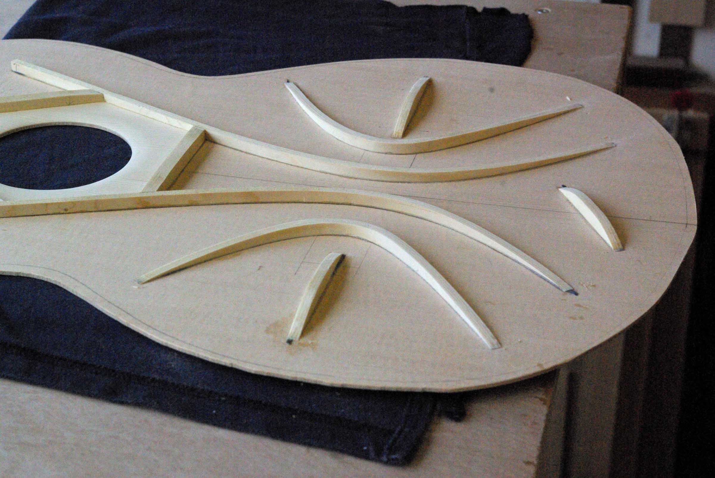

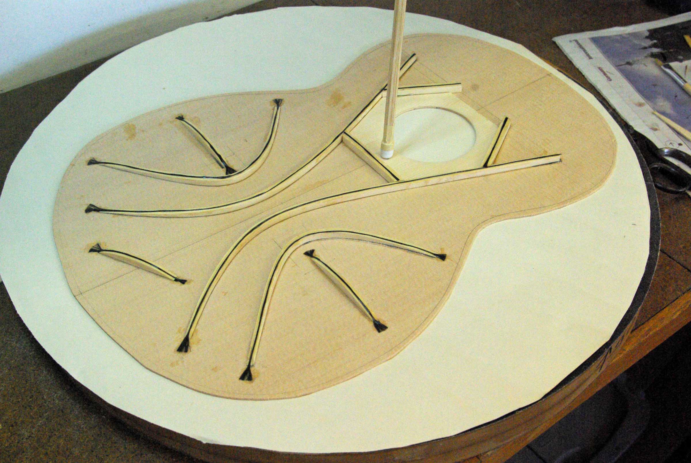

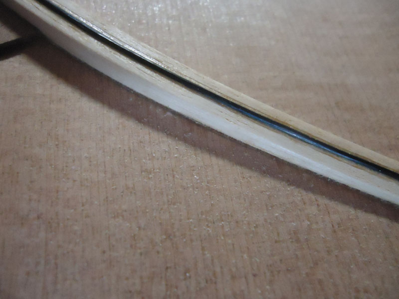

I may be putting up a hostage to fortune but I overlaid carbon strands on my (classical) top today so I thought I would show the world what I've done and return at some, possibly quite later date, with the resonance measurements and sound evaluation on the completed guitar.
I have based it on the Fleta outline but essentially followed G&G's steel string bracing pattern. Brace height is at 7 mm maximum as near as I can get to it.
Very hard to be clean which I really don't like. I suppose masking off the areas not involved would be the real way to do it.
Trevor I am thinking about the rather huge question you have posed and will reply later. I suppose the initial response is that any gaps are few and small. And of course you and Gerard keep making the point that we should use your info as an aid to our own thinking so we shouldn't, and don't, expect to have our hands held all the way.

Dave that looks neater than mine! I will be interested in the tap spectrum once you get the box closed and then with strings. I am right behind you with another classical.

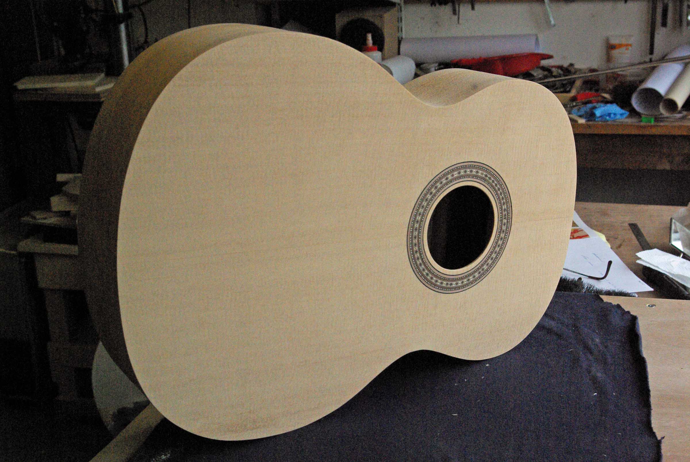

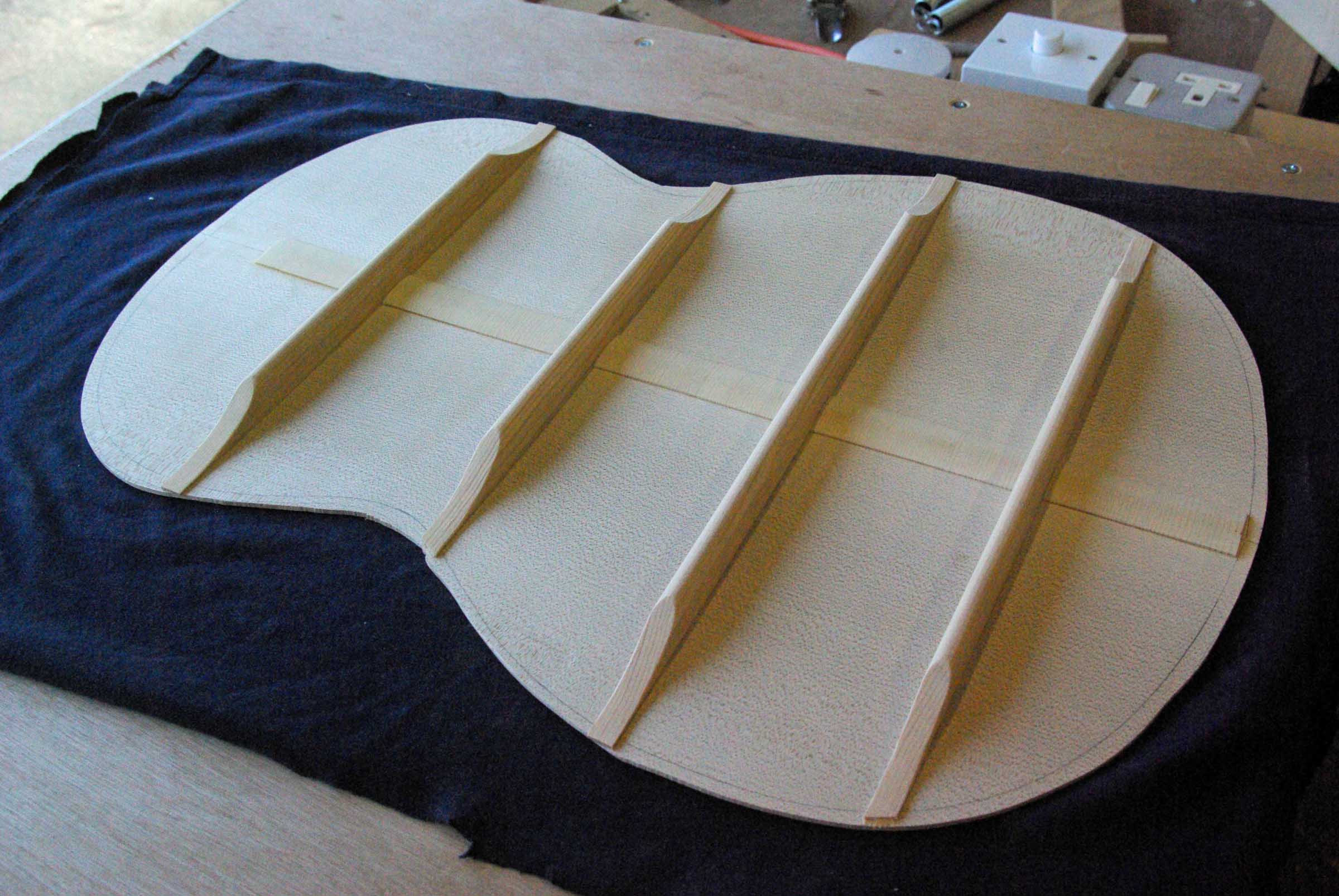

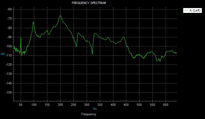

Right well I said I would follow up with the build... I closed the box yesterday a bit quicker than I expected.
The rosette is commercial. I am concentrating on getting the construction process right before worrying about that aspect yet - though I must say I liked yours John.
The spectrum is taken straight off the box. no thinning, no shellac. The spectrum is a one off but several repeats gave the same results.
The back is tied down with 4 heavy braces so, as intended, doesn't seem to show in the top spectrum.
I did some thinning round the edge but was pretty wimpish about the amount of material I removed so this didn't change the resonance peaks much.
Coupled resonant frequencies were:
Main air 97 Hz
Main top 199/200
Back 291
Subjectively the tap testing on the top was very encouraging. There was quite a lot of volume and the tone was attractive. We'll see if this tells us anything about the final result later. I note that the active area runs up to and around the sound hole which of course figures with the design but is nice to see in practice.
Will continue to report as the build goes on.
Cheers Dave

Thank you Dave! I am a couple of days away from bracing my next top. It looks like you can hit 190 when you get you bridge on and strung up. That is where I was hoping to land on my last one. I may go a tad higher than you as I will have an active back so there will be more coupling between the back and top. I will go back and look through the models in the book to make sure I am thinking of the coupling the correct way. Did you use the tap tones to figure out your thickness and did you use the classical vibrational stiffness number?

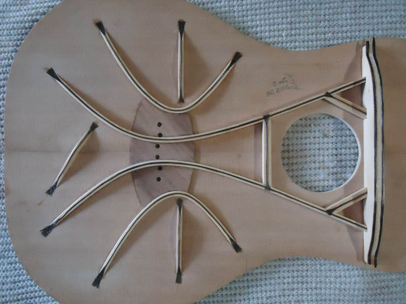

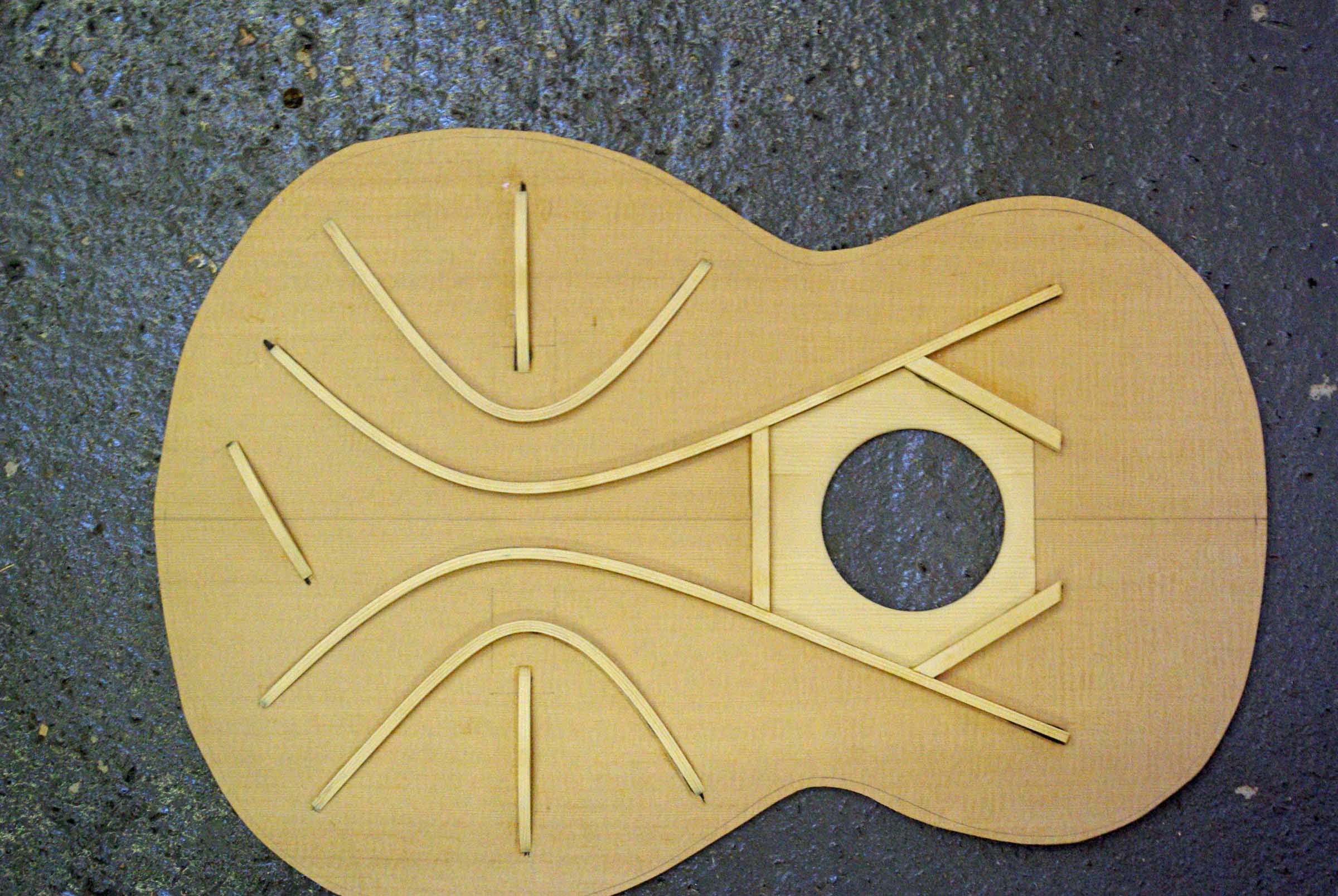

With a bit of practice you can get it tidier without masking Dave, this is my number four and you can see in the close up I now manage to keep most of the epoxy contained within the centre laminate of the braces. I will clean those couple of little bit of spill.

Jim are you applying the with a small brush, it really neat compared to mine.

I use size 4 Chinese made cheap brush, the (I think pig) bristles are about 12mm long and I cut that square, down to 6mm giving a very stiff brush and I also use that brush to impregnate the CF tow on a bit of baking paper before applying it. I sort of scratch the epoxy on to the braces using very little in the brush. When I lay that CF on I just let it hang till the end touched my starting point then I just slowly let it drop down onto the brace sometimes pinning the end down with the brush till I have laid about 50mm on then I just keep dropping it down onto the brace and hardly touch it again with the brush except to guide it with the brush into place but I don't let the brush hit the braces again and so it just sits in place looking like a bit of rope that adds about 0.5mm of brace height. My braces are down to 6.4 mm and I am still coming up a bit stiff for my small guitar (with steel 13's on) so now I will be dropping the value of ƒ in the target thickness equations from now on.

John no I couldn't tap test the panels as my supplier had cut the corners off. I considered getting a E by deflection testing but I have had trouble reconciling the results from these two methods.
The top is Sitka with very little runout and I decided 2.3 mm was not going to be far wrong. Yes I will be aiming for 190 Hz. On this build I have included the mass support blocks so should be able to play with things.
For interest the weight of the full braced top was 205g.

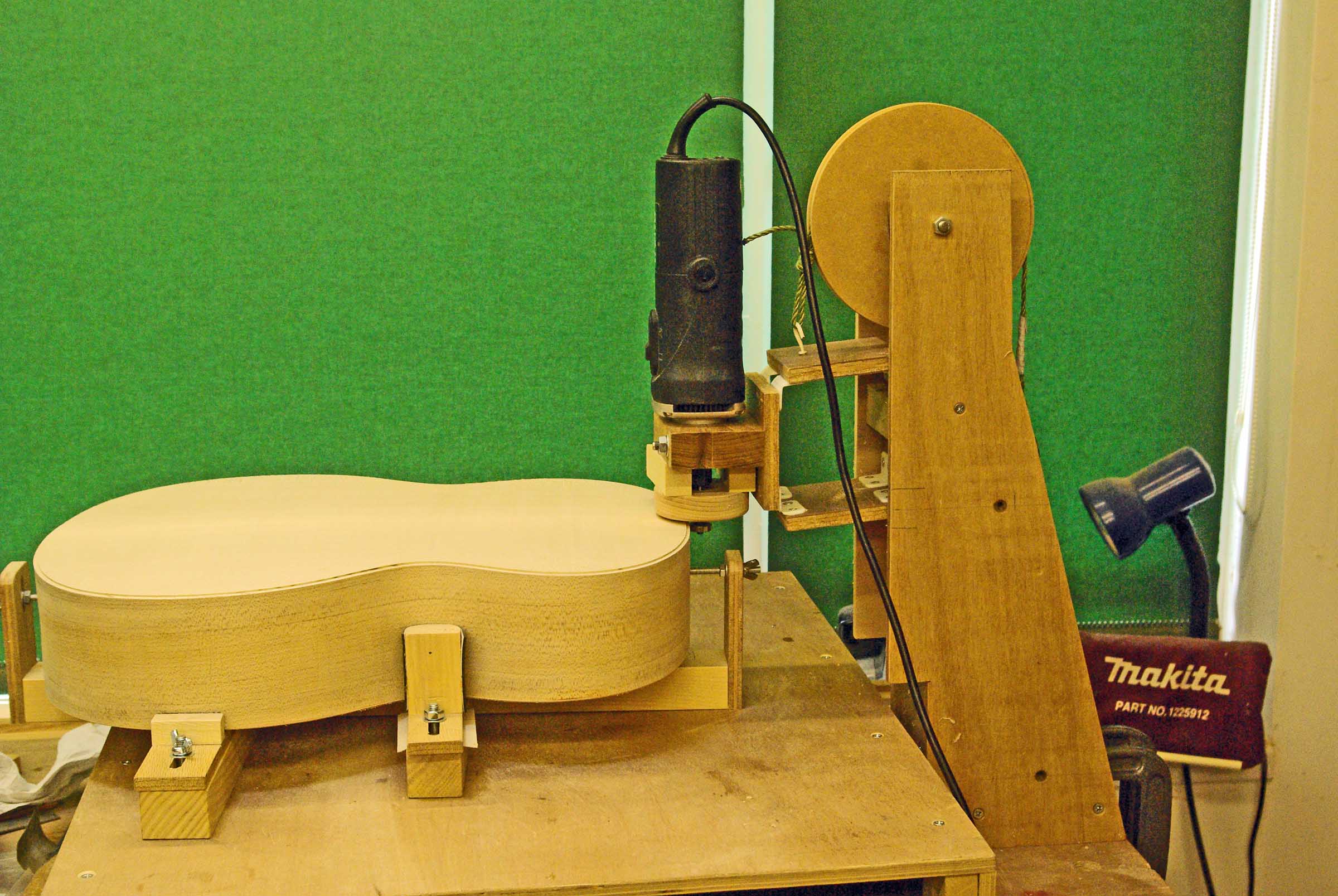

As an aside this 'hippy engineering' binding machine is amazingly successful. My router is a bit heavy hence the counterweight.

Jim thanks. That is extremely neat work. The thing I was getting wrong was that I needed to rest my wrist/forearm to keep steady and found myself touching the stuff already laid down. As you say practice is the way forward.

Gotta love that pit head binding machine. Looks properly industrial!

Post by Dave M » Wed Jul 08, 2015 4:29 am

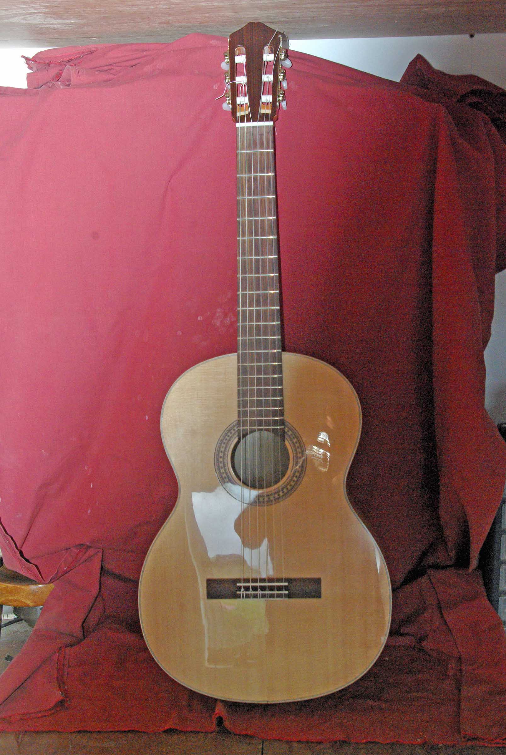

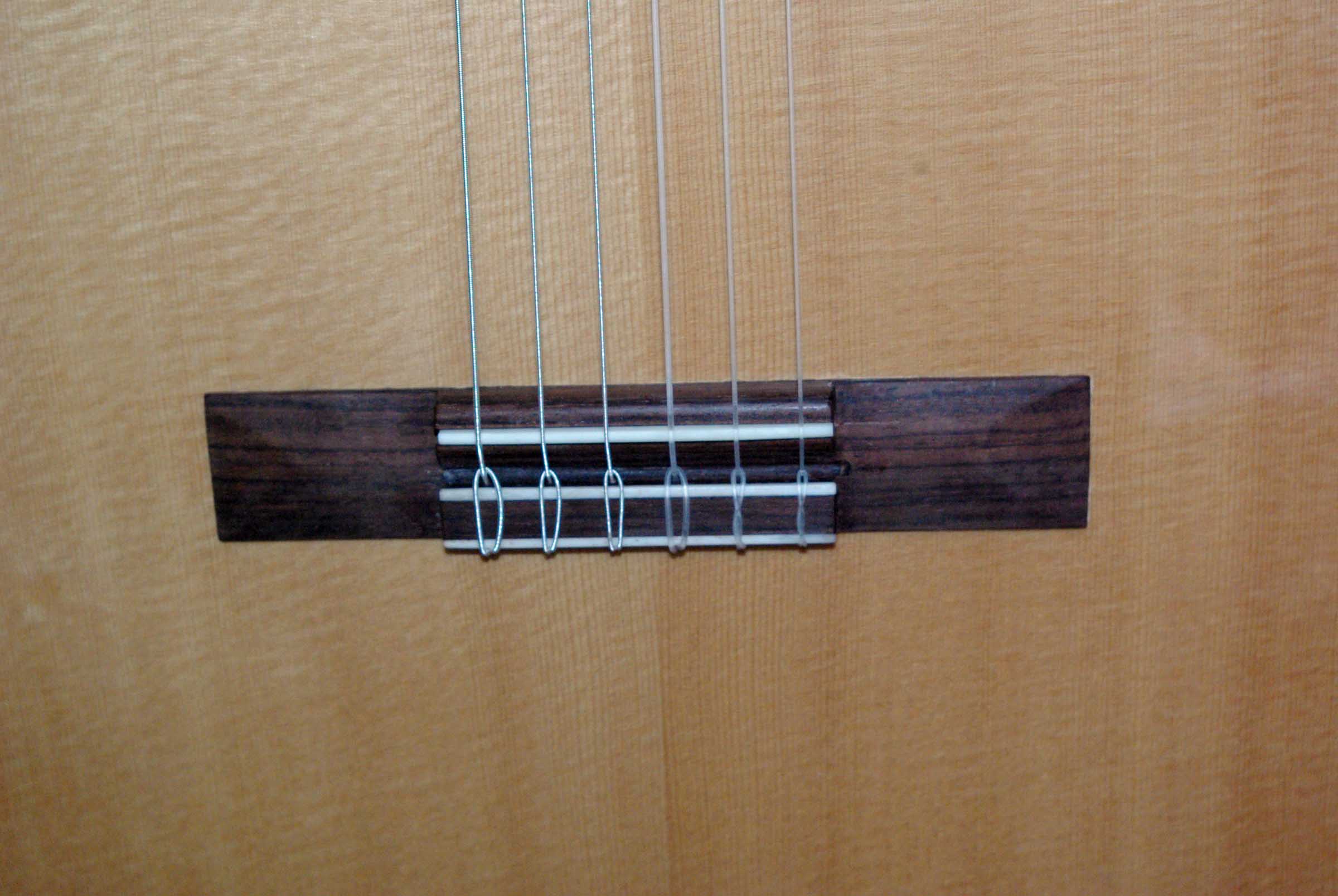

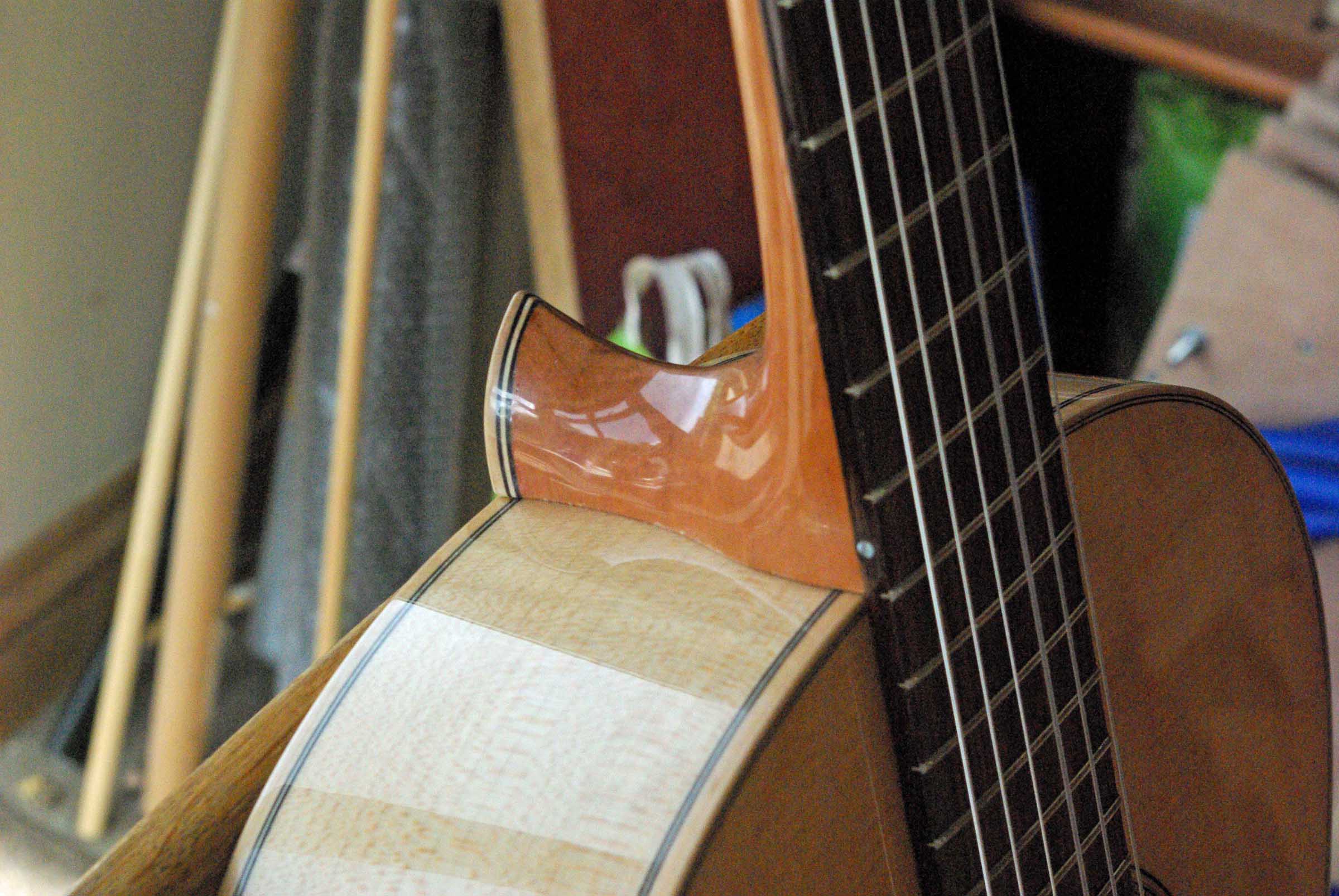

Well I strung my falcate braced classical that I have posted on before. I am seriously chuffed! It is a really nice guitar. It has volume, it has sustain, it seems to have presence. It makes me want to take up playing all over again!
I'll have to learn properly how to damp strings at the end of a note which I didn't really need to do before.

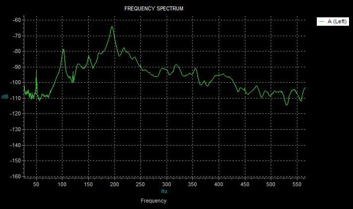

There are a couple of snaps below, also the resonance spectrum which is a single shot but several repeats gave the same results. Changes to frequencies from the closed box with no neck or bridge to complete were:
Top main: from 199 to 195
Main air: from 97 to 102
Back is around 296 but is heavily braced.
That 195 Hz top ought to be giving me trouble with the open G string but I really can't hear it. Maybe it is just far enough away. I have mass addition blocks on the side so once it is settled a bit I will experiment with some weight to see if it improves things.
I repeat that my falcate braces were 7 mm at their maximum, shaped as per directions in the book.
I did manage a low mass bridge. Despite being a traditional design in EIR it weighed 16 g without a saddle.
With reference to a previous post concerning flattening out of the centre I glued the bridge which was shaped to the original curve on the base, with a similar shaped caul and it is now pretty much back to the 8 m curve.
In terms of appearance I haven't buffed it at all, just used micromesh up to 12000 grit. This a wet and dry abrasive available in the UK and no doubt elsewhere.
Thanks to Gerard and Trevor. This has made my day, My year!
