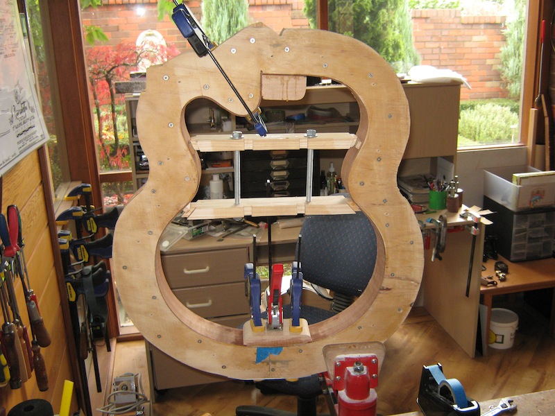

My first journey into side bending is a partial failure. I was worried about breaking it, I burned it instead.
Attempt #1 was stained in blues and greens. I used boiled tap water, apparently that is not enough.
This pic is of attempt #2, I could not find distilled water anywhere, so I used mineral free water. Big difference with only a small amount of water/mineral staining in comparison, however the second time I had the wrong probe hooked up and before I realized my mistake I'd over baked the waist.
After lunch it seems I'll be cutting more Blackwood.
The second attempt I tensioned the screw adjustments a lot tighter and the metal sheet didn't buckle like it is in this first pic.

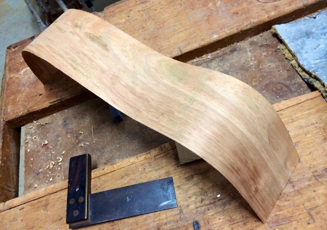

I pulled the last side out of the bender this morning and it was more warped (only behind the waste) than all the others, so that rules out the bake & cool time.
Next one which I'll do tomorrow I'll try the lower temps as suggested above.

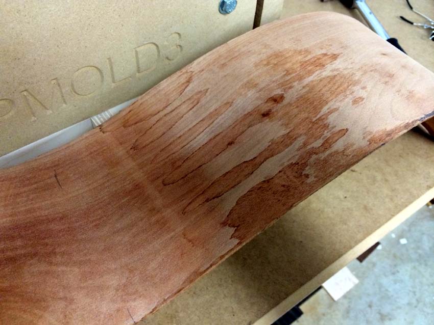

The attached image is the latest (the one I did last night) - you can see where the water marks are in ripples (inside the low spots) where it has buckled behind the waist.
This is my current obstacle as it's happening to every side and I don't know why.

kiwigeo wrote: A wash with oxalic acid will often get rid of the worst of the staining.
I missed this post until now
Where abouts do you buy the oxalic acid? I've never heard of it.
Re: Build thread - Blackwood & Bunya Dreadnought
Post by kiwigeo » Sun Aug 10, 2014 4:49 pm
Bunnings or Mitre 10 should have it. I actually used an Intergrain product that I had sitting around my garage...used for preparing wood surface prior to treatment with their other products.

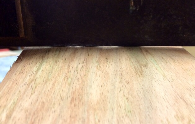

Test piece at 210F.
Still getting the ripples as you can see by the attached pic with the straight edge on it.
For now I'm out of ideas.
Trevor Gore
Posts: 1641
Post by Trevor Gore » Sun Aug 10, 2014 6:26 pm
demonx wrote:Still getting the ripples as you can see by the attached pic with the straight edge on it.
For now I'm out of ideas...
Quarter sawn bends a lot flatter. What you have looks pretty "slabby".

Trevor Gore wrote:
demonx wrote: Quarter sawn bends a lot flatter. What you have looks pretty "slabby".
For practice pieces I've been cutting pieces off inch board, so no, it's not quarter sawn.
Surely flat sawn should bend flat though and there's more than flat vs quarter to this rippling problem
