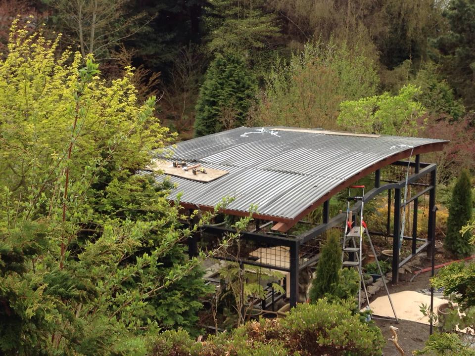

I did find one reward to working outside on the pergola, a small batch of morel mushrooms for a tasty snack.

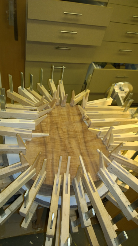

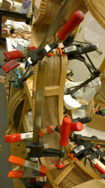

The epoxying of the neck block went OK. Everything seemed to be in the right place and glued down
Not have a special form for gluing making laminated linings together and I decided, as suggested in the book to both glue the laminate together at the same time as gluing them to the rims. Before starting I knew that there going to be the need for a few clamps and as things slides around I would need some time to get everything clamped tight and the bindings at least close to level, I decided to use fish glue. It is great stuff but it likes to stay clamped for 12 hours.
In the first picture you can see that I made a caul for inside of the cutaway. As it was not perfectly bent some clamping force was required. In this picture if you look toward the center I used really cute 4" hand screw clamps to square up the stack of linings as I clamped along the stack.
Ultimatly I am glad I had the time with the fish glue as there was some jockeying of clamps before I was happy. I started with the cutaway side. the neck day I did the non cutaway side.
The glue up went well on both sides. The rims are really stiff with the linings installed. A noticeable difference from regular kerfed linings.

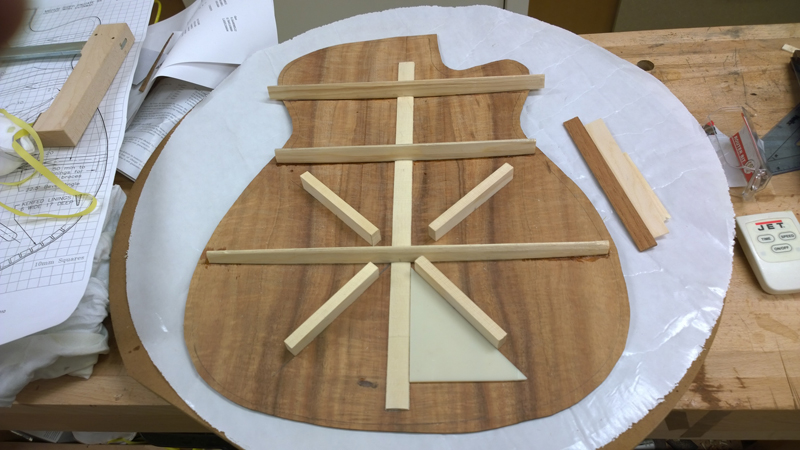

Bracing the back was pretty straight forward, the one change in my procedures was I could not use the 10 foot radius dish to radius the braces. I found it too had to not roll over the sides a bit. Instead I used the 10 foot radius board I made to first mark the radius for using a plane and I finished up the braces in the other side of the radius board.
The braces are all house shaped in their in profile. The book had a method of using a 22.5 degree router bit to shape the brace stock. I bought the bit but I found the process a little scary, so I used a chisel and a small plane to shape the braces.
Also the live back plan has a set of radial braces in the lower bout. I made a 30 degree square to set the brace location.
A bit of chisel work shaped the braces
After a little bit of clean up I had the completed rims, top and back.
The carbon fiber on the top kept the top in the prefect shape. Absolutely no spring back. There was even a bit of vacuum when I put the top on the radius board that the top was glued up in. A straight edge on the fret board extension area of the top gave me the perfect 2.5 mm at the saddle that I am looking for.

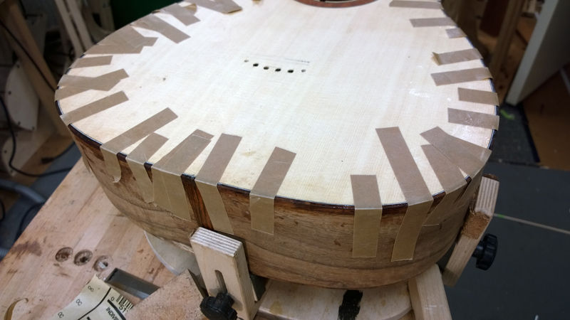

I closed the box yesterday and today. I did the back first and the top today. In each case I used my radius dish as a gluing caul and cam clamps. I do not have the picture gluing on the back but the guitar was in the mold with spreaders holding the guitar square to the mold. One the back was on the rims with the solid linings for the top no longer need a mold.

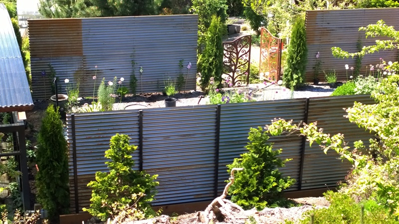

I had to slow down my shop work to build a pretty substantial corrugated steel fence for the hidden sculpture garden my wife designed, 40' by 21' by 7'; mounted on 2" sqr steel posts. The fence is bolted on 24 10" round by 2.5' concrete filled post holes. She offered to hire someone, but I imagined the estimate. The steel will be left to rust and for the most part in short order there will be a lot of clematis and other plants. I had the steel posts custom fabricated. I think I am finished for this season!

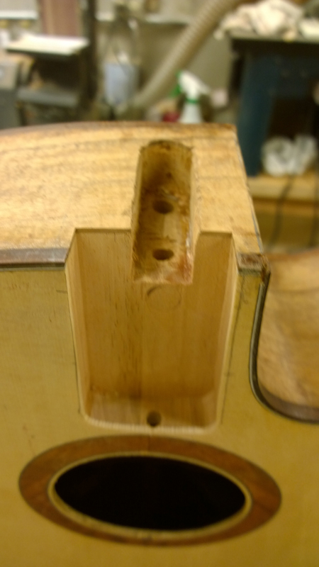

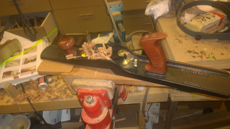

I deviated a bit from the book and I cut the mortise and the tenon using my luthier tool jig. I am use to a martin pattern with a flatter top rim profile. and I cut the mortise at a very slight angle. You will see below I had to do a bit of chisel work to get the neck to set properly. Another mistake is that I cut the bolt holes with my martin pattern which put the top side bolt for the tenon against the inside block extension. Live and learn :). All and all it is all working out OK ...
Made fret board
I roughed in radius with a plane
Note that I am using a guide to keep the sanding bar straight. This avoids over radiusing the edges by skewing the block.

Needed to do a bit of work on the mortise so that the fret board would be centered and flat to the body. That is why the mortise is rough in a few of the pictures. I think that my template was slightly rotated on the guitar. Once I adjusted the mortise the neck angle was OK.
Now to the bolt on extension. I am going to let the pictures describe the process for the fret board extension as it was involved. Ultimately it sort of like an electric guitar mounting with a heel.
Before routing I double checked that I was centered and the angle was correct!
Note I am shifted to the bass farther than I wanted to be. Fortunately not too far.
My template was not perfect so I used structural epoxy for to glue on the extension.
Planed the extension flat.
reestablished the channel for the truss rod.
I will install some t-nuts in the extension and bolt holes in the inside block. Then on to finishing the neck and head stock.
