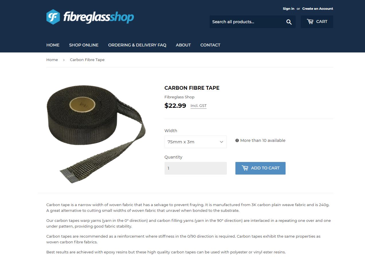

The CF tow (or strand) is actually very small. I used the CF tape shown below and pulled out one strand at a time. This helps keep the rest of it tidy as each strand is made up of 3000 tiny filaments (hence 3K) and it come undone fairly quickly. I had a quick google but couldn't see any obvious places to get it in Ireland. When you find it, I'd suggest you buy a couple of metres of this as 1 metre isn't long enough to do two main braces. If you get desperate I can get some here and mail it to you but cant believe its not in Ireland.
Here's what I used The epoxy brand isn't critical. Clear is good for visibility and appearance but its all inside so not that important. I use West Systems which I think you can get anywhere. Any problems, just go to your nearest boat shop, they'll have tonnes of the stuff. Dont buy too much, keep it fresh.

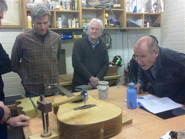

You can use any form of bracing you like, and X-bracing is certainly tried and tested. Falcate is just another way to do it, and it is becoming popular- but the bracing pattern is not really what we started talking about in this conversation. It is about getting some objective data about the structural aspects of certain guitars (however they are built) and starting to identify the characteristics of “good” guitars versus not-so-good ones. Then you might be able to work out how to make gooder ones.
For top deflection testing you just need a dial gauge (from E-bay or a good tool shop) and you make some sort of a rig to get it to sit over the middle of the soundboard. Then just measure how much the plate is depressed by a weight placed on the bridge area. Take a look at this thread for some discussions of different rig designs:

It can actually be pretty simple, such as this one that Trevor Gore showed at one of his classes: Bridge rotation testing can be done with an inclination measuring app on your mobile phone. Just stick the phone to the bridge of the guitar with Blutac and then zero the incline meter. Measure how much rotation occurs when you take the guitar from full string tension down to no tension, and then back up to concert pitch. Those two measurements will give you a good idea of how stiff and heavily braced your top is, and you can make the same measurements on your Taylor, and as many other guitars as you can get your hands on (maybe a Lowden?).
viewtopic.php?t=5464

If you do go for using carbon fibre I bought mine from Easy Composites in the UK. They sell a plain weave 3 K cloth, 1 metre wide. I bought a metre and it goes a long way.
