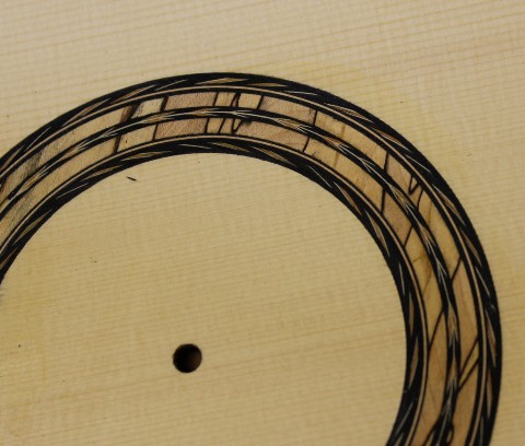

Pablo Requena has a good youtube about making a herringbone purfling, which is basically a double rope: https://www.youtube.com/watch?v=o4wS73H78EE
John Bogdanovic https://www.jsbguitars.com/classical-gu ... king-book/ also shows herringbone (or wheat purfling, I can't remember which) in his book Classical Guitar Making, again with rope construction being a constituent part
I haven't made rope, however, I have recently made my foray into more complicated purfling, attempting Paco Chorobo's chainlink purfling https://chorobo.com/en/courses/online-course/ . Basically laminating veneer of blue/white/blue and another of white/blue/white, cutting them into strips which I then sandwiched between more blue veneer. It took me a couple of goes, but pretty happy with the result.

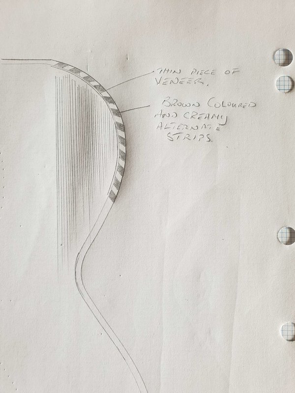

The rope binding I referr to is on photos of the various Nunes Instruments but I am unable to send a picture.
Might be ccopyright rules so I have drawn what I mean.
The rope is made up of brown and creamy coloured wood and on the inside there is a thin veneer strip.
It is quite chunky and to get around the waist could snap the glue joints.
I am wondering if they were laid in individually?

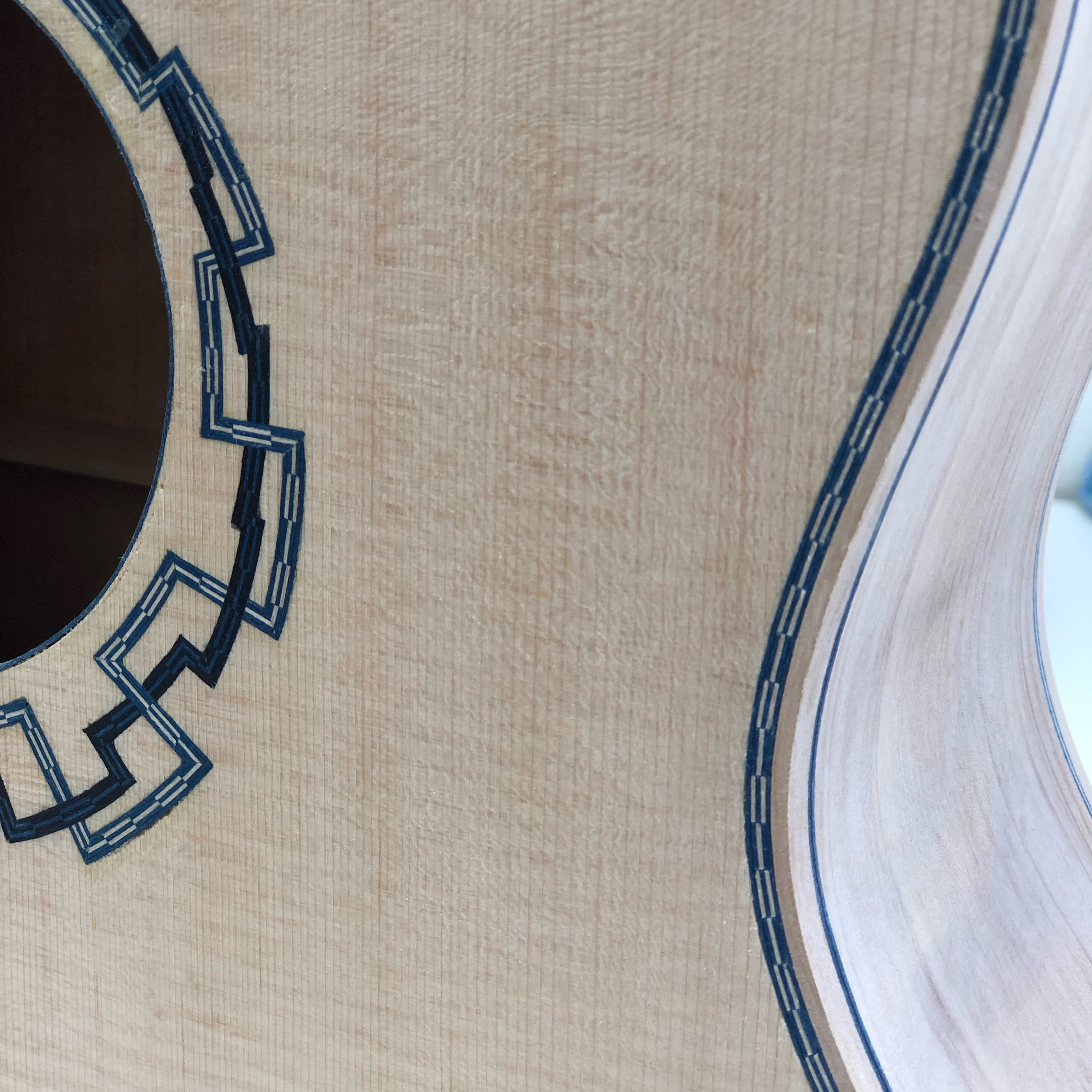

If it were me, I would still be constructing the same way. Create the log of askew strips per Pablo, slice off strips and laminated them between two veneers. Then bend them on a hot iron. Having a veneer on each side will allow them to bend both ways with the iron melting/re-activating the glue allowing the pieces to move against each other. Cut your binding channel a veneer thickness shallow and then scrape off the outside/proud veneer flat with sides.

Yes!!!.....that is exactly it!...
Brilliant.
Thanks for the low down on that Trent.
I will watch the P R vid again and again.
Two questions if I may?....
Did you make that Beautiful instrument?
Should I use hot glue or will Tite bond bend just as good under heat?.
The idea of the veneer strips each side to hold everything in place makes good sense.

Hi Pete,
It's been a while since I made this rosette so the process is a little fuzzy to me right now but near as I remember lamanoditrento's description of it is spot on.
It took me a couple of attempts, the failure with the first one was due to using a water based glue like titebond. You obviously have to be able to use a water based glue as this type of purfling has been around hundreds of years but I had problems with it. My problem was cupping in my layup, which makes the arrows not line up when assembled into the wheat, It probably wouldn't be an issue with rope. By switching to a urethane glue however my problem was solved and things came out much better. It holds together better under heat and moisture too. I should mention I hate urethane glue, but it works in this application.

Thanks Guys for all your feedback and pics of what you have done.
I also think Trento hit the nail.
The outside strip of veneer is used to keep it all together and then removed afterwards.
What a Gem of a secret that was!
And it is precisely this that excites me.
Please...I do not expect to be spoon fed but wish to discuss with you how this Rope binding has been accomplished.
To my mind, it is not the normal contemporary method but something they did a century ago.
This is why I asked.

- lamanoditrento
- Posts: 617
Re: Rope bindings advice please
If you are confident with HHG, I would use that. The chain link purfling above is 3mm thick and was made with titebond and bent without any problem on an iron with no water involved.
