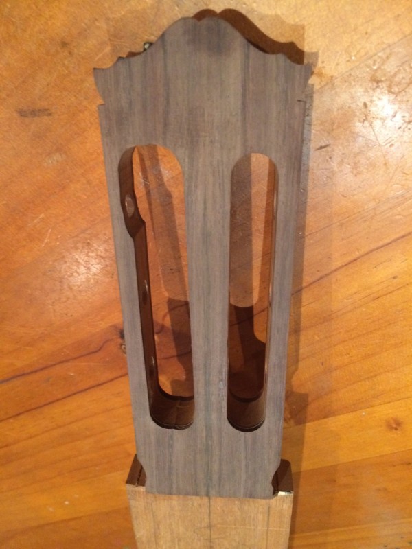

I have an almost completed neck that I ruined with a router last night, and I'd like to post a picture, but there doesn't seem to be a place here to do so...

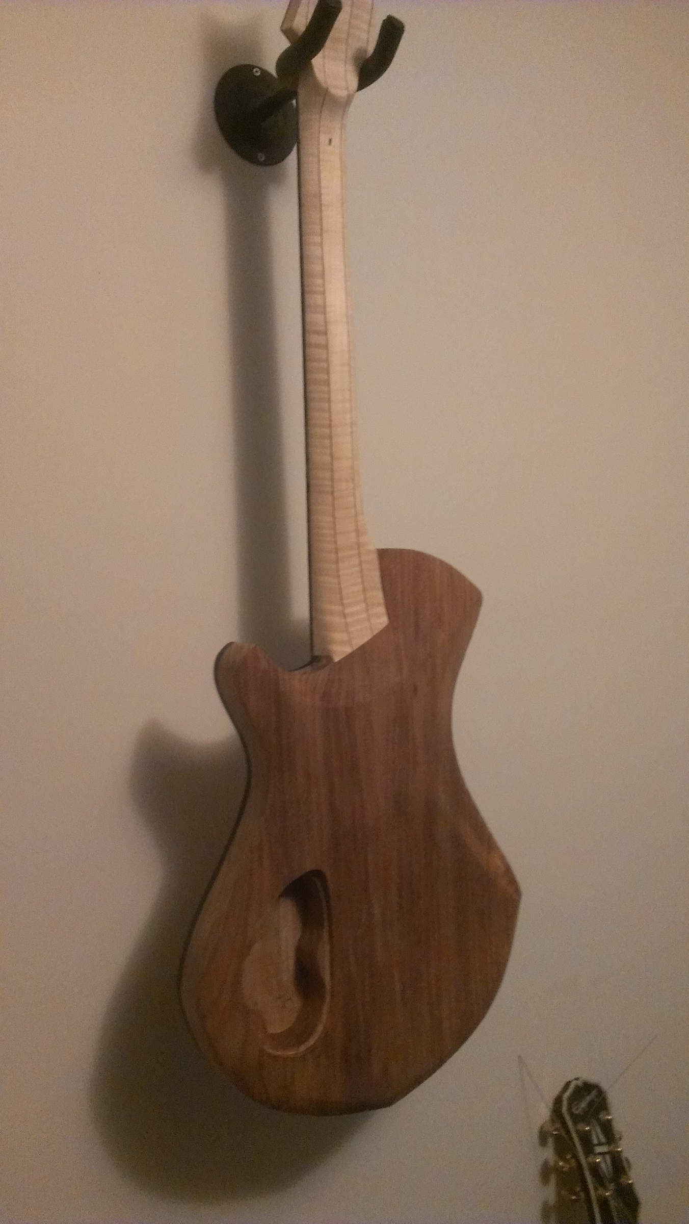

Everyone has their moments. Here's my first one for this year
Sometimes once you carve you find things you don't expect, for example in this Sassafras top there was a small hollow cavity under the surface.
I carved through the hollow as it wasn't very deep, but then I wasn't happy with the resulting shape of the carve. QC steps in, cuts it up and I've got some new timber on the way that is even better than what I cut off.

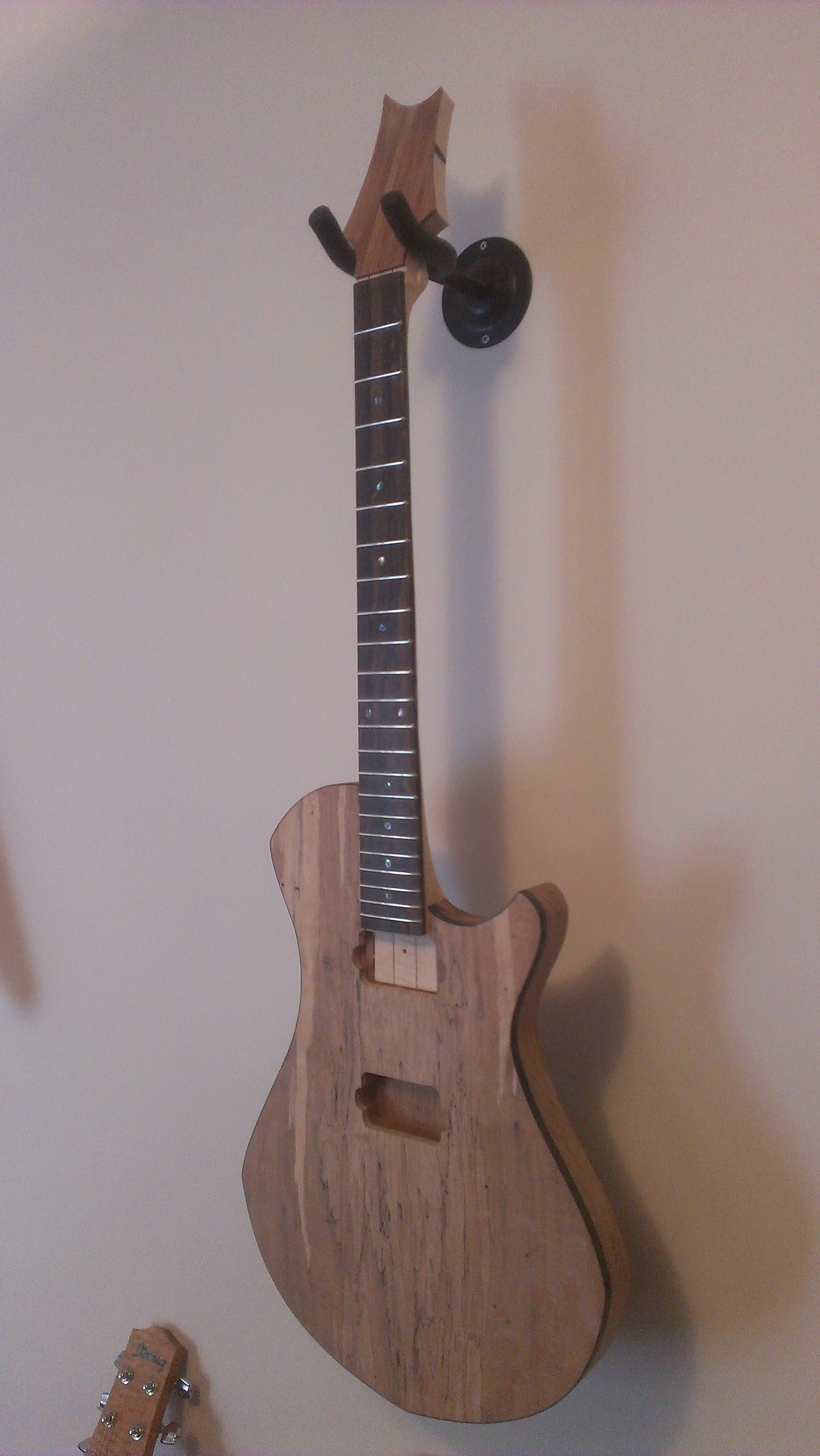

Here's my effort :(

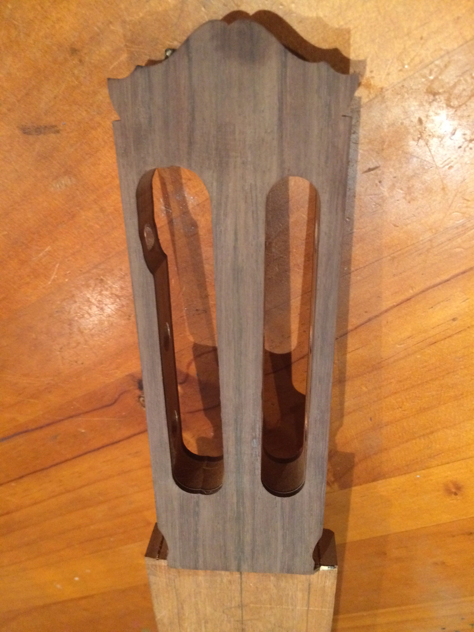

Post by Wayde Christie » Wed Feb 19, 2014 11:47 am
Ask me why the dowel is in there too :)
Posts: 10878
Re: Guitar disasters forum? Build tragedies maybe?
Post by kiwigeo » Wed Feb 19, 2014 11:50 am
Wayde Christie wrote:Ask me why the dowel is in there too :)
Been there done that.
My gaff was not actually putting the tuners against the side of headstock to check fit. With the holes drilled I "discovered" that the tuner plate would end up sticking 10mm past the end of the headstock.
The router cutter "nick" is easily fixed. Plane off the IRW rear veneer and re-do it. If you're anal like me...re-do the upper veneers as well. The nick in the side of headstock....it's going to end up covered by tuner plate so I wouldn't worry about it.
Not as big a disaster as it first appears.
Were you routing holding the router or was it done on a router table? It looks like you tilted the router a bit and ended up with the nick.

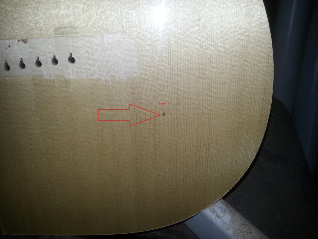

This is a what happened last year because i was a bit lazy. Wayne

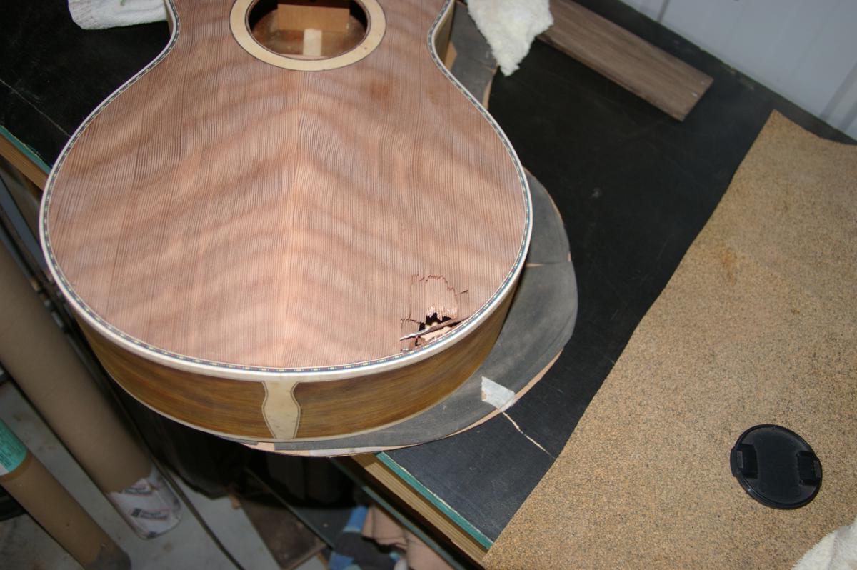

Wayde, I don't usually let anyone know how it happened....I just accept that it did!.....still not very nice when it happens....here is one of mine and the story of the "save"...
viewtopic.php?f=1&t=4181&hilit=accidents+happen&start=0

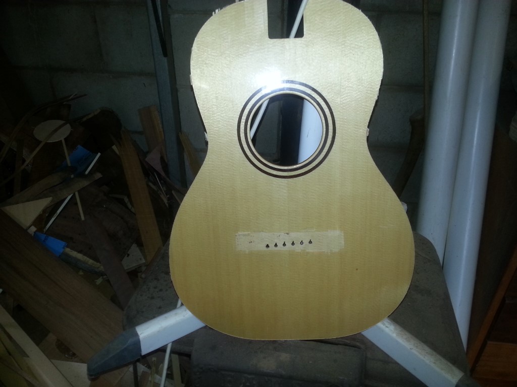

This happened last week.
A screw was protruding through the saddle slotting jig and punctured the top.
Routed the top off and built a new one which was sprayed yesterday.
Bugger.

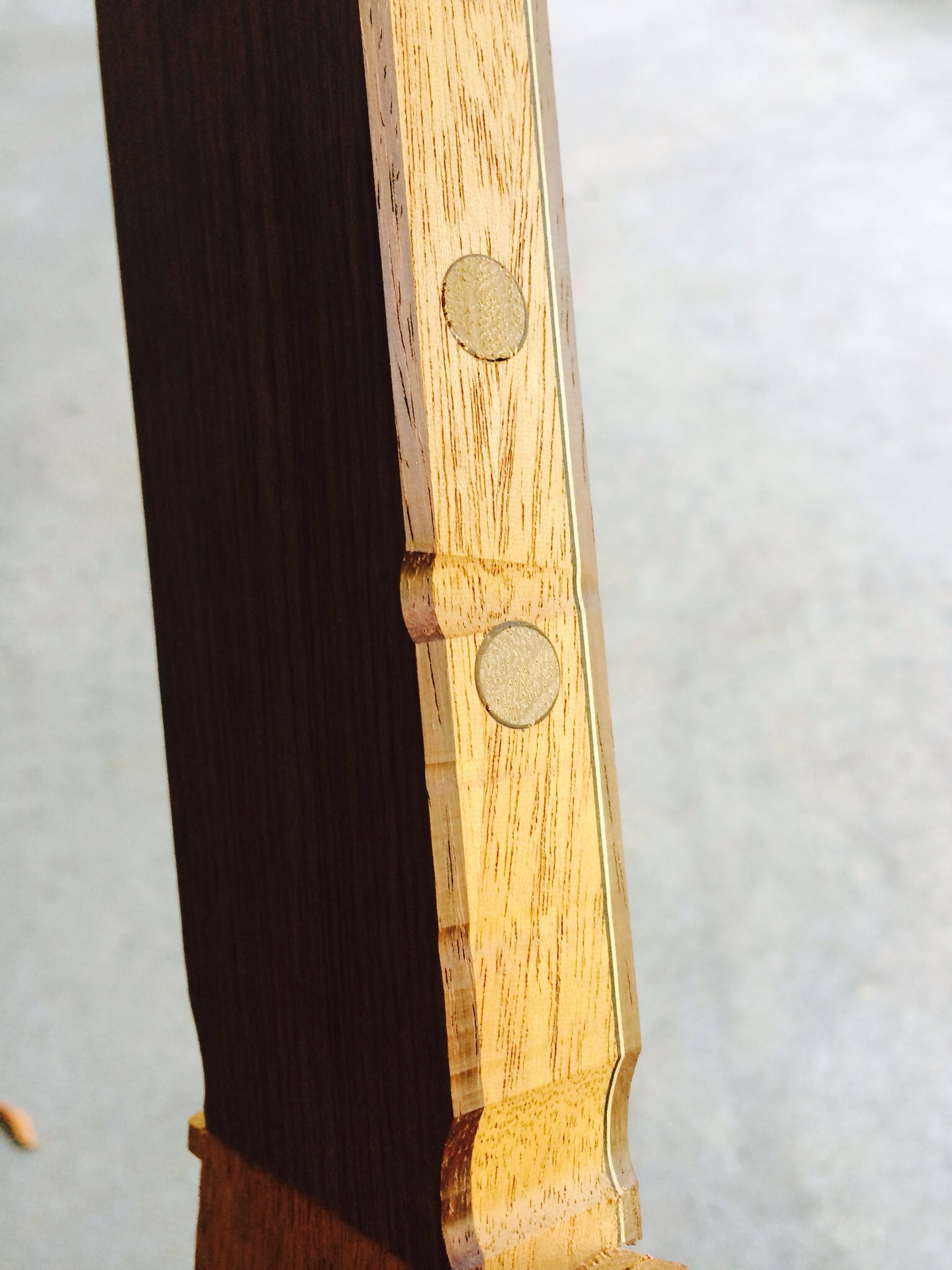

15 minutes ago. Dead sober. No hurry.
I was drilling some holes in the edge of the fingerboard for side dot position markers. I have already made most of the mistakes that you can with this task (or so I thought). 1. Don't use a power drill, a small hand drill is safer for this. 2. Be careful of alignment - I have made a small jig to align each of the holes the same distance from the edge of fingerboard. 3. Be careful of the drill bit wandering off the spot - so I thought I would make a small indentation with a nail punch first. This has worked out OK for me before but with this ebony bound fingerboard it turned out to be a bad idea. A light blow on the punch sent a chip flying off the corner of the binding. So - lesson learned. Don't ever deliver brute force to the edge of a piece of brittle wood like ebony. I found the chip and glued it back on with CA and it will probably come out invisibly. But it kind of ruined the fun of a nice sunday afternoon.

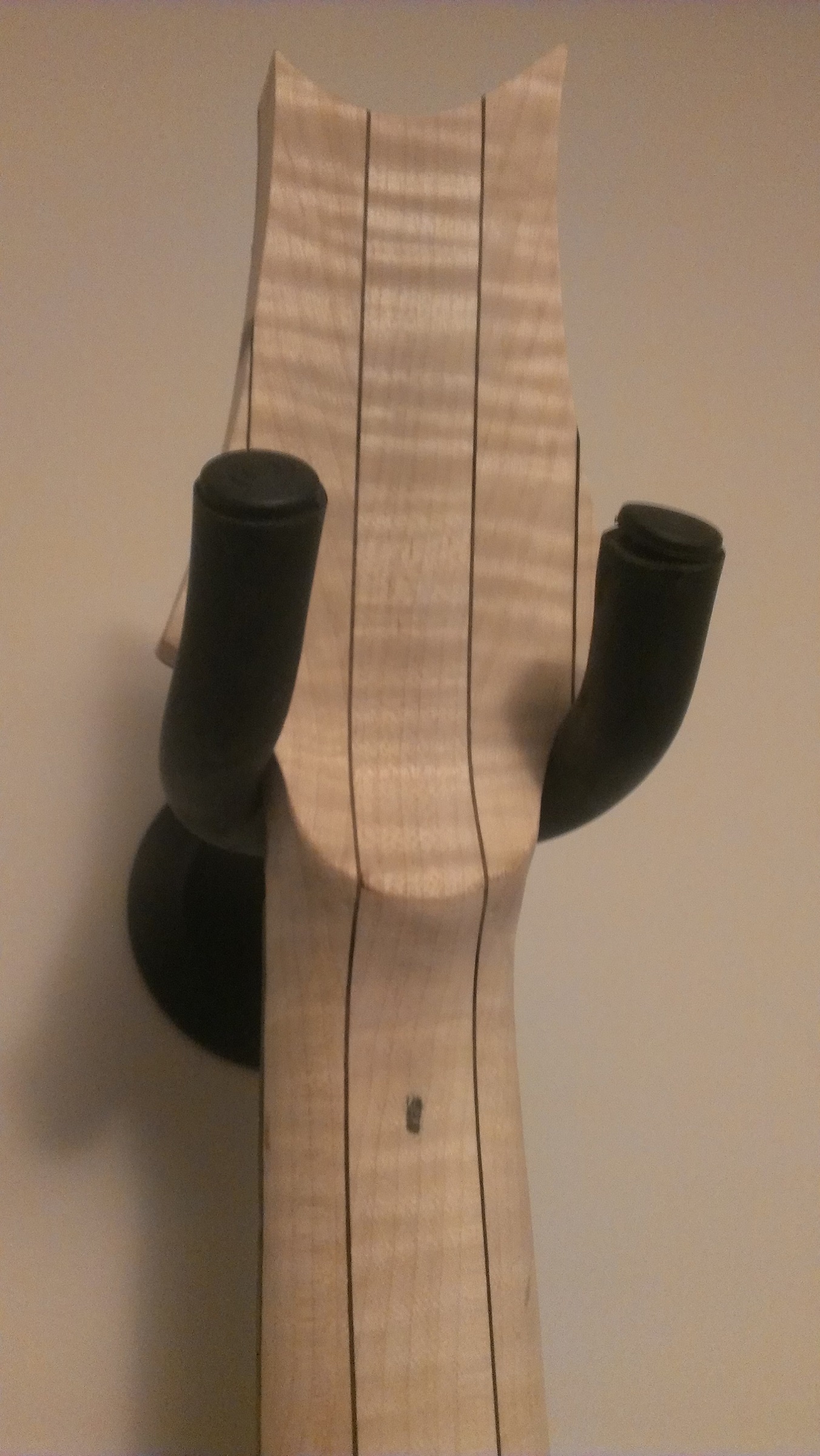

i have been putting together my own design of a single cut guitar (yup its electric) and i am VERY excited to get it done. I was carving the neck and I got a bit greedy with the thickness. I love thin necks (the thinner the better) and I should of stopped at 19mm but...i wanted 18mm...so file, file, file away until...bam!
super happy with the shape
back carve is awesome
beutiful flame maple neck...and a truss rod :(
yup...thats the truss rod channel...from the BACK of the neck! :cl
what a dolt
totally thought i had the measurments exact. 6mm fretboard + 10mm truss rod channel = 16mm right? thought i had room for an 18mm neck :?
anyway...ripping it off an making a new one. thank buggery its for me and not a customer!
