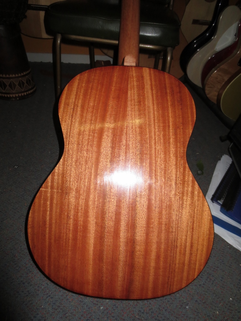

Re: Fijian Marhogany?
Hi Steve
I realise you are enquiring about Fijian mahogany, but I just wanted to
say that I have made an all mahogany OM style guitar using Macassar
mahogany, plantation grown in Indonesia, see link below.
It was a lovely timber to work with and so far has been very stable.
Cheers Bruce
viewtopic.php?f=25&t=4767
