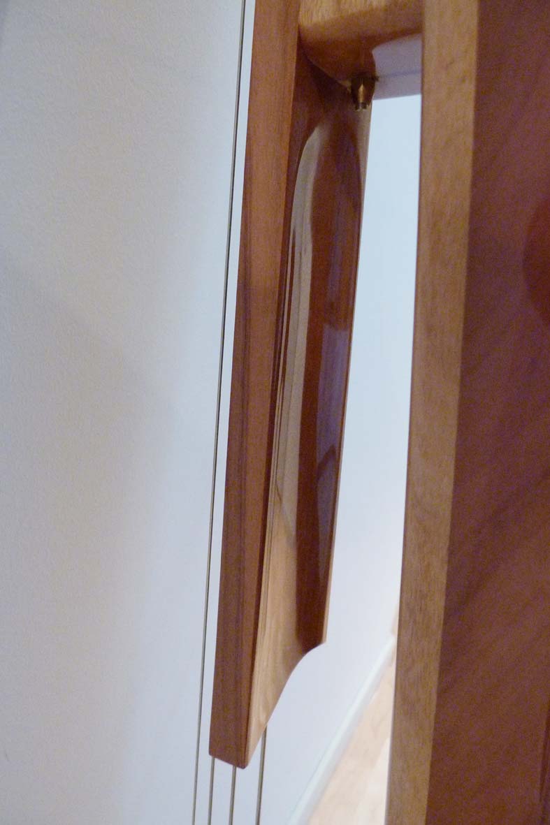

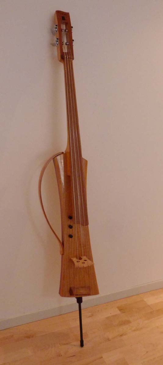

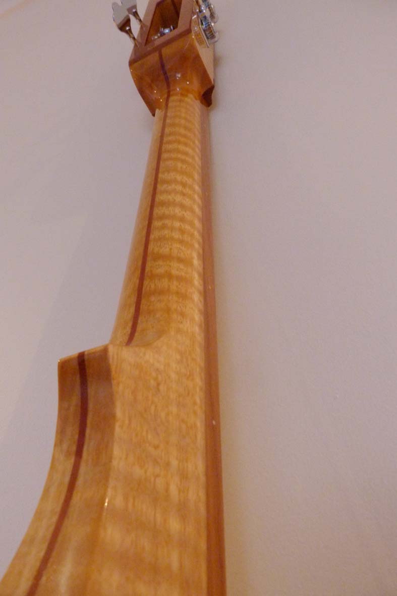

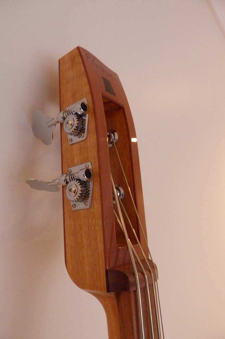

hi - recently finished a 3/4 size electric upright bass for my son. Specs are:
- 1051mm scale length
- tas myrtle body (kind of hollowed) with a vic ash cap.
- neck is vic ash with a jarrah strip
- fingerboard and tailpiece are grey ironbark
- bridge is vic ash
- tuners from stewmac
- 2 piezo discs on the tailpiece side of the bridge -> volume, tone and blender controls -> homemade tillman preamp http://www.till.com/articles/GuitarPreamp/
Got the idea of the piezos from here viewtopic.php?f=1&t=3371&p=41066&hilit= ... scs#p41059
Many thanks to Bill Paulin for your help and great construction pics on the ozbassforum http://www.ozbassforum.com/viewtopic.php?f=27&t=1484 Spent lots of time examining those pics.
Don't have sound clip yet as I need to replace one the strings that got damaged. But here's some pics for now.
Paul

I like your body rest solution and introducing a curve to the body. Hard to do on a long narrow shape. Most try for a recurve and the body isn't wide enough for that to work. :cl
