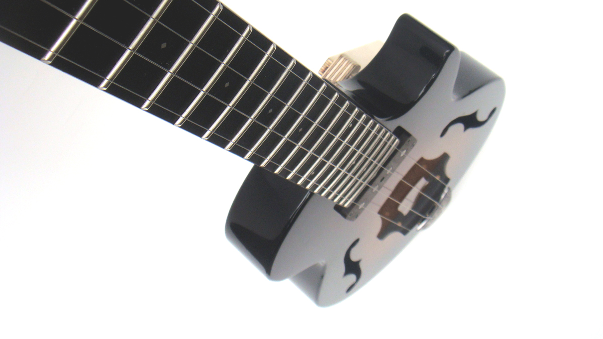

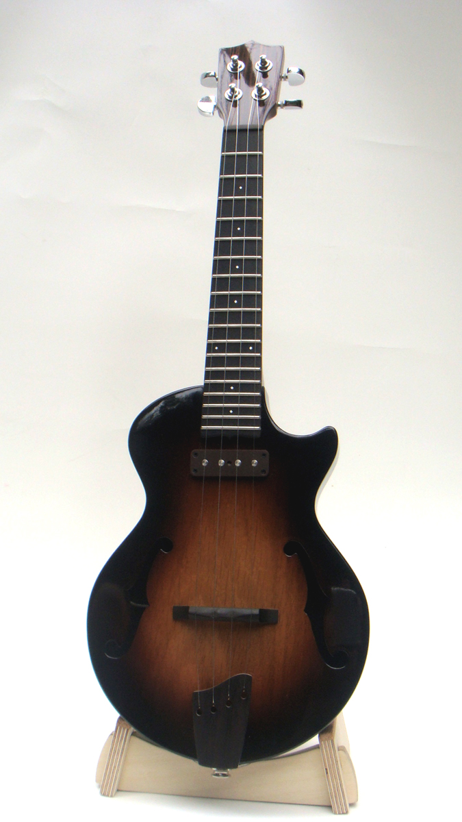

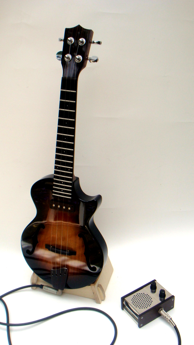

Hi,
For a bit of fun I made this ukulele last year, it has steel stings and a pickup.
Luke
Luke

When I look at the first picture it seems to be a flat or almost flat top "archie"... Does the top has any arching at all? How thick is it?

Hi
The top and back are flat, the total body thickness is about 36mm. It is 2 pieces of 18mm oak carved out and joined together, the top and back "plates" are 3mm thick no bracing. I did all the body routing on the CNC at my old work, I had free access to the CNC and want to do something more interesting than white boxes.
It sounds good acoustic, the steel stings help with the volume. When I plug it in it sounds a little harsh but not to bad, it dose not distort well.
I will try to record some sound.
Luke
Luke
