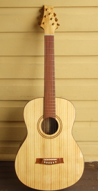

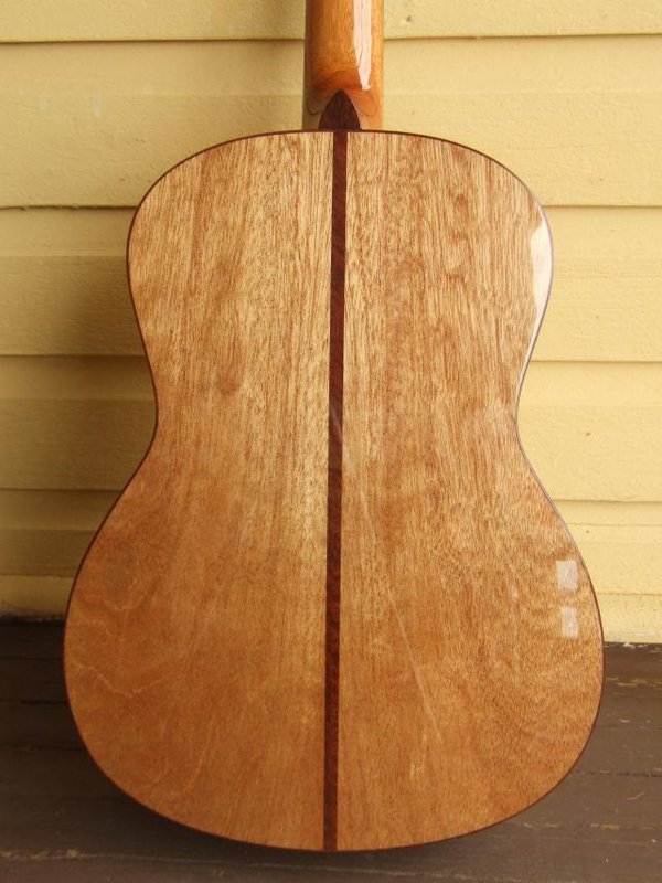

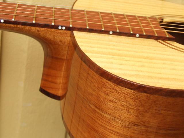

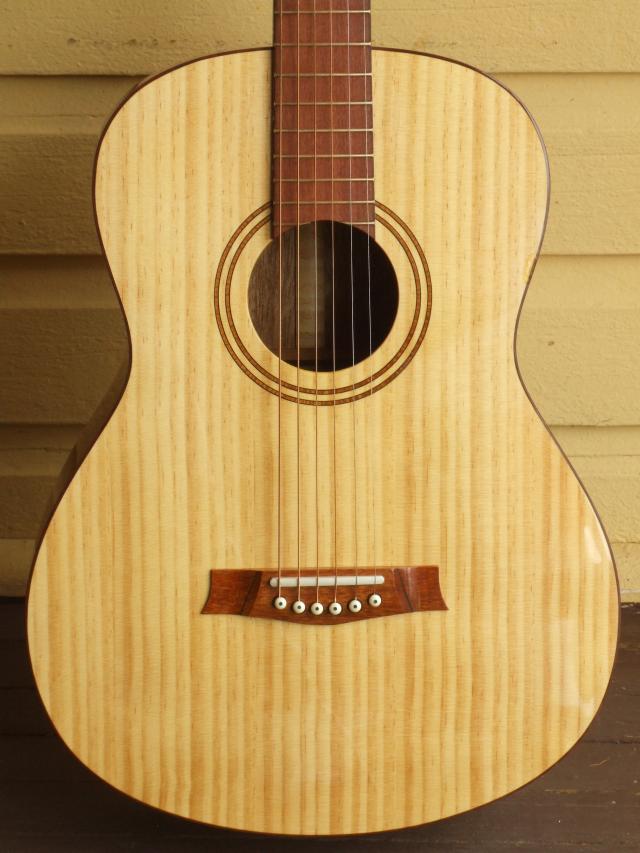

When I moved into "The Shed" about 12 years ago I did the usual reno's and removed a fair amount of wood from the place. A lot of it I kept around, thinking some day it would be nice to make a guitar out of the bits. Then came "the book" and the "Wood for Guitars" paper for the ASA, then Lacey then an order for a classical guitar with a steel string top, which I built and enjoyed before delivering it to its new owner. So with all those influences, I though it was about time to build "The Shed" guitar, built using only bits of wood and stuff salvaged from the reno's.
The top is radiata pine salvaged from some bunk beds (5 pieces); the falcate bracing is Oregon pine from a second hand door off the old outside dunny; the back is light red meranti (4 piece) from the shelving out of a kitchen cupboard (braced with Oregon), the sides, neck and linings are from what I think is dark red meranti (or some other Shorea species) from another shelf of the same cupboard (the heel is a five layer lamination); the headstock facing is huon pine from the ends of an old spice rack; the rosette is red gum (I think) from a bit of firewood that had some figure in it (the black lines are cardboard!!); the bindings, back stripe, heel cap and fretboard binding are from a piece of figured jarrah that used to be a fence paling. The fretboard is brush box. It took a lot of work to figure out what it was. It was from the bottom plate of a stud wall. It was either brush box or turpentine, both possibilities in this area, but the flame test proved it to be brush box. The fret edge markers are from a set of 3mm aluminium knitting needs found in the bottom of a wardrobe (which then lived in the cutlery drawer for 12 years (!)). The bridge is more of that dark red meranti. Gotoh tuners, with my usual nut and saddle compensation. The sound board is finished with high gloss French polish (!) and the back and sides are finished with nitro.
So, I can already hear the question "How does it sound"? Well, unlike Taylor, Benedetto or Bucknall, I'm not going to tell you that it sounds as good as my usual guitars. It doesn't. Radiata has a density 30% greater than Engelmann and is only ~65% as stiff (well, that's how these bits measured up), so you start well behind the eight ball and that straight away limits the monopole mobility you can get. But having said that, it will still blow the nuts of most things you can buy in a shop. So it definitely has the Gore family sound, but not quite as much of it. Having been strung less than a day, I expect the sound to develop some and become more refined, but it's never going to be as loud as most of my other instruments, but plenty loud enough none the less. The real test, of course, is will it be a guitar I will pick up and play? And the answer, I think, will be yes.
The great learning out of this, though, is that I used all my standard design techniques (thicknessing formulae etc.) on wood species that I'd never used before and they all worked. It's a 100/180/226 guitar for those who recognise those numbers.
Here's some pics: There's a pic of the bracing here: viewtopic.php?f=1&t=3809#p45510

Congratulation's Trevor ,
You have managed the preverbial , plum jam ot of Pig Sh%t , or a silk Purse form a Pigs Ear . it' hones the Point that as Traditional Tone woods become more scarce, we need to at least open our minds to alternatives, Strato once Talked me out of Using a King billy pine top on one of My Guitars , because he said he had never heard a good one , so I stashed it , but if got the better of me , So I used it on viewtopic.php?f=25&t=3301 using your Methods , and it sounded awsome . in The end I was happy I tried , I showed it to Strato , he was duly impressed with the sound , I want to take the Bunnings Challenge one day just for the hell of it .
Paul.
Paul.

Trevor , I shudder to think how awesome your guitars look when you build with great materials
fantastic workmanship !! it just goes to show that guitars can be made out of practically anything and still look and sound good. Can't say I've ever contemplated Radiata for a top, good on you for giving it a crack.
Christian.
Christian.

Hi Trevor, that is very impressive indeed and goes to show that its not so much the materials necessarily but the intelligent application of solid fundamental principles and good design that maketh the guitar.
I am in the process of adding more GoreTec to my guitars and am finding that they are vastly improved over the shot in the dark method that I used to employ.
Again the application of solid fundamental principles and good design. Of particular note are things like string height and bridge rotation target values that really help to get you in the tone zone.
Thank you for showing us the Shed.

Wow. really nice.
Would it be possible to get a sound recording soon?

I like this striped top too, and it is a really beautiful guitar!
If someone has not these ideas such as spruce and western red cedar should be the only top woods, the "eyes of the old man" in the headstock are the only hint that this guitar has not been built with so called "high grade tonewood".
"It's the maker, not the wood".

Thanks for the kind words everyone. I can't help thinking about bananas in pyjamas every time I see this guitar.
I was hoping to do some recording today, but got caught up mixing down other stuff. What was interesting though, is that I heard the guitar from the front side for the first time as a friend was playing it and it sounds better than I thought (or maybe it's just his playing!). I doubt anyone would be able to pick it from a spruce top (other than by looks). I should be able to get a sound sample up in the next couple of weeks, but don't expect anything "different". It is well within the trade specs for a good guitar, especially by the time it's been MP3'd.Cookie man wrote:Would it be possible to get a sound recording soon?

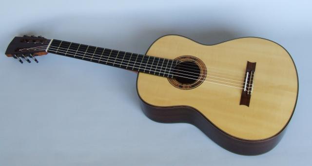

We only got a few shots of your guitars in the book so it good to see another one. Beautiful workmanship, and I love your materials list.
What shape is it? Look slightly classical but somehow not, a cross between a hauser and an L-00? Or is that the steel strings putting me off.

It's my "classical" classical shape (as opposed to my neo-classical shape).Dominic wrote:What shape is it?
Here's the same shape in more normal surroundings: And here's a fairly typical SS with some good ol' blokes playing: Nearly lost that guitar...but it was already sold (pre Lacey...those were the days...)Dominic wrote:We only got a few shots of your guitars in the book so it good to see another one.
Re: "The Shed" guitar
So its just a slightly wider lower bout? About 380mm? Its a really nice shape. Full and fruity without being too blobby, like your 25 year old girlfriend.

365mm lower bout.Dominic wrote:So its just a slightly wider lower bout? About 380mm?
How did you know I have a 25 yr old girl friend?Dominic wrote:Full and fruity without being too blobby, like your 25 year old girlfriend.

Trevor, whatever you've done with the outline it looks really nice and less angular than my Hausers.trevtheshed wrote:365mm lower bout.Dominic wrote:So its just a slightly wider lower bout? About 380mm?How did you know I have a 25 yr old girl friend?Dominic wrote:Full and fruity without being too blobby, like your 25 year old girlfriend.Healdsburg, 2009. That guitar was bought in the US by the second guy who heard it. The first played only flamenco.Dominic wrote:Are those pics from a GAL conference or something? How were your guitars received?Next time you're heading for Sydney, give me a call.Dominic wrote:I hope to get to hear some of your guitars some day.
Now on to bigger issues, the 'your' in 'like your 25 year old girlfriend' was a generic or global 'your' and not specific to you or any individual. So in this respect I am trying to conjure an image of the archetypal 25 year old girl, fruity without a hint of blobbiness or approaching cellulite. But I just realised there is another weak point in my analogy. The way society is going (sideways, outwards) these day its probably harder and harder to find an archetypal 25 year old that fits the specific point I was trying to make. I better clean out my old analogies.
