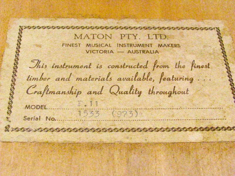

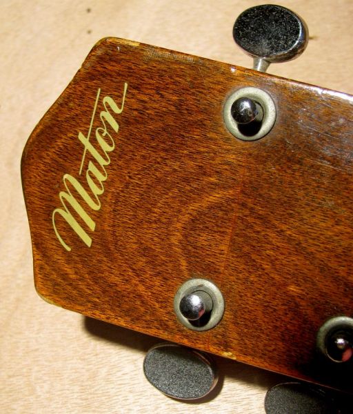

The Maker
The label
(Best available?) I suppose so just as long as you didn't go looking around too hard) as you can see the model is a Maton F11, which was an instrument marketed as a steel string folk guitar.
Between 1971 and 73, Maton released a total of 1665 of these most of which would probably have ended up in land fill by now. I say this because the F11 looks to be no more than a cheaply converted Maton F10 and these guitars with their 'heelless', 12 fret to the body neck and all 'acoustic' plywood construction, were Maton's cheapest student grade classical guitar at the time.

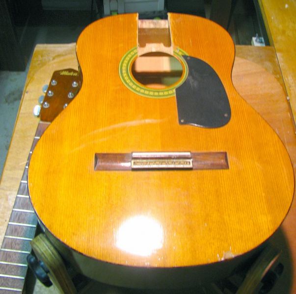

OK, on with the rebuild, this image shows all the bits and pieces together.

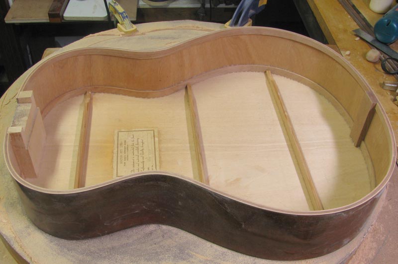

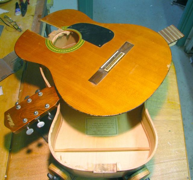

Here is the top, you can see the glob of epoxy at the bottom right and the nice green rosette transfer.
Interesting brace lay out :?

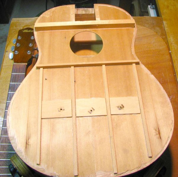

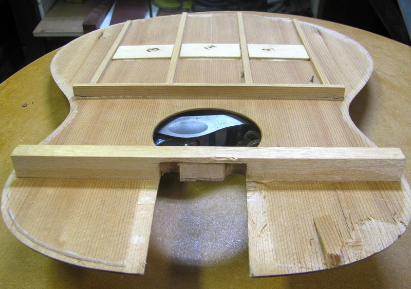

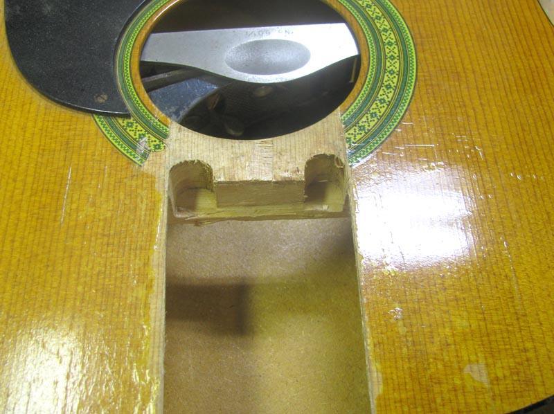

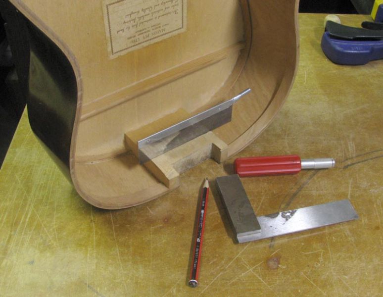

These next few images demonstrate why this guitar was never going to handle steel strings for very long. (Note the teeth marks in the neck!) The mortised block which accepts the neck tenon is glued to the back of the neck block.

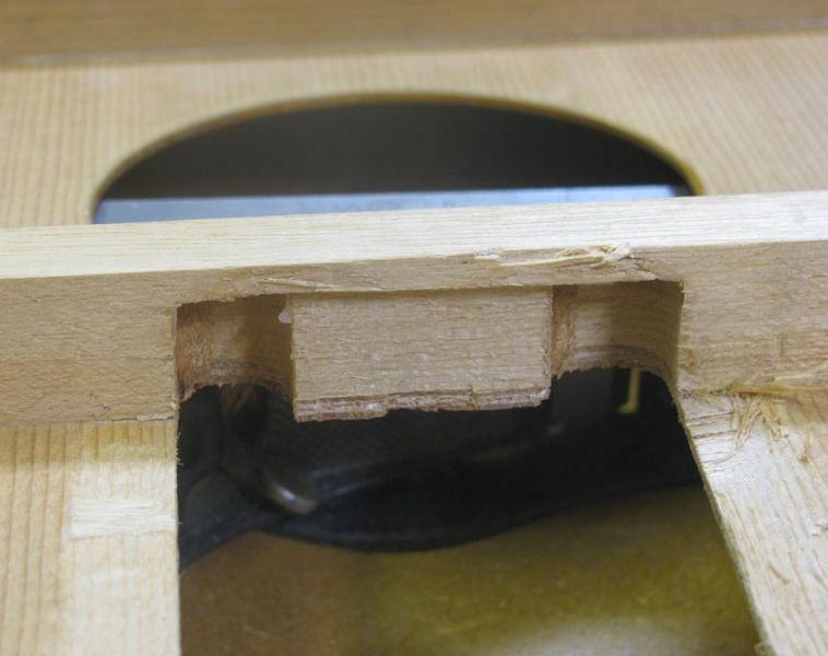

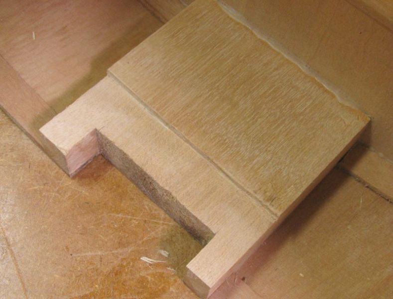

The idea is that the neck tenon will slide 'through' the neck block and mortised extension and into a second mortise cut in the hardwood (Durian) upper transverse brace.

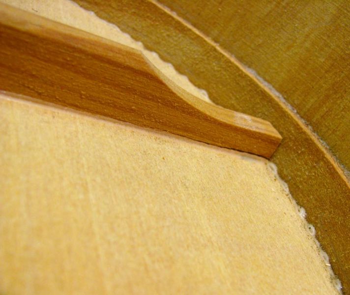

The underside of the top is first glued down onto thin solid linings and the upper edges of the mortised block to lock everything in place and then the neck tenon is glued in. The guitar is then ready for stringing up so that the whole lot can gradually rotate back into the guitar as a single unit to make it unplayable in no time. If this 'was' done at the factory, and I see no evidence to suggest otherwise, I do understand why the holes had been bored into the UTB. It was to allow for quick removal of material to form the mortise that will eventually accept the back of the neck tenon. I have no idea why the hole had to be so big as to render the UTB virtually pointless.
This next image shows the 'side' of the neck tenon

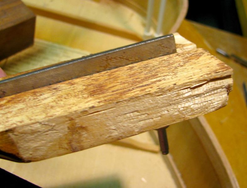

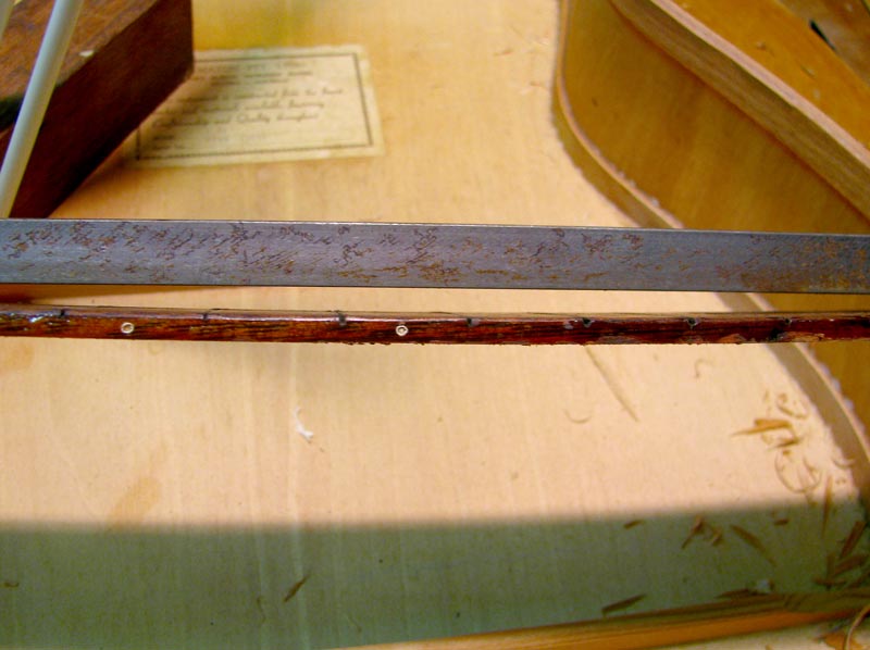

In keeping with the holes bored in the UTB, I found the alignment of the 1/2" flat bar used as a truss rod a little hard to explain, must have been a Monday guitar after a good bag on the weekend.

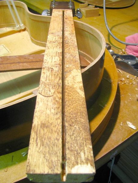

Here's an image of the fretboard after it was removed, not sure of the timber but I suspect it was from some tropical fruit tree :wink:

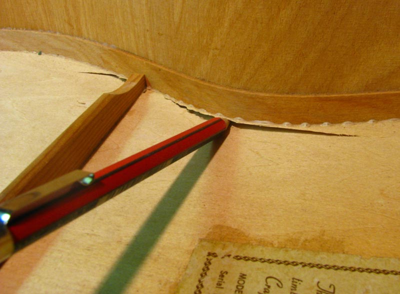

OK, here is a bit closer look at whats going on with the bracing, I am not concerned with the top as it will all be replaced with my own set out.
This is the upper ladder.

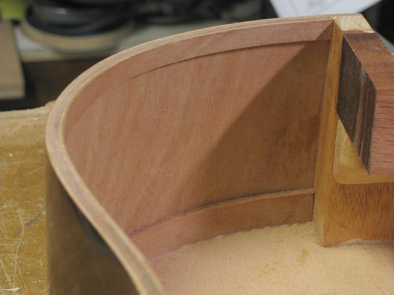

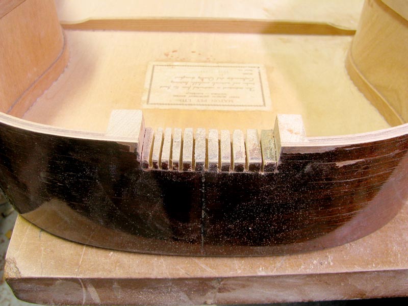

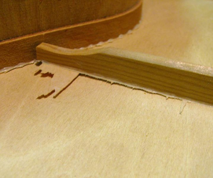

And here we have the waist where the ply has separated due to impact at some point in time.
And here the back and sides have separated at the waist, the thin solid linings used in this guitar left no room for a binding channel so the bindings are just painted on with black paint.
Aside from the small glue surface offered by these very thin solid linings not helping to prevent the impact damage we see above, the other problem of course is that they offer little support or stiffness to the sides and this in turn would do little to assist keeping things in shape when under string tension, this would need to be addressed if I wish to keep the neck heelless........
So the plan? Repair the damage to the original back braces and strengthen the sides by increasing the width of the solid linings to allow for bindings to be installed. Strengthen the neck block area to increase the structural integrity of the body to lend support to a planned composite UTB that will be fixed to the upper bout sides and form the main load bearer counteracting string tension. Repair the dog chewed neck and insert a 2 way adjustable truss rod. Couple the neck to a new neck block extension to allow the neck to be fitted via 2 allen bolts so, if ever required, the neck angle can be easily reset in the future without the need for major surgery. Fit a new Lutz spruce top with traditional ringed rosette along the lines of a 32 000 Martin and brace the top for a Martin 'short' scale 13 fret to the body configuration instead of the original 12 but with my own bracing patten. Rub back, bind, fill, re-stain and blend the entire guitar to the headstock and then completely refinish with nitro...... that should do it :D

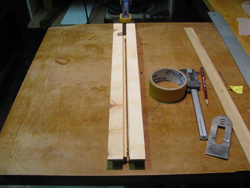

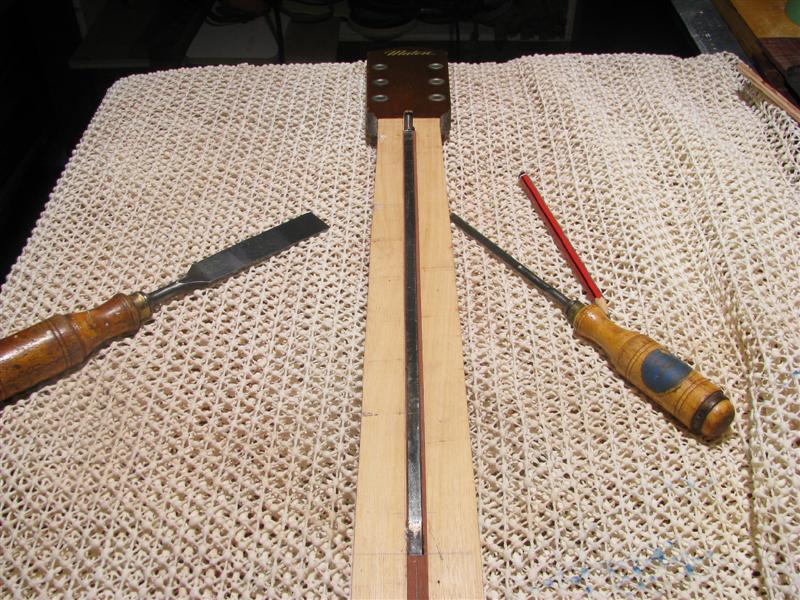

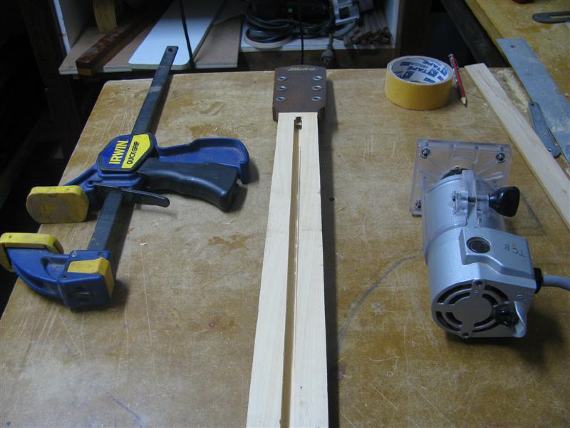

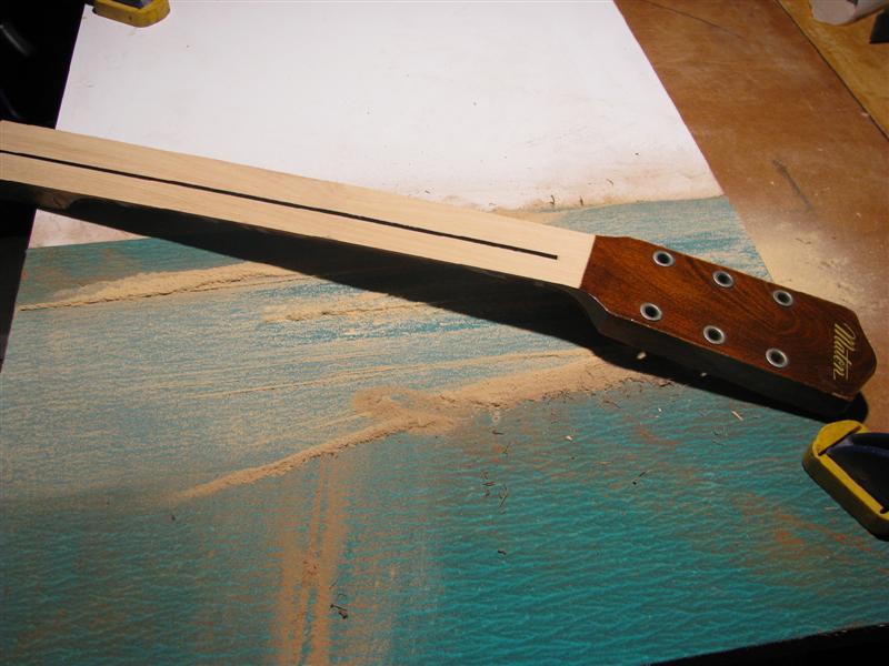

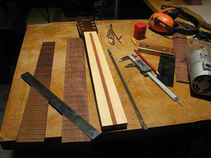

On to the some constructive stuff...First up the neck, as shown I have separated the fretboard from the neck and popped out the old 'nonadjustable' truss rod, which was a simple piece of flat bar on side, by drilling a hole in the underside of the neck tenon and using a pop rivet to push the flat bar out of its rebate. You can see the end of the pop rivet sticking out of the bottom of the tenon and the truss rod lifted, ready to be removed in one of the images above.
The fretboard surface of the neck was then cleaned up and flattened on a large sanding board.
Next the off centre slot would need to be re-cut wider, and deeper than original slot so that a fillet of hardwood, in this instance Jarrah as it is what I had laying around, could be glued in to reestablish the integrity of the neck.
I used some ply off-cuts to make a routing template. This was set up to allow for a template follower and fixed in place with double side tap and panel pins.
The slot was then cut with a lam trimmer and a 1/4" down cut spiral bit.
After ensuring a clean fit, the Jarrah fillet was glued into place. Here you can see the neck ready for the slot re-cut, the Allied 12 fretter truss rod ready for fitting and also the figured Western Myall (Acacia Sowdenii) fretboard already slotted to scale and ready to go. Beautiful wood that Western Myall but susceptible to worm so I have a few holes that need filling but worth the effort.
And here is the rod fitted in the neck shaft ready to go. The channel was cut using the same ply off cuts as before just readjusted to ensure a nice tight fit. The rod was then covered with a thin fillet of Jarrah and that part of the job was labeled complete. 8)
More tomorrow.... :D

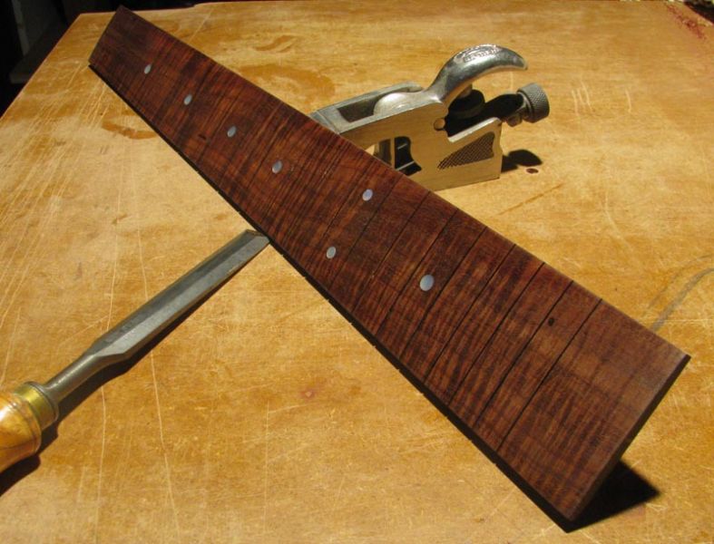

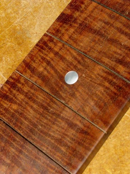

Anyhow, here is a bit more on that Western Myall fretboard.
This is the jig I built for cutting the radius, I rode motorcycles when younger, sometime on the road but mainly into cars and I have a manky wrist to prove it. So to help me get bar chords a little easier, I use a 12" radius. The strange thing is that most who play instruments I have set up like this comment how much they like the feel...
Here is the board after installing plain white MOP dots and a cleanup, you can see where I filled the worm holes if you look close but if I catch anyone looking 'that' close at the instrument when it's in their hand, they'll get a thick ear for their troubles. :wink:
Here's a closeup of the Myall, nice figure huh..
That's enough for today..stay tuned.

Beautiful fret board Kim. If you got a stack of that old wormy wood, I'd take it off your hands. :lol:

That Myall certainly is lovely wood - and a lot denser than Ebony.

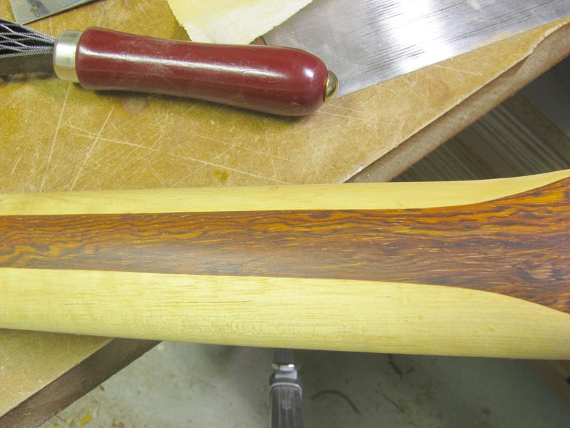

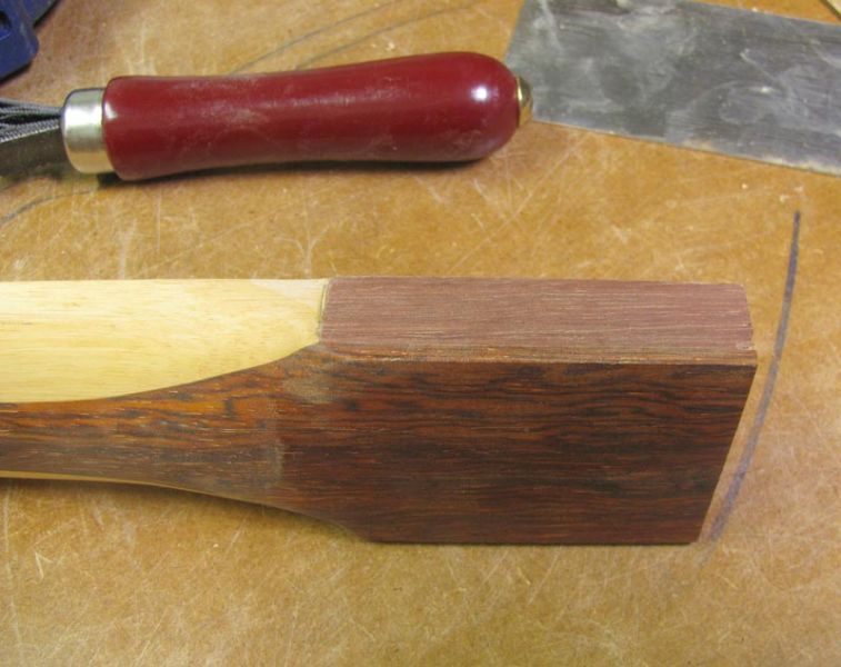

With the fretboard surface now clean and flat and the truss rod glued in to place and ready to go, it's time to look at fixing up the teeth marks in the back of the neck. These were deep and numerous with many crushed and broken fibers, must have been some wild gig that one. :P
I did not take any photos of the actual process because my hands were a little full at the time, but decided that it was always going to look a little shonky if I just filled them and finished over. So instead, I flipped the neck onto the fretboard surface, and ran the back of the shaft through the Proformax 16-32 thickness sander a few times winding up the drum and dragging the neck back out each time the headstock was about to enter the business end of the machine.
When the worst of the teeth marks had been ground away, I was left with a nice flat surface upon which to glue a back-strap which was fashioned from a nice, but porous piece of Cocobolo original picked up as an orphaned side from BobC. The original wood used in the neck of this guitar is Durian, (finest possible material you know :lol: ) its a very yellow/white colour wood that would obviously need to be stained in.

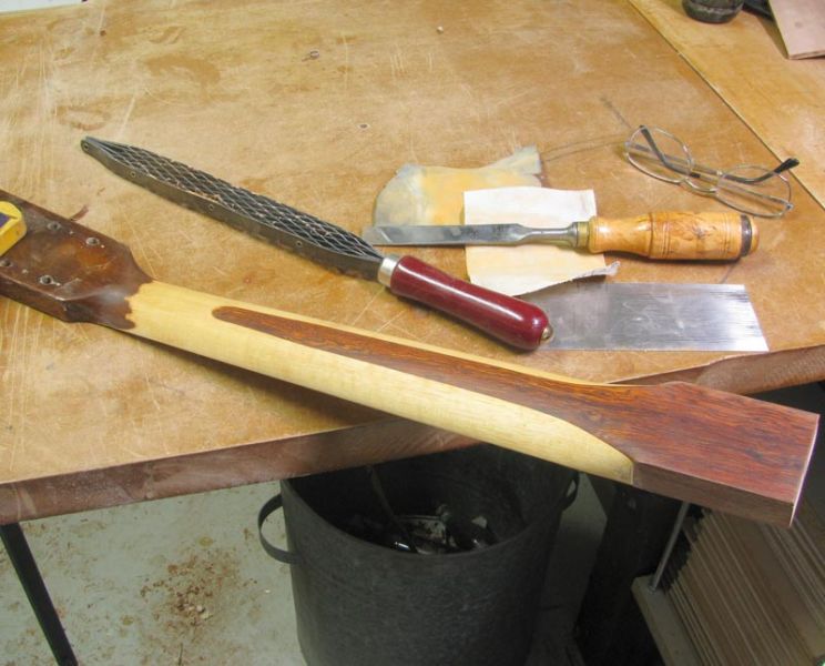

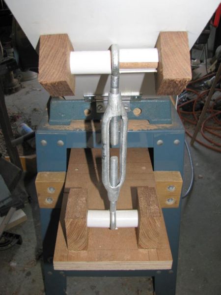

I chose Coco for the back strap because it's hard, will probably add a little needed stiffness to the neck shaft, certainly will provide a good mating surface when bolted to the neck block extension and it looks nice.
Here is what I ended up with after the back strap was rough shaped in.

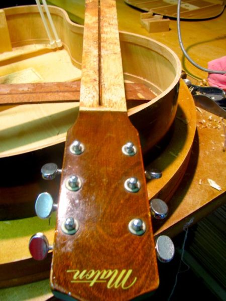

This next image of the side of the tenon shows how I overcome the problem of the neck block mortise having been cut off centre to the body,,,,told ya, it was a Monday guitar. When fitted at the factory in 1973, the neck had been mildly skew and biased toward the bass side of the guitar. I ended up having to add an even thicker veneer to put this right but this of course introduced a new problem which will be addressed later.
After the above image was taken, I also thinned out the back of the headstock a little. It had been disproportionately thick, so much so that the capstans of the machines did not have enough protrusion for my liking. I took the neck to my belt sander and used this jig to grind off a few mil and clean things up.

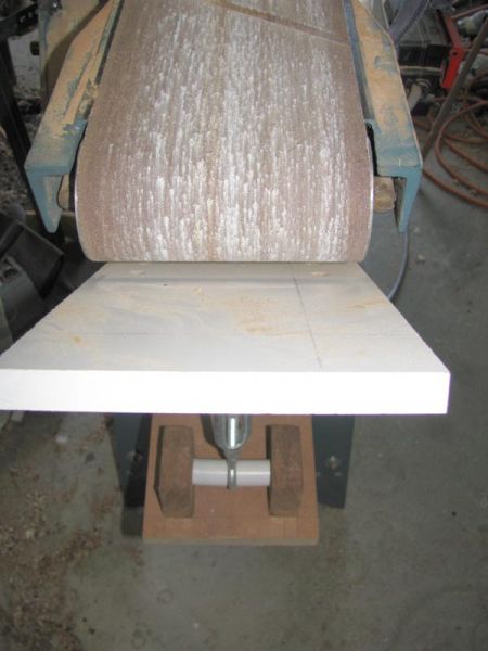

I think most of us with a static belt sander have version of this jig set up in the shop and they are all great. I made the height adjustment for mine using a spare turnbuckle I had laying around. It works well, adjustment is quick and easy, and the table does not tilt so you end up with a very flat and even surface when done.
With the back of the headstock now lightly thinned, it was just a matter of cleaning up the transition to the underside of the shaft by hand and the neck was complete less the gluing of the fretted board.

That backstrap looks great! And another item on my to do list, add a sanding shelf to my belt sander. That turnbuckle adjustment looks perfect.
Thanks for the ideas Kim,

Great repair on the neck Kim . The Cocobolo neck shaft back strap looks very cool !

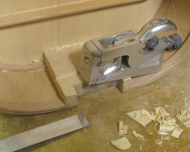

With the neck now a 'known factor' it was time to look at straightening out the body. The loose braces were re-glued and then, thinned-out hide glue was injected into the areas where separation had occurred in the ply. The severity of these patches of 'separation' was a concern. The images do not show the amount of separation that could be 'felt' with the fingers when compressed.
This repair would require a time consuming 'one area at a time' approach. First the back of the guitar was placed into a 25' radius dish for support and then the chosen work area was heated with a paint stripping gun set on low. Next a 'small' amount of hot water was 'carefully' injecting between the separated layers of ply. I emphasize the words 'small' and 'carefully' because this part of the operation had the very real potential to turn to shit.
Too much water and the layers in the separation would expand quickly and buckle uncontrollably. This would probably cause even more separation and make it all but impossible to clamp the damaged area back together. Too little water and it would not achieve the desired affect of allowing the thinned hide glue to wick deep into the affected area for a secure repair.
Anyhow, with this first operation complete it was immediately followed up by a second injection of thinned 'hot' hide glue that had been taken well over the recommended 140f. The area was then heated with the paint stripping gun again as the separation was clamped under a thick wooden caul shaped to fit the job and then heated in the micro wave to act as a kind of veneer iron. Once in place, the caul was loaded with as many gobars as would fit.
Squeeze out was then cleaned up with a wet stick and a hot damp cloth, and once properly set and allowed to dry out well, the work area was gently sanded with a pinch of 1973 dust gathered from the linings to blend it in with its surround.
I should have taken more images so I could show the process but found myself forgetting and just wanting to move on. Sorry to those would would have been interested :(
Anyhow the next step, now that I had some idea of the tenon I had to work with, was to address that shonky neck block.
The original mortise was cut skew, off centre, AND too low on the treble side so the fretboard would tilt down on the treble side when fitted into the mortise. When dissembling this guitar it was a 'REAL' challenge to get the neck out in one piece. In the process the glued on neck block extension had to be pried away from inside taking with it some of the wood from the actual neck block. So the first job here was to re-establish a suitable surface upon which to glue the new extension.
It was quite restricted working within the confines of the upper bout region, but with some adaption of the right tools, the job came off OK.
First step was to mark the block level and cut to the line with a razor saw using an engineers square as a fence.
Next the waste was pared away with a good sharp chisel and the rebate cleaned up with a trusty Record No77A. I love this plane and have found it indispensable for all sorts of stuff. The Record No 77 is much the same plane but the 77"A" has a removable nose piece via a single screw and location pins. This gives you the option of using the plane as a bullnose, removing the nose and using it as a chisel plane allowing you to clean up right in the tight spots, or to add and remove shims between the nose piece and body adjusting the throat to the task at hand, it's brilliant and very handy for work like this 8)
And here is the neck block ready to accept a new extension which is to be fashioned from tassi blackwood and epoxied into place. A 45 degree spruce glue block will also be added to securely mate the two components from beneath.
If your now looking at what 'appears' to be the intended depth of the neck block extension and wondering to yourself, why so thick? Its OK, this guitar 'was' a true flat top. I will be changing that and putting a 25' radius on the replacement top. By the time I grind down the rims in the radius dish to match the radius of the new top, a fair bit of height will be lost from the sides and the 'top' of neck block. I will then need to true up the horizontal plane of the mortise and accommodate the slightly thicker tenon created by the added cocobolo. To do this I will need to excavate a fair bit of material away from the base of the mortise.
Looking at the last image above and assuming that the neck block had been glued in the centre of the guitar at the factory, and it was, those of you with a keen eye would have noticed just how much 'off centre' the mortise had been cut....mmmmmmonday.

With the body now secure enough to withstand the rigors, it was time to cut away the worst of the waste from the neck and tail blocks throw her in the radius dish, and take her for a drive.
After a few laps around the block she was looking OK, the radius was cut just shy of the waist and the rough sawn surface of the neck and tail were cleaning up nicely.
So now was a good time to look at fitting the new neck block extension. I marked the neck block mortise close to depth and cut with a razor saw at the edges of the mortise, and between with a jap saw to assist in removal of the waste.
I must have forgotten to take images of the rest of the process but you can see in this next image it is now installed complete with supportive glue block. What is even more interesting about this shot though is how little of the lining is left after cutting the radius. This will certainly need to be sorted out.
