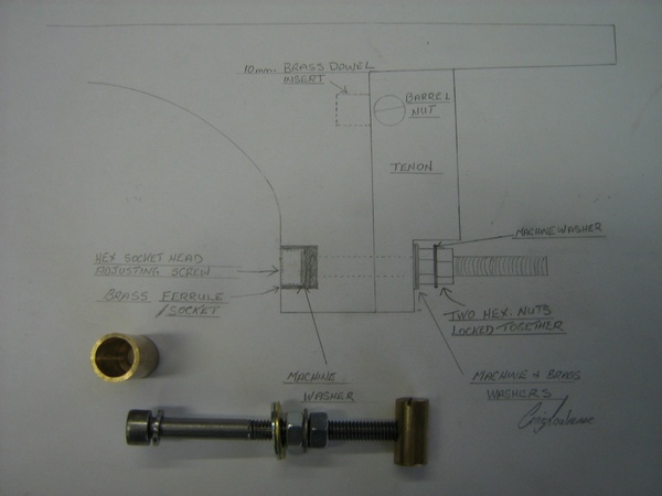

I've made some good progress ,and here are my new plans.
Bearfast had the socket head screws with 1 inch long type threads as expected. They had them in black steel and Stainless steel . I thought the black ones would be easier to run a die down , but not so ! . Turns out the black ones have a hardness of K 12 . , while the stainless are around K 6 or 7. That's good ,because I wanted the stainless ones anyway.
As you can see I've successfully ran the die ( with cutting oil ) to their required thread lengths. No probs. !
I have decided to leave out the nylon type slip washers and use brass washers instead.. Others may choose to use slip washers , I was afraid they would begin to compress and " squeeze out " , but I may be completley wrong here . This plan has the adjusting screw and washer bearing against the 4 mm thick base of the brass ferrule .
New to my design also is the brass ferrule for the adjusting screw. I see this piece as an important stuctural element . By using the 1/2 inch ferrule , it increases the bearing surface at the heel considerably. Not only by having a larger footprint , but because I'll epoxy it in , the walls of the ferrule/socket will share some of the load . The bearing surface area I was concerned about ( around the adjusting screw ) , I believe has now been rectified. It'll also look good which is another good thing :lol:
No such ferrules are available off the shelf ( as far as I know ), so I purchased some 1/2 " brass dowel to make my own .
The very best news is that , I can prepare all the hardware myself with out need for anyone to fabricate it for me . More on making the ferrule later : Questions ,comments, critique welcome.
More to come :
Cheers Craig Lawrence

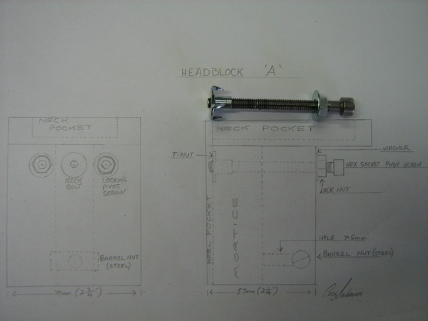

My plan of the headblock shows 6 mm. socket screws as the pivot adjusters which go into T-nuts . The T-nuts shown are in their store bought state , I'll be cutting off the barbs on them and fashion the flanges to suit the heel profile shape before installing them into the headblock. They have a good long thread capacty and take up little space. The pivot screws are locked in position via the locking nut and washer against the face of the headblock.
I really like the look of these !! :D :D

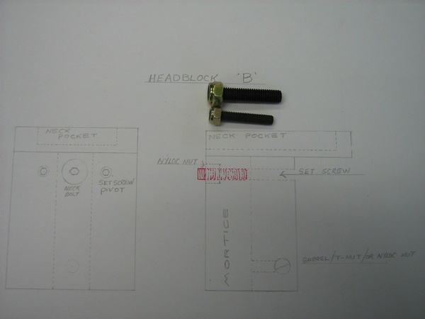

Here's an alternative idea for those wanting to use set screws. I have pictured 6 mm. and 8 mm. screws . The 8 mm. look great but may be a bit of a squeeze fitting the 8mm. nyloc nut in the headblock without going to a straight heel ( as opposed to a stilletto type ) This system is a tad lighter , but relies on the durability of the Nyloc . Not that I would expect these pivots to be adjusted much, if at all. Their threads aren't all that long either ,when you discount the room the nylon takes up. At this stage , I think I prefer Headblock A .

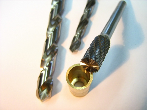

As I mentioned above, This whole system can be fabricated by the average luthier which was one of my intents. The brass ferrule / socket is some thing that a lathe might handle with ease , but not having a lathe I ued a drill press and drill press vise. I drilled a 13 /32 " ( 10.32 mm) hole in the 1/2 " brass dowel after first drilling a 15/64 ( 5.95 mm. ) hole for the screw shaft . This was difficult to get centered ,,, but can be done with a good drill press and vise . After drilling the big hole , I chucked a rotary burr I purchased especially for the job ( pictured ). I set the depth stop on my drill press for a couple of mm. deeper than the existing hole , and it left a perfectly flat bottom in the ferrule for the screw and washer to bear against .
I have left around a 3 to 4 mm. floor at the base of the ferrule.
Should look pretty groovy when the brass is rounded over and polished . I'll also polish the head of the stainless screw.
The ferrule pictured is basically a blank . I've left it way over length so I can trim it to the heel's outside profile later on and round the edges etc.

That's looking good and interesting so far. Very neat. Only one comment/question about the top pivots. On your first design, I'm not sure how the lock-nut functions - all of the pressure is pushing the bolt back into the soundhole so is this to stop vibrations loosening the bolt in the T-nut? If so maybe you need two lock nuts tightening against each other.
On your second design I'd be nervous about relying on the nyloc nut thread as the only failsafe against the backwards push from the neck/strings on the set screws. As I say, this part of the system needs to be rock solid in its "steady state".

Post by Craig » Sun Mar 16, 2008 8:37 am
Thanks Dave,
To explain headblock 'A' :
After final adjustment to the pivot screws , I then tighten the locknut and washer against the headblock face. This should lock the pivot screw tightly in position ( friction ). You may be correct in that two locking nuts may work better here , but my feeling is that a second one may not be required. The beauty of my designs are that all the hardware pieces ( except the ferrule and T-nuts) , can easily be undone /replaced , or added to, so adding a second nut wouldn't be a problem.
I'm with you on the Nyloc nuts for the pivots being a concern. I just don't seem to have enough faith in them. They may be O.K.,,,,,,, just a gut feeling, :roll: and so prefer the Headblock 'A' design.
Cheers Allen , Yes my first plan in the above post shows brass dowel plugs for the pivots to bear up against.
I have left around 20 mm. in depth for the extention. This includes a neck extension thickness of around 15 mm., which I feel should be thick enough as I'm carrying my carbon fibre rods the full length of the fretboard. The remaining 5 mm. is reserved for adjustable space and the floor of the pocket.
I should also point out that I have made the lower barrel nut ( in the headblock ) from steel rather than brass. Thought it may wear better for constant action adjustments. :D
Cheers, Craig Lawrence

Post by Craig » Sun Mar 16, 2008 1:26 pm
Dave,
I've rethank ( re-think in past tense :lol: ) the pivot lock nut once again .
I can explain it by giving the bottom locking hex nuts as an example. Instead of having a washer between them as they do , the top pivot locking situation has the headblock between them ( the T-Nut and the lock nut ). They would lock together in the same way . (friction )
I don't think I'd mind adding another two nuts ( extra 4 grams ), but this would make for some difficulty tightening them both against each other whilst holding the screw with an allen wrench. Remembering this is all done through the soundhole ! :? .
The one lock nut here would be quite manageable , but I've decided to now swap that nut for a Nyloc one . This nut isn't carrying any of the string tension ( the T-nuts are ) , but merely locking the thread from turning . Should there be any shrinkage in the headblock , I'm guessing the nyloc nut will hold the screw's position. Other views are welcome .
To save confusion here , as other countries may know these as another name,, Nyloc nuts are a metal threaded nut with an enclosed tight nylon washer at the end of the thread.
Cheers , Craig
Posts: 5259
Post by Allen » Sun Mar 16, 2008 6:31 pm
Craig, I'll say it again, I think you've got this thing "nutted out" :lol: . In fact, your idea with the brass insert for the cap head screw to sit it is so elegant I think that this is going to be going on the little terz guitar.
Damn your good with a drill press, I'd love to see what you would be capable of with a lathe.
