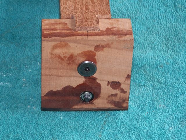

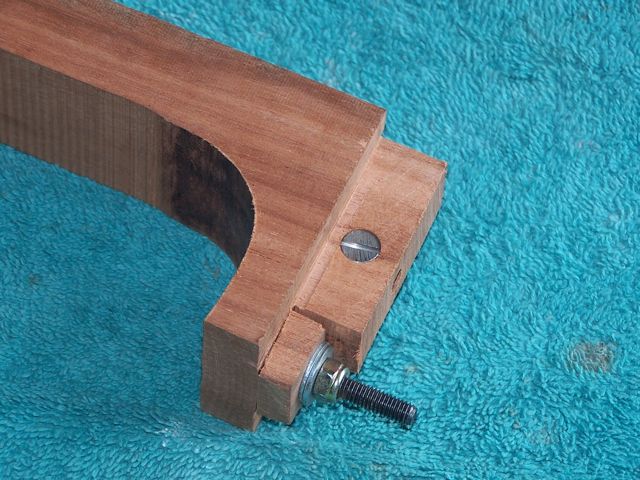

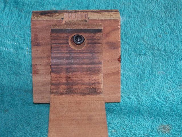

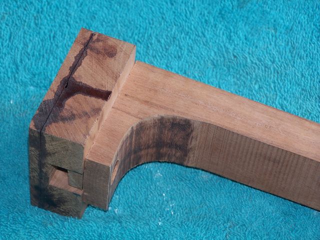

Well, the prototype was knocked up today. And while I didn't spend heaps of time on it, more to the point, it was something quick and nasty, just to test the concept.

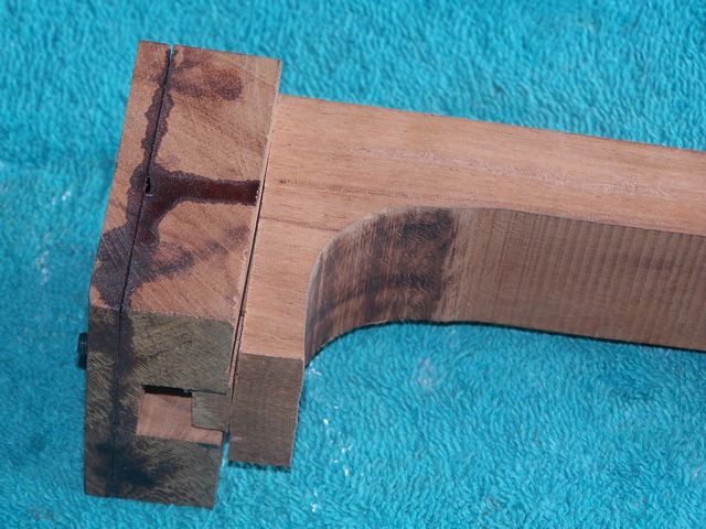

This shows the joint fully snugged up.

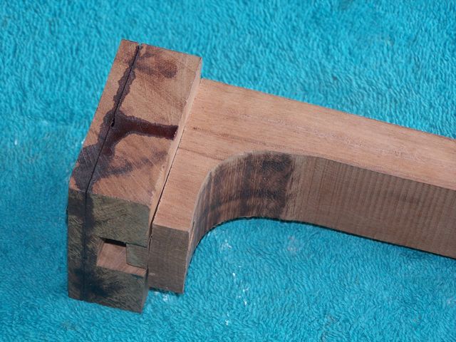

This shows the joint with 1/2 turn of the adjusting screw. I got this much adjustment without touching the upper bolt.
This is with 1 1/2 turns of the adjusting screw. I did have to let the upper bolt off by 1/4 turn to allow this much adjustment without it feeling like I was forcing things.
I've used a nyloc nut that has been epoxied in place.
The adjuster bolt is a cap head screw.
Standard barrel nut and the adjuster screw takes off on Craig's idea. Instead of using 2 nuts that lock each other, and potentially will come loose, I used another nyloc nut and a couple of steel washers to help give a bit of slip. I don't have any of those slippery plastic/nylon ones and I do think that they may be an improvement. I stuffed it up a bit by cutting off all the tenon and then realizing that the treads didn't go far enough up the screw to be able to thread the nyloc nut all the way on, so I had to use part of the off cut as a spacer. Not pretty, but it does the job.
My impressions are that it works brilliantly. In fact it quite surprised me. Rock solid and easy to adjust. There is a potential weak spot in the nyloc nut being epoxied into the neck block. If I could find one with a large integrated washer, this would give a much better surface area to glue in. I come across them now and then at work, and I'll be sure to keep them when I see some more.
I would still add the two set screws to adjust yaw, but the lower adjuster is so rigid (as long as the nut that is epoxied in the neck block stays put) that you don't need the lower set screw.
Also, I laid out the bolts to allow a 20 mm deep fret board extension. I just didn't cut the neck block for it as I didn't think that it would affect the results, and I was keen on getting this finished.
Only problem I can see with it, is that it pivots up near the top of the neck (under the fretboard that isn't there). This is going to have a big effect on intonation, you can see the gap opening up at the bottom of the joint as adjustments were made, well, you're getting about 1/2 to 3/4 of that movement at the 14th or 12th (whatever you have sitting above that joint). The frets are moving towards the bridge as the gap at the tip of the heel increases.
What's needed is a joint that pivots at the fret top . You could adjust the neck till the cows come home and it won't affect intonation - if you can come up with a joint that works like that.

OK, I see your point.
Now if the set screws are installed towards the top of the neck block, we can use these to adjust not only yaw, but also intonation as well...yes, no? We are however back to a point were if there is any drastic change needed in neck set, the strings are going to have to be slackened off to get your hand inside.
That shot of 1 1/2 turns was rather drastic. Just to show how much you could get out of the system. I don't think that you would need that much adjustment in real world conditions. I don't know how much you would need, and how much that would affect the intonation.
I would see this system as one that does a small tweak rather easily, and without actually building an instrument with it, I have no idea how it will work in the real world. Bigger minds than mine may be able to shed some more light.

Allen,
That's bloody fantastic !. I can't begin to tell you how much I appreciate the effort you have put in here Allen. Thanks also for the pics etc.
If you had installed the top pivot set screws in place ( in line with the barrel bolt ), I'm sure the neck would pivot even more , without having to touch the top barrel screw. Even so , it appears to be able to move the neck's angle quite considerably. Especially when we are only talking a fraction of a millimeter type of adjustment required in most instances.
Did you find the heel/neck to move in a nice parrallel manor when being adjusted ? I'm sure the locking nuts or nyloc nut thing can be worked out.
Yes , my plan shows cutting only enough off the tenon to acccommodate the locking nut/s. I figure the more wood left there the better , and it still gives a full length tenon this way.
I'm absolutley wrapped in your findings Allen. A question ; How do you feel about the durability of Nyloc nuts ?. They would be easy enough to remove with a very hot thread , when they are embedded in epoxy , but I'm probably thinking of the worse scenario.

I drilled the holes so that everything was a pretty snug fit. The tenon is also reasonable snug. You could get a few degrees of yaw with the fit I have. It was just a bit of a guess.
Other than the neck pivoting, I didn't see any other movement in the system.
Nyloc nuts are pretty durable, but will loose some of their grab after repeated use. The one used as a lock nut next to the tenon would last ages. It's not having threads turned in and out of it. The one that is epoxied in the neck block is the one that potentially will wear out. But saying that, adjustments are only going to be in the region of 1 full turn max. And this isn't going to be happening all that often. This should last a very long time. It might not even require a nyloc nut for this system to work. I just used it as a safety measure to stop the adjuster from being able to back itself off.
Now that I think about it. The nyloc nut that snugs up next to the tenon puts enough tension on the adjuster that it's not going to be all that easy to move on its own. You could use a barrel nut in the neck block as well if you wanted to and get similar results.

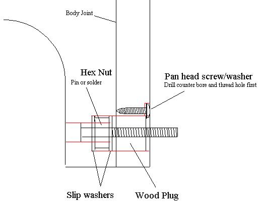

Here's one more idea to consider.
This takes the pressure off of the small allen head of the bolt, which
I believe would wear quickly.
This drawing is not to scale just a concept. I have tried to keep it simple
and clean looking. There is no reason a pair of nuts could not be used
in place of the pinned or soldered nut I show in my design.
I hope this helps!
Tom

Hi Dom, Yep , I'm sure that would work , but you'd have to have this long adjusting rod with you and be peering through the soundhole getting it lined up on the bolt etc. Sounds like a bit of a hassle .
A quick tweak with an allen key seems a lot easier. I believe an allen head socket screw will handle the job just fine
Cheers , Craig

Allen , I'm concerned the Nyloc nut at the end of the tenon may move when turning the adjustment screw . What ,I'm trying to say is that because it is snugged up against the end of the tenon , that friction may grab the nyloc nut to undo it . I hope that made sense. I realise my slippery washers would lesson that possibility , but feel that the two locking nuts, as per my plan, may provide more insurance this doesn't occur.
What do ya reckon ?

This whole thing was assembled and disassembled a few times and the nyloc didn't move at all. As I said, the slippery washers I think would help, and if you got to the point of being worried about things moving, I suppose you could brush on some loctite then thread the nut down to where you wanted and be done with it.

Sorry Tom you are quite correct. I overlooked that.
I think that little pan head screw will be working hard , and it seems dangerously close to the edge of your plug hole. Two pan head screws, ( one either side of your plug hole would be better).
The thing is Tom , I don't think the adjusting screw's allen head (as per my plan ) will have problems with any wearing issues . It has a washer and slip washer between it and the wood surface of the heel. In any case , should there be any slack develop in that area ( and I'm sure there would be after initially bedding in ), That slack is so easily taken out via the two locking hex nuts. This keeps the system simple , strong and reliable without resorting to plugs , panheadscrews and a little plate to push the plug against your pinned or soldered nut. I'm hoping I'm understanding this correctly.
Simple ideas are usually the best ones , and they suit my simple mind
Cheers, Craig
Cheers, Craig
Dave, there certainly is the potential for the nyloc nut on the adjuster screw to want to back off once it is under pressure from string pull. I really have no idea how adding 160 lbs. of pull against the joint will affect its adjustability.
As I said, this could possibly be rectified with a bit of loctite. I would see this as the weak link here. As for stripping threads, I suppose its possible, but I think that the nut backing off, or washers wearing out or the head of the cap screw wearing into the heel, are the most probable places were a failure will occur.
You could also use a plain nut and use a bit of solder to lock it in place, but then if using a nylon slip washer, you run the risk of getting things too hot and melting the washer.
